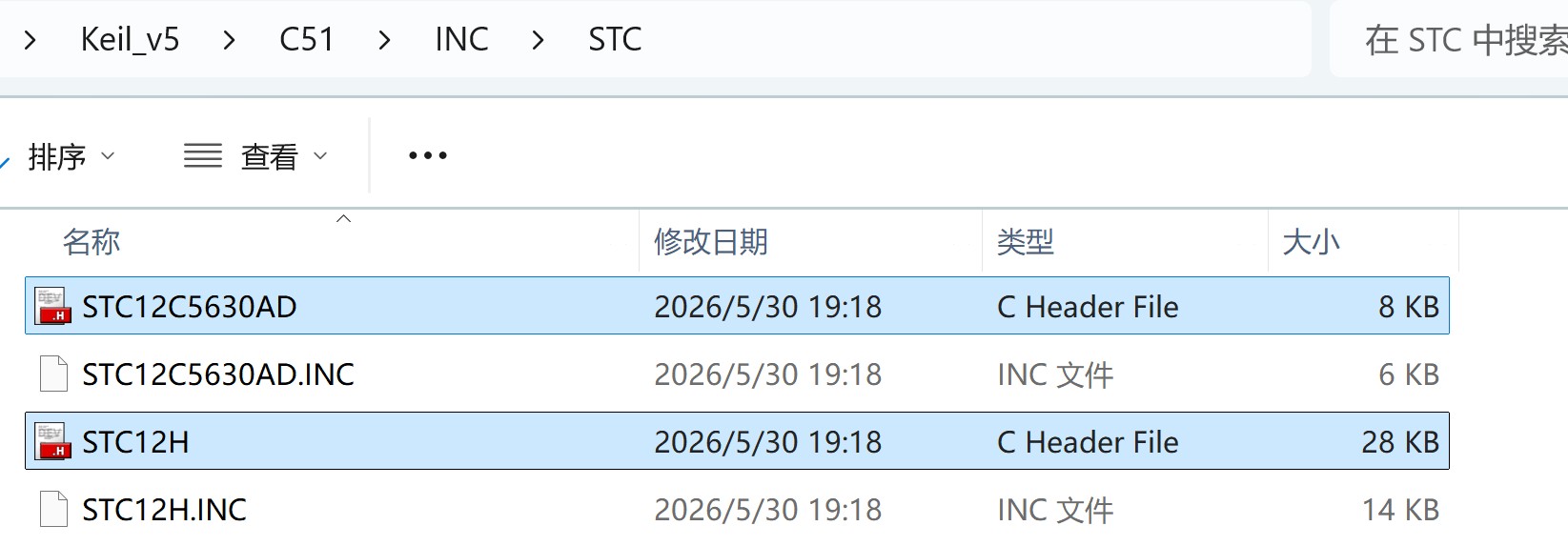

rajeshk*** 发表于 2026-5-30 17:57
//#include     no found
in datasheet RSTCFG sfr information in data sheet not found
STC12C56**  use  STC12C5630AD.h

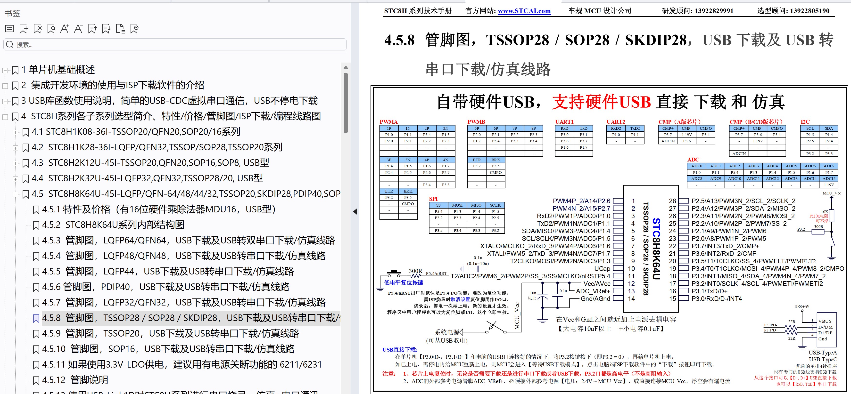

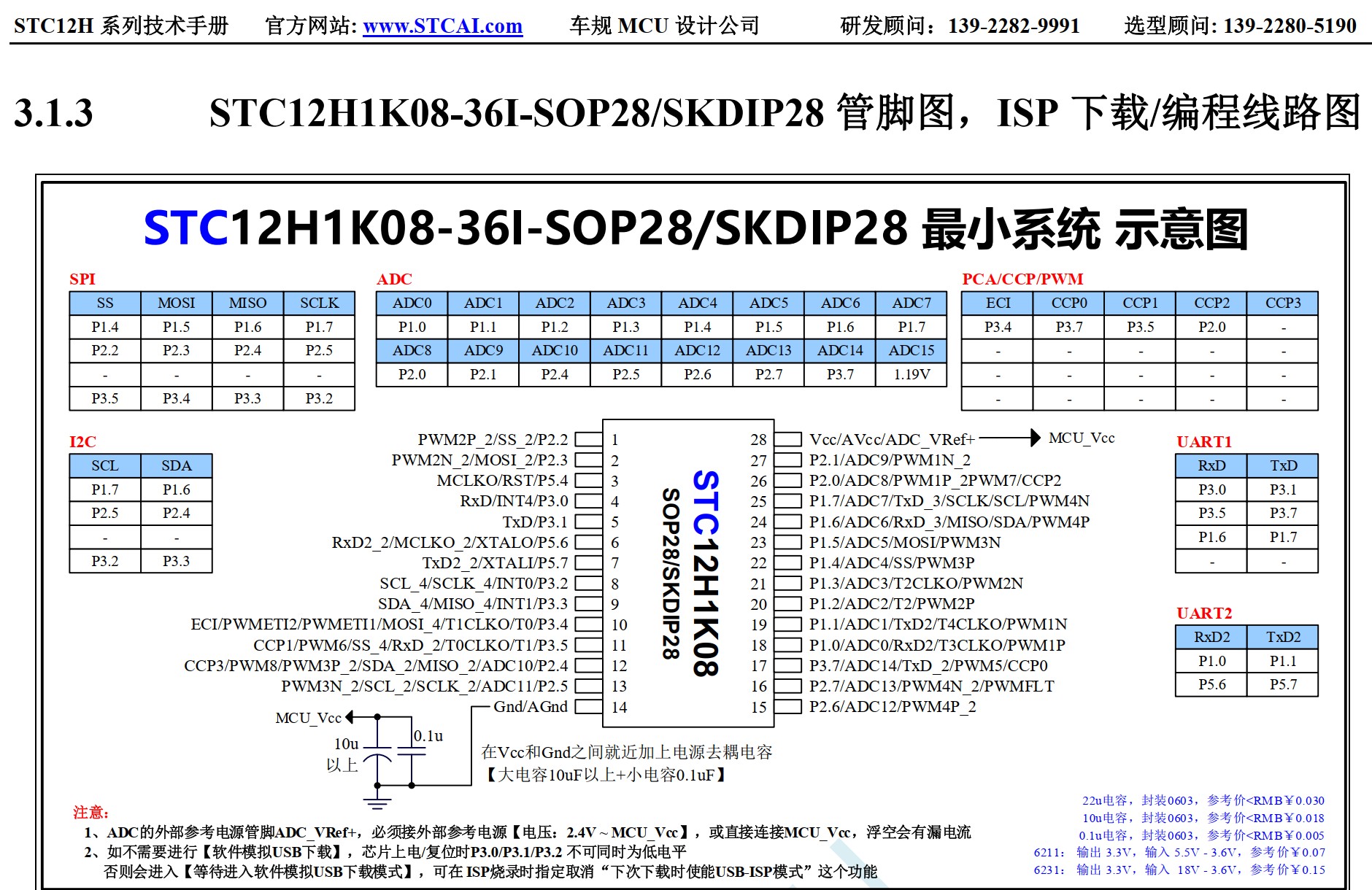

STC12H1K28-SKDIP28, LQFP32, TSSOP20
https://www.stcaimcu.com/data/download/Datasheet/STC12H.pdf

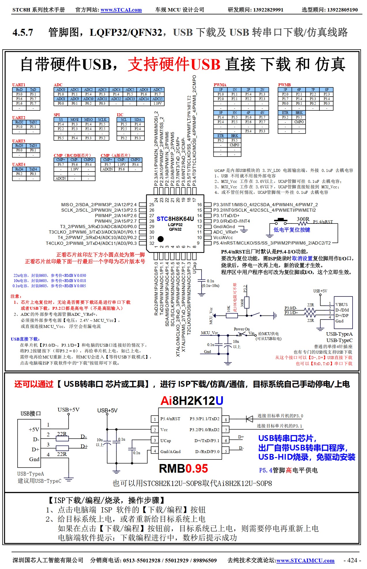

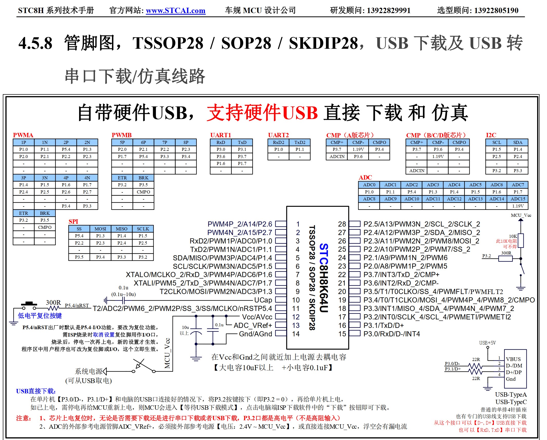

STC8H8K64U-SKDIP28, LQFP32, LQFP48, LQFP64, TSSOP20
https://www.stcaimcu.com/data/download/Datasheet/STC8H.pdf

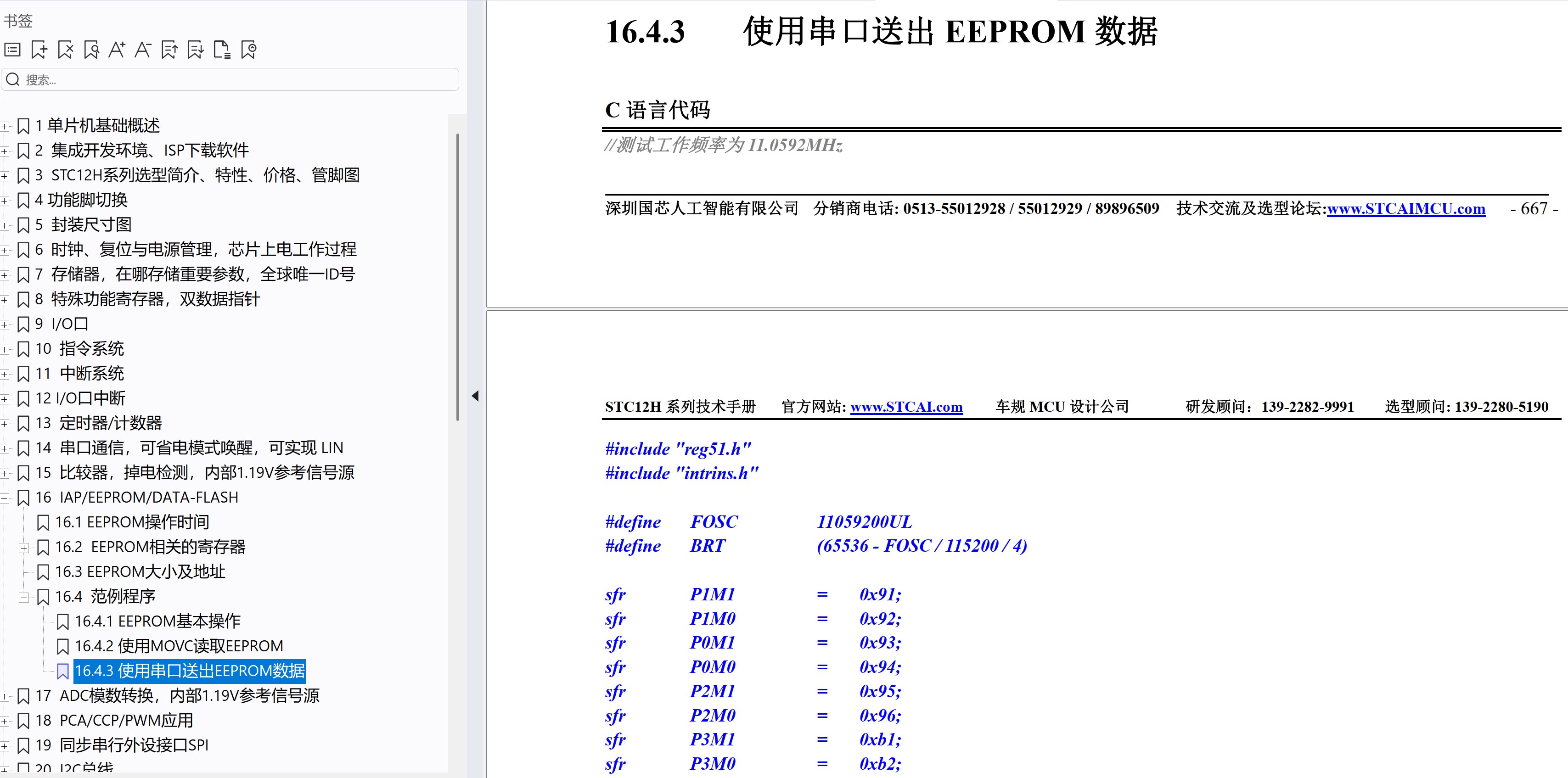

Hi Sir,
     need sample code for Stc12h1k28 .
thank you
