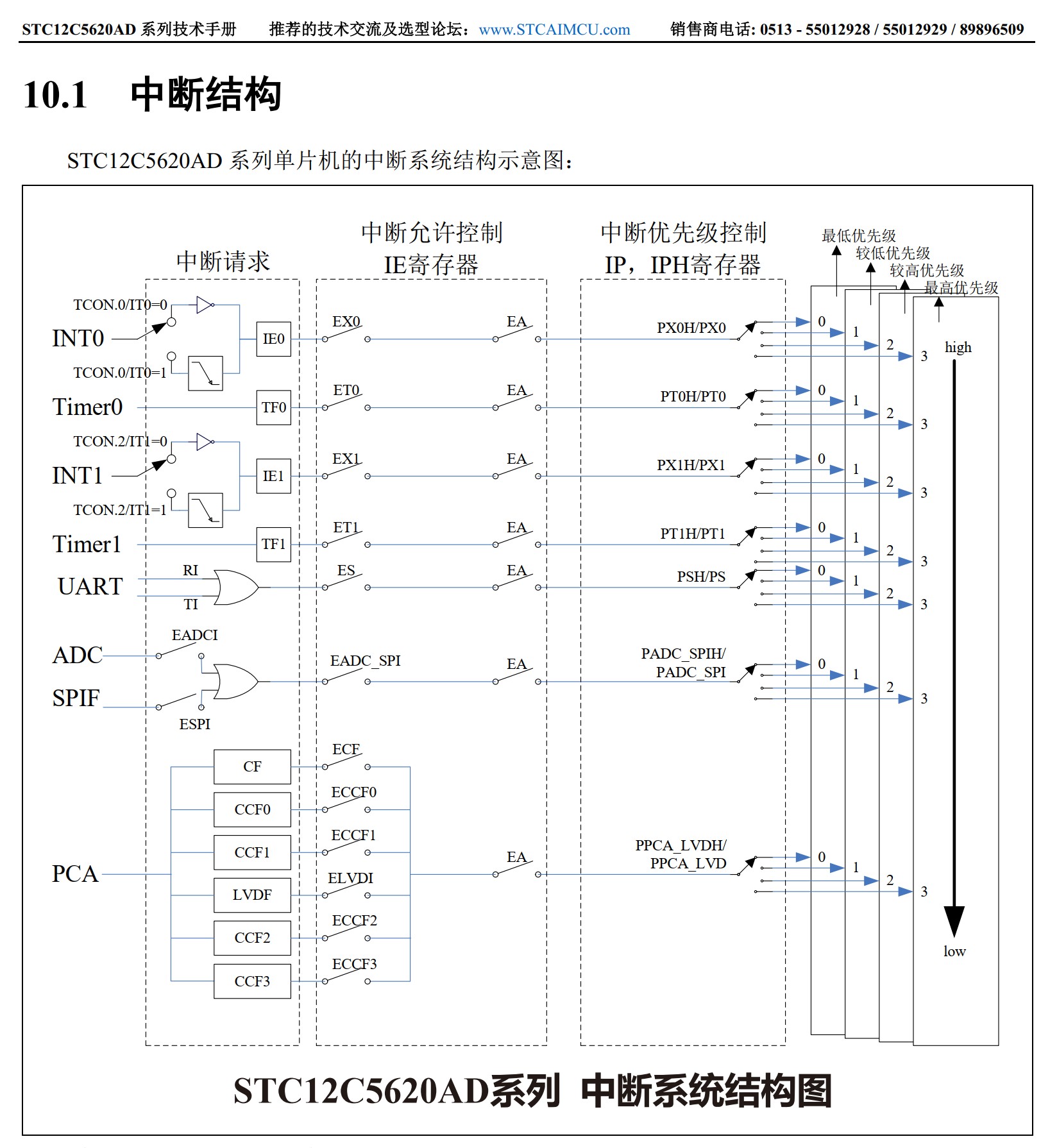

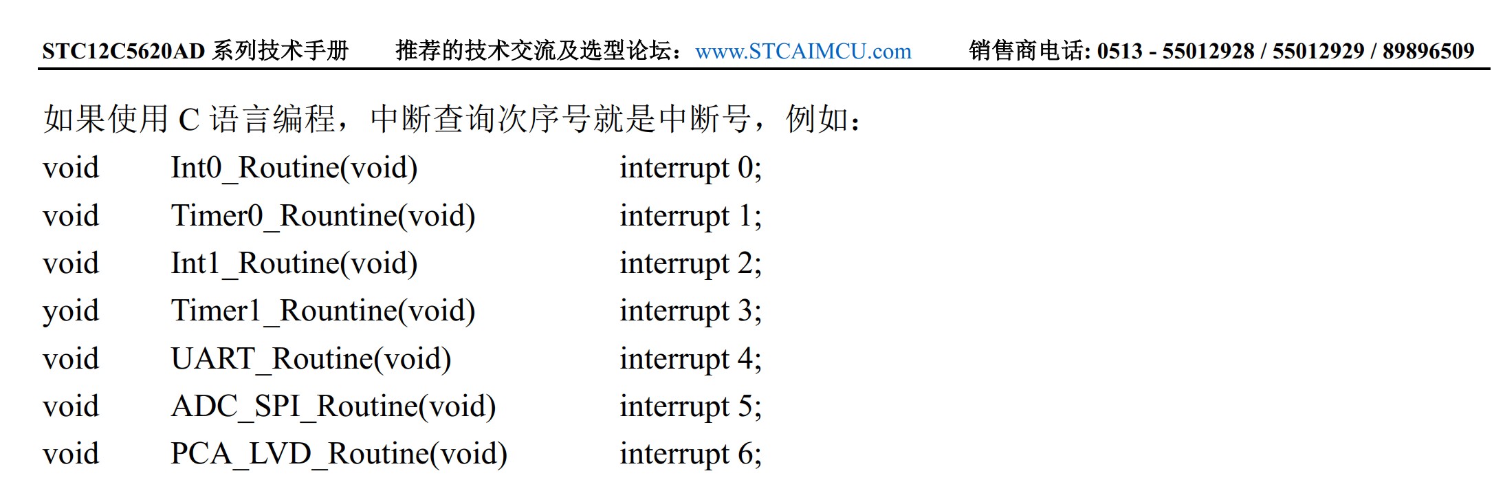

发表于 2026-5-30 16:38:10 | 显示全部楼层
直接回答(英文,可直接发给印度客户)
No, there is no issue. The STC56 series (STC12C56xx) fully supports LVD (Low Voltage Detection) interrupt. This feature has NOT been removed or eliminated.
  • The LVD interrupt is present as Interrupt 6 (vector address 0033H).
  • It can be configured to generate an interrupt (recommended) or a reset when VCC drops below the selected threshold.
  • 5V models: LVD threshold options 3.3V / 3.7V
  • 3V models (LE): LVD threshold options 2.0V / 2.4V
Why you didn’t find the demo
  • The official demo code package for STC12C56xx does not include a separate LVD interrupt example, but the hardware and registers are fully supported.
  • You can use the STC12C5Axx LVD demo (same interrupt logic) as a reference.
我方回复全文翻译
该功能完全正常,STC56 系列(STC12C56xx)完整支持低压检测中断,并未删减
  • 低压检测中断对应6 号中断,中断入口地址为0033H。
  • 可设置为:电压低于阈值时触发中断(推荐用法),或是直接触发复位。
  • 5V 版本单片机:低压阈值可选 3.3V / 3.7V;
    3V 低功耗(LE)版本:低压阈值可选 2.0V / 2.4V。
没找到对应示例的原因
STC12C56xx 官方例程包并未单独提供低压检测中断 Demo,但硬件和相关寄存器均完好可用。你可以参考 STC12C5Axx 系列的低压检测例程,二者逻辑一致。
配套可用代码说明
附上可直接运行的 STC12C56xx 低压检测中断代码:
(代码功能:电压触发低压检测时,翻转外接 LED 状态,可自行补充低压保护逻辑)
关键寄存器说明
  • ELVD (IE.6):低压检测中断使能位
  • LVDF (PCON.5):低压检测标志位(中断服务函数内必须手动清零)
  • RSTCFG:用于配置低压阈值、选择触发中断还是复位
总结
该功能百分百可用,并非芯片阉割。只是官方例程未单独收录,你完全可以放心使用这款单片机来实现低压检测中断功能。

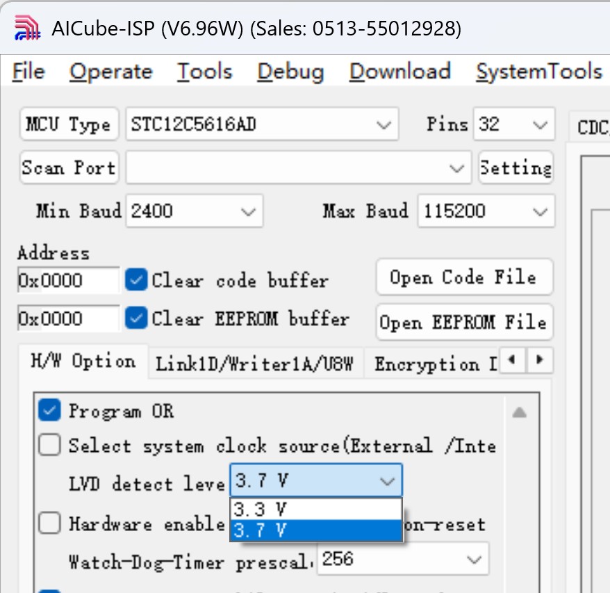

发表于 2026-5-30 16:38:58 | 显示全部楼层
How to use LVD Interrupt In STC12C5616AD serise
The LVD interrupt of STC12C5616AD cannot be used normally. Because STC-ISP tool enables Low Voltage Reset (LVR) by default, which locks the chip to work in LVR mode and disables the LVD interrupt fun  详情 回复 发表于 2026-5-30 16:55

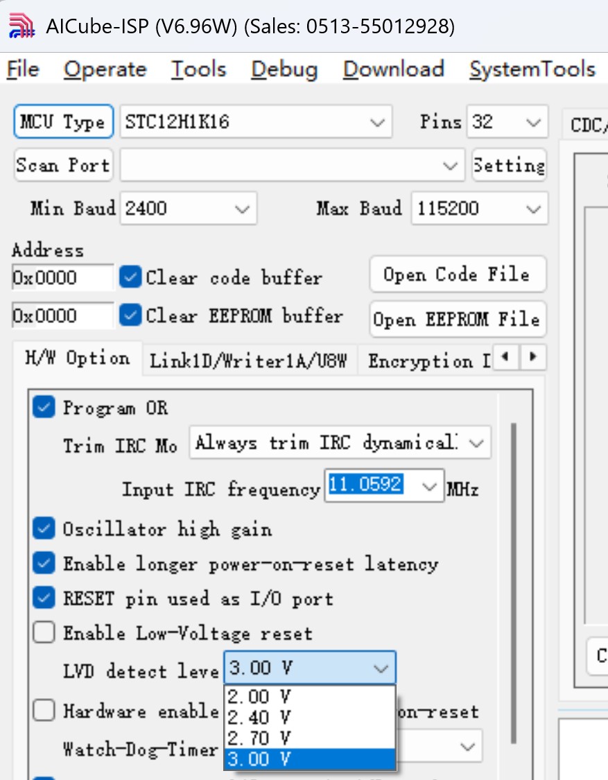

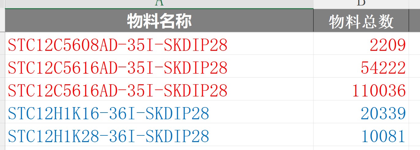

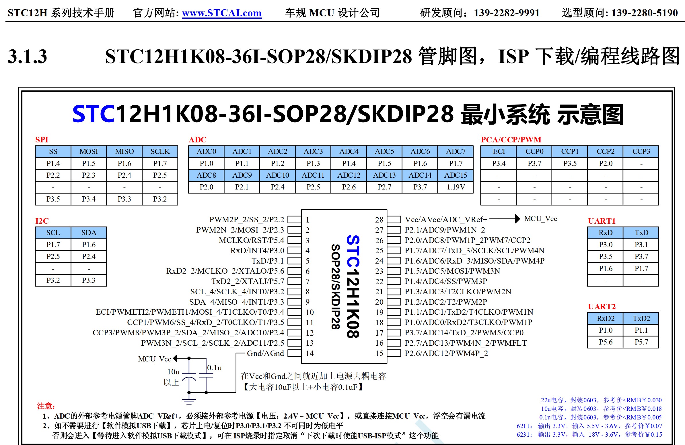

STC12C5616AD-35I-SKDIP28,
这个地方 LVD默认是复位,就无法产生中断。
建议改成 STC12H1K16-36I-SKDIP28
https://www.stcaimcu.com/data/download/Datasheet/STC12H.pdf
For STC12C5608AD-35I-SKDIP28, the factory default LVD action is reset, not interrupt. So by default, you cannot get an LVD interrupt.
  • The MCU does support LVD interrupt, but you must disable “LVD reset” in STC‑ISP during programming to enable the interrupt function.
  • Most users miss this setting and think the part has no LVD interrupt.
Recommended replacement: STC12H1K16‑36I‑SKDIP28
  • Pin‑to‑pin compatible with STC12C5608AD, direct replacement, no PCB change needed.
  • LVD interrupt can be easily enabled (no need to turn off reset in ISP).
  • It is an upgraded version of STC12C56xx, with more resources and better performance。

发表于 2026-5-30 16:55:51 | 显示全部楼层
rajeshk*** 发表于 2026-5-30 16:38
How to use LVD Interrupt In STC56 serise
which locks the chip to work in LVR mode and disables the LVD interrupt function.

发表于 2026-5-30 17:45:41 | 显示全部楼层
神*** 发表于 2026-5-30 16:38
直接回答(英文,可直接发给印度客户)
No, there is no issue. The STC56 series (STC12C56xx) fully supp ...

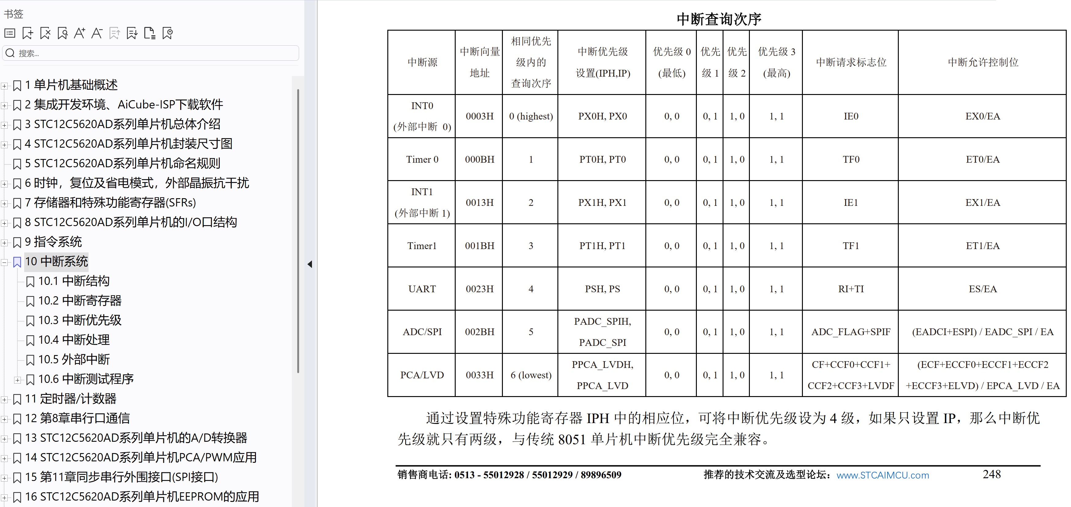

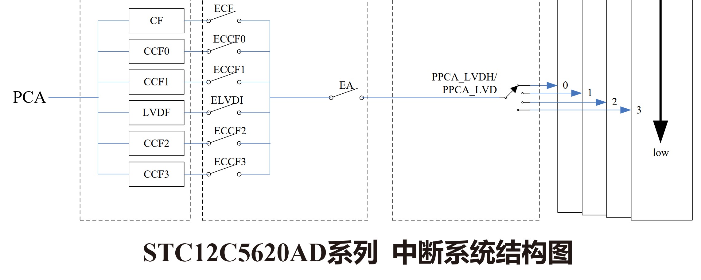

工具里面的头文件里面是找不到RSTCFG的
下载界面里面也没有可以设置位中断的选项,是通过哪个寄存器吗?
