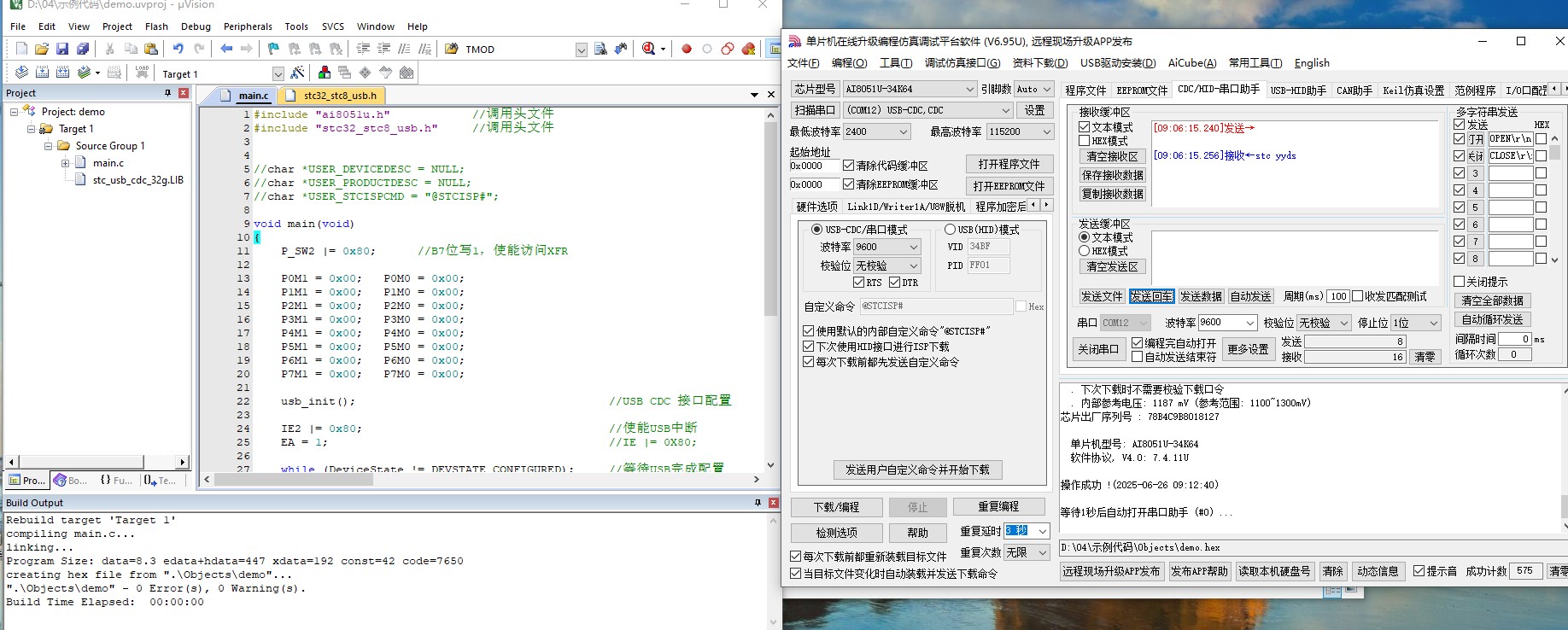

第4集USB不停电下载
代码运行通过,功能实现:
源代码如下:
#include "ai8051u.h"                        //调用头文件
#include "stc32_stc8_usb.h"                //调用头文件
//char *USER_DEVICEDESC = NULL;
//char *USER_PRODUCTDESC = NULL;
//char *USER_STCISPCMD = "@STCISP#";
void main(void)
    P_SW2 |= 0x80;                //B7位写1,使能访问XFR
    P0M1 = 0x00;   P0M0 = 0x00;
    P1M1 = 0x00;   P1M0 = 0x00;
    P2M1 = 0x00;   P2M0 = 0x00;
    P3M1 = 0x00;   P3M0 = 0x00;
    P4M1 = 0x00;   P4M0 = 0x00;
    P5M1 = 0x00;   P5M0 = 0x00;
    P6M1 = 0x00;   P6M0 = 0x00;
    P7M1 = 0x00;   P7M0 = 0x00;
        usb_init();                                     //USB CDC 接口配置
    IE2 |= 0x80;                                    //使能USB中断
    EA = 1;                                                                                        //IE |= 0X80;
        while (DeviceState != DEVSTATE_CONFIGURED);     //等待USB完成配置
        while(1)
        if (bUsbOutReady)
            USB_SendData(UsbOutBuffer,OutNumber);   //发送数据缓冲区,长度(接收数据原样返回, 用于测试)
            usb_OUT_done();
                P40 = 0;        //P40端口输出0V
                P00 = 0;        //P00端口输出0V
                P02 = 0;        //P02端口输出0V
                //P01 = 0;        //P01端口输出0V
第4集USB不停电下载.zip

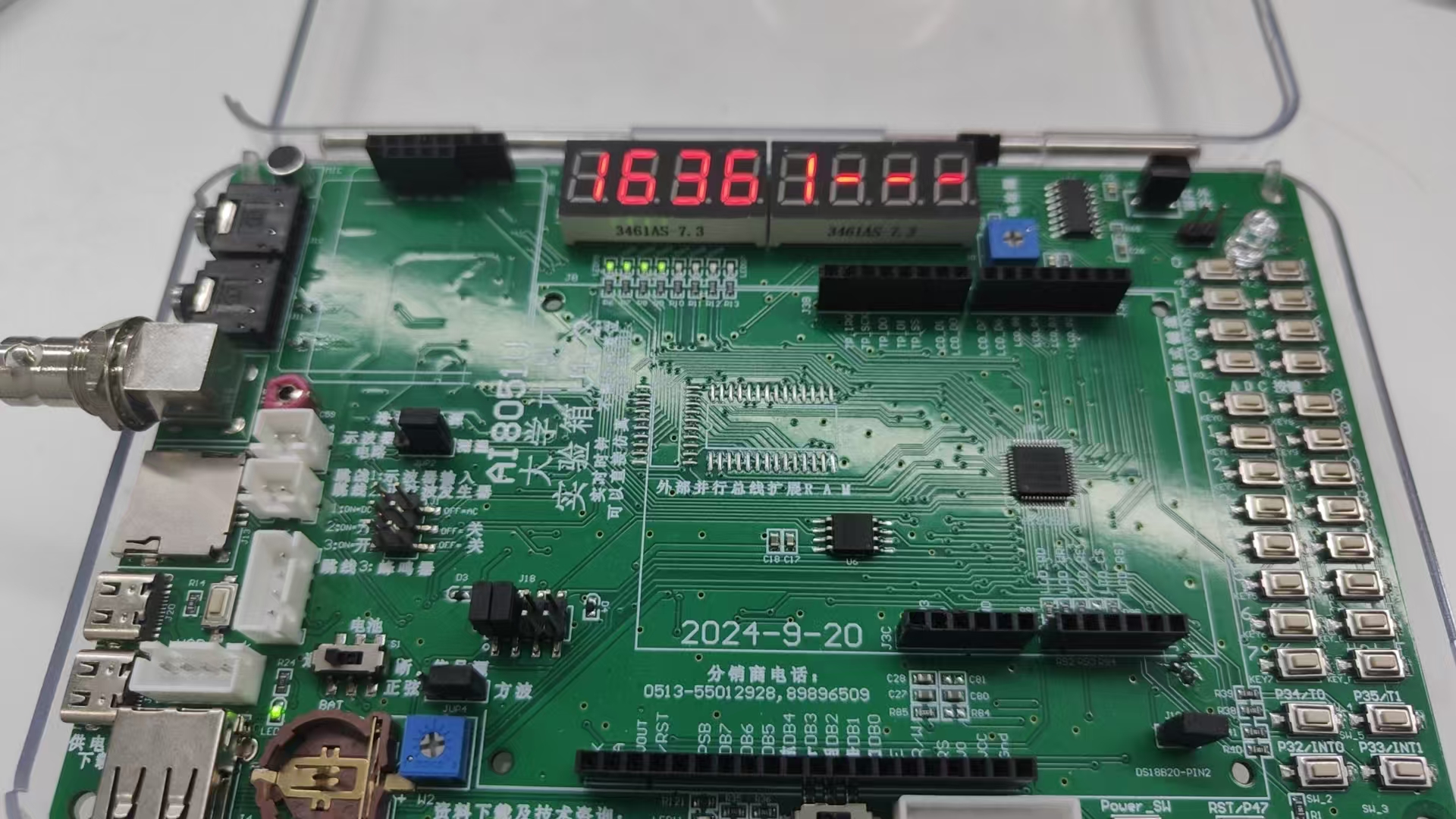

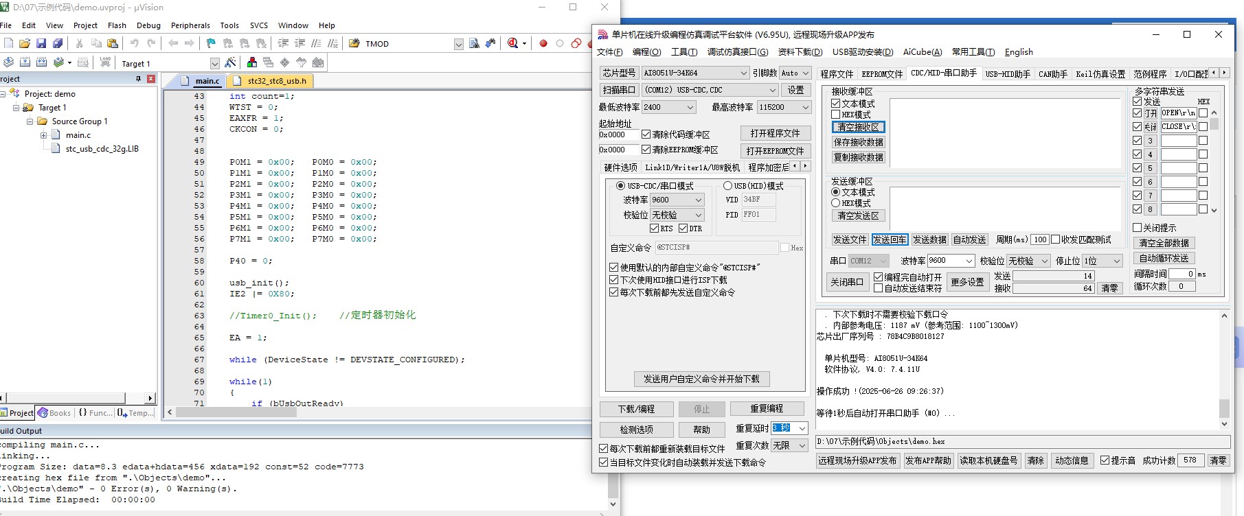

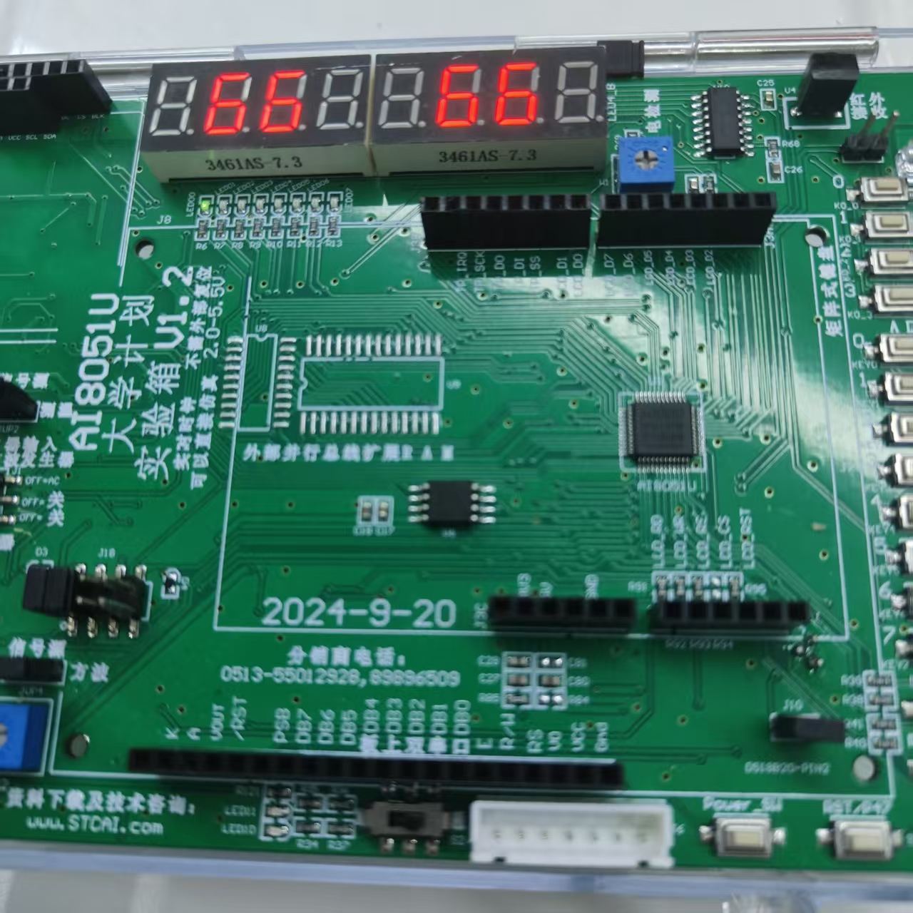

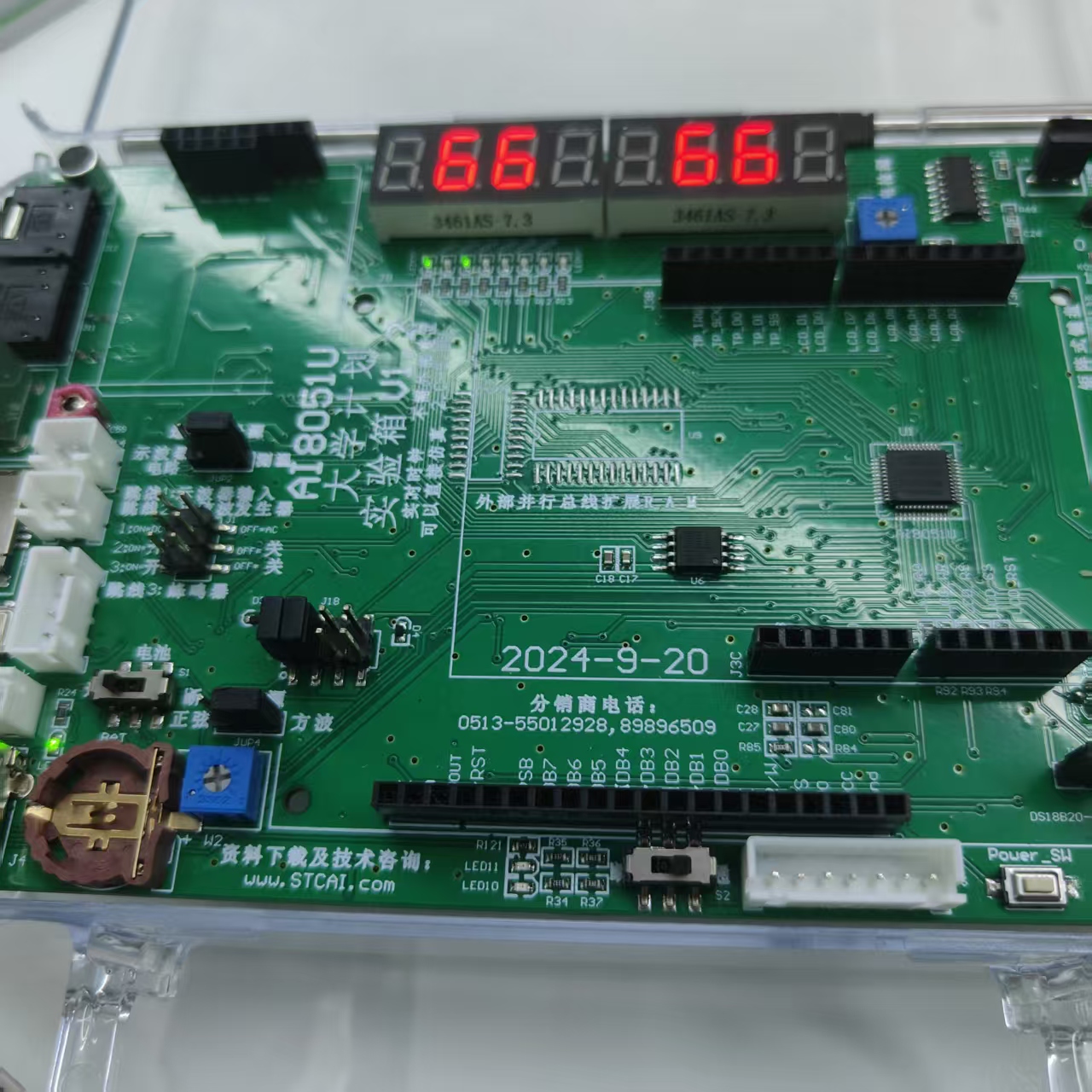

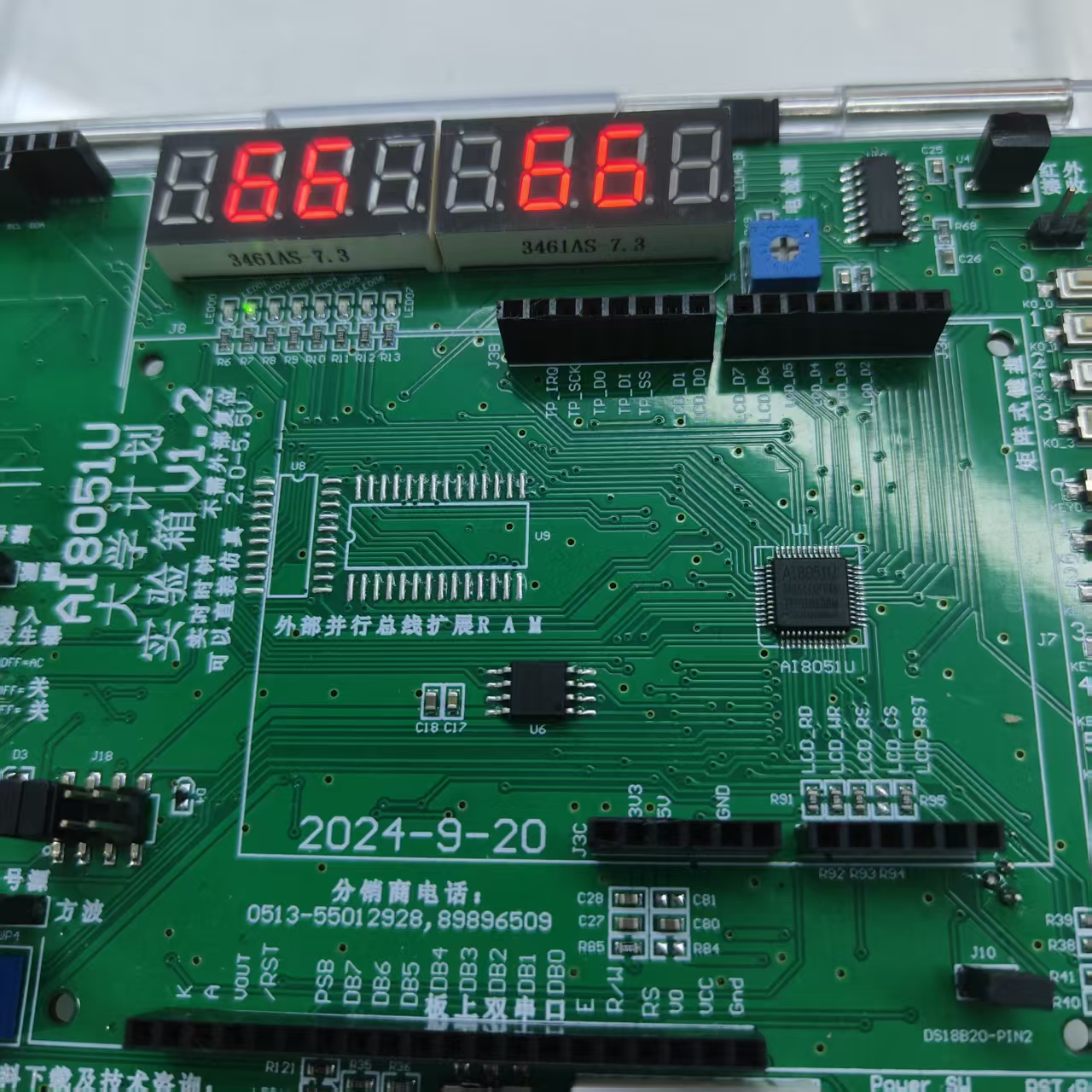

发表于 2025-6-26 10:05:19 | 显示全部楼层
第十集虚拟键盘LED和数码管

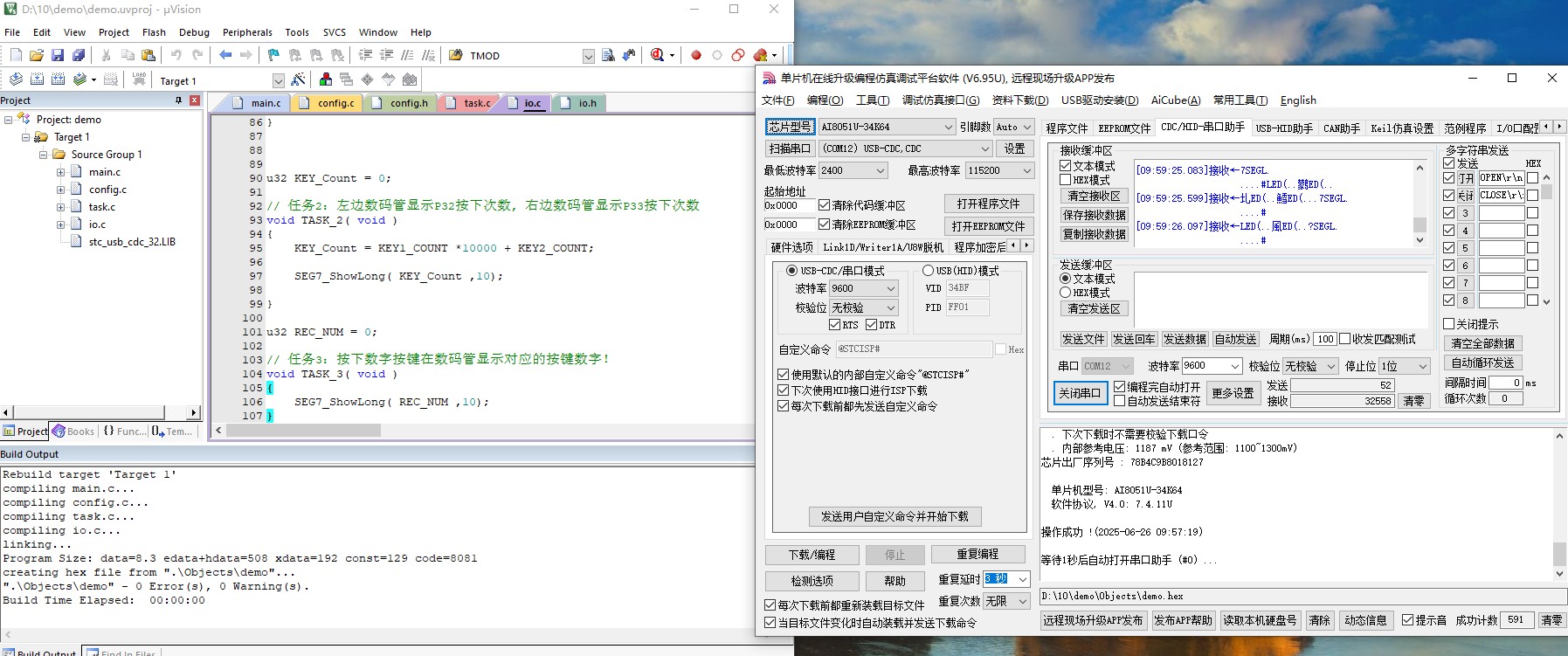

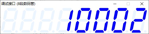

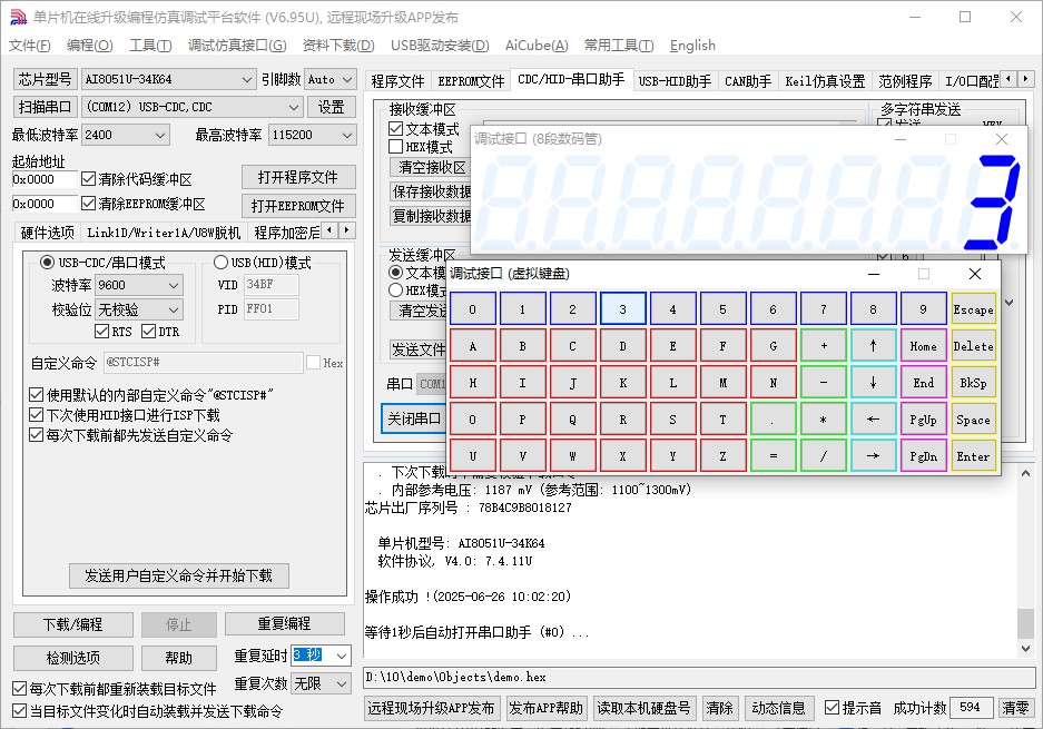

代码成功运行,功能实现:
源代码:
#include "config.h"
#include "task.h"
#include "io.h"
extern u32 REC_NUM;
void main(void)
        Sys_init();                                                                                //系统初始化
