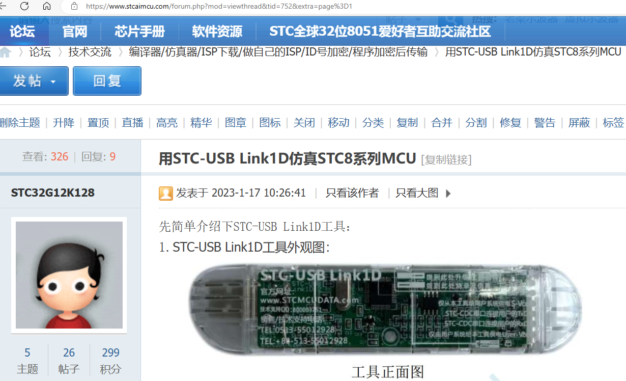

STC8A8K64D4可以用【仿真器STC-USB Link1D】来仿真,我们免费+包邮送您
===你用仿真来查下你程序漏洞在哪,或硬件哪不正常
https://www.stcaimcu.com/forum.php?mod=viewthread&tid=752&extra=page%3D1
