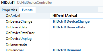

用Delphi的同学可以用JvHidController控件可以开发,相对比较简单
  1. procedure TForm1.HIDctrl1DeviceData(HidDev: TJvHidDevice; ReportID: Byte;
  2.   const Data: Pointer; Size: Word);
  3. var
  4.   rcv_data :array of Byte;
  5.   rcv_str:string;
  6. begin
  7.     SetLength(rcv_data,Size+2);
  8.     SetLength(rcv_str,Size+2);
  9.    if (HidDev.Attributes.VendorID = USB_VID) and (HidDev.Attributes.ProductID = USB_PID) then
  10.     begin
  11.         mmo1.Lines.Add(Format('收到数据.【%s ; %s】', [HidDev.ProductName, HidDev.SerialNumber]));
  12.         move(Data^,pchar(@rcv_data[1])^,Size);
  13.         move(Data^,pchar(@rcv_str[1])^,Size);
  14.         mmo1.Lines.Add(StrToHexStr(rcv_str));
  15.     end;
  16. end;
  1. procedure TForm1.btn1Click(Sender: TObject);
  2. var
  3.   I: Integer;
  4.   Written: Cardinal;
  5.   ToWrite: Cardinal;
  6.   Str: string;
  7.   Err: DWORD;
  8.   Send:TReport;
  9. begin
  10.   if Assigned(a) then
  11.   begin
  12.     Send.ReportID := $00;
  13.     Send.Data[0]:= $00;
  14.     Send.Data[1]:= $CC;
  15.     ToWrite := a.Caps.OutputReportByteLength;
  16.     if not a.WriteFile(Send, ToWrite, ToWrite) then
  17.     begin
  18.       mmo1.Lines.Add('发送失败');
  19.     end
  20.   end;
  21. end;
  1. procedure TForm1.HIDctrl1Arrival(HidDev: TJvHidDevice);
  2. begin
  3.     if HidDev.ProductName='STC USB Device' then
  4.     begin
  5.         mmo1.Lines.Add(Format('设备连接成功.【%s ; %s】', [HidDev.ProductName, HidDev.SerialNumber]));
  6.         mmo1.Lines.Add(Format('VID:%.4x/PID:%.4x', [HidDev.Attributes.VendorID,HidDev.Attributes.ProductID]));
  7.         USB_VID:=HidDev.Attributes.VendorID;
  8.         USB_PID:=HidDev.Attributes.ProductID;
  9.         a := HidDev;
  10.     end;
  11. end;
  1. procedure TForm1.HIDctrl1Removal(HidDev: TJvHidDevice);
  2. begin
  3.     if (HidDev.Attributes.VendorID = USB_VID) and (HidDev.Attributes.ProductID = USB_PID) then
  4.     begin
  5.         if (Assigned(a)) and (not a.IsPluggedIn) then
  6.         begin
  7.             HIDctrl1.CheckIn(a);
  8.         end;
  9.         a := nil;
  10.         //DeviceEnabled;
  11.        mmo1.Lines.Add('设备已移除');
  12.     end;
  13. end;
