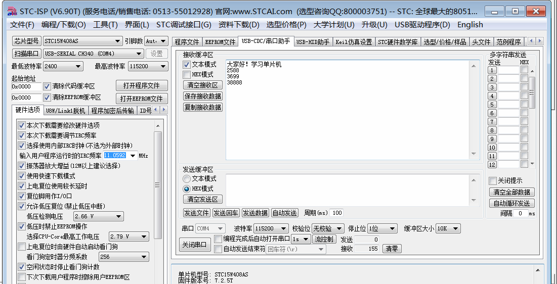

在测试单片机的时候,经常用到最小系统来,但是最小系统没有显示部分,增加了测试的困难,我们可以用printf()函数借助串口助手窗口显示数据,非常方便。如图:

程序如下:
#include "reg51.h"
#include "intrins.h"
#include <stdio.h>
#define FOSC        11059200UL
#define BRT         (65536 - FOSC / 115200 / 4)  // 115200波特率
sfr     P0M1    =   0x93;
sfr     P0M0    =   0x94;
sfr     P1M1    =   0x91;
sfr     P1M0    =   0x92;
sfr     P2M1    =   0x95;
sfr     P2M0    =   0x96;
sfr     P3M1    =   0xb1;
sfr     P3M0    =   0xb2;
sfr     P4M1    =   0xb3;
sfr     P4M0    =   0xb4;
sfr     P5M1    =   0xc9;
sfr     P5M0    =   0xca;
sfr     AUXR    =   0x8e;
sfr     T2H     =   0xd6;
sfr     T2L     =   0xd7;
void UartInit()
     SCON = 0x5a;
     T2L = BRT;
     T2H = BRT >> 8;
     AUXR = 0x15;
void main()
     P0M0 = 0x00;
     P0M1 = 0x00;
     P1M0 = 0x00;
     P1M1 = 0x00;
     P2M0 = 0x00;
     P2M1 = 0x00;
     P3M0 = 0x00;
     P3M1 = 0x00;
     P4M0 = 0x00;
     P4M1 = 0x00;
     P5M0 = 0x00;
     P5M1 = 0x00;
     UartInit();
   while (1)
     unsigned int a=2588;
     unsigned int b=3699;
     unsigned int c=38888;
       TI = 1;
      printf("大家好!学习单片机\n");
   printf("%u\n",a);
   printf("%u\n",b);
   printf("%u\n",c);
        TI = 0;
   while (1);

  此程序15w408as,8g1k08(16),8h1k08测试通过。

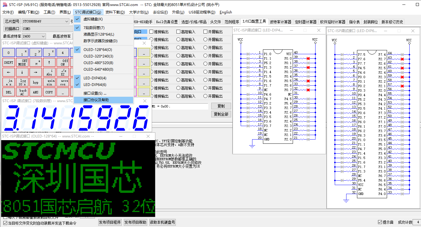

好建议,现在还有强大的 调试接口 帮助大家,虚拟键盘,虚拟显示

再加上串口接收模块,键值解释模块,利用虚拟键盘,就可以上位机与下位机互动调试程序了。很美,很强大。:D
