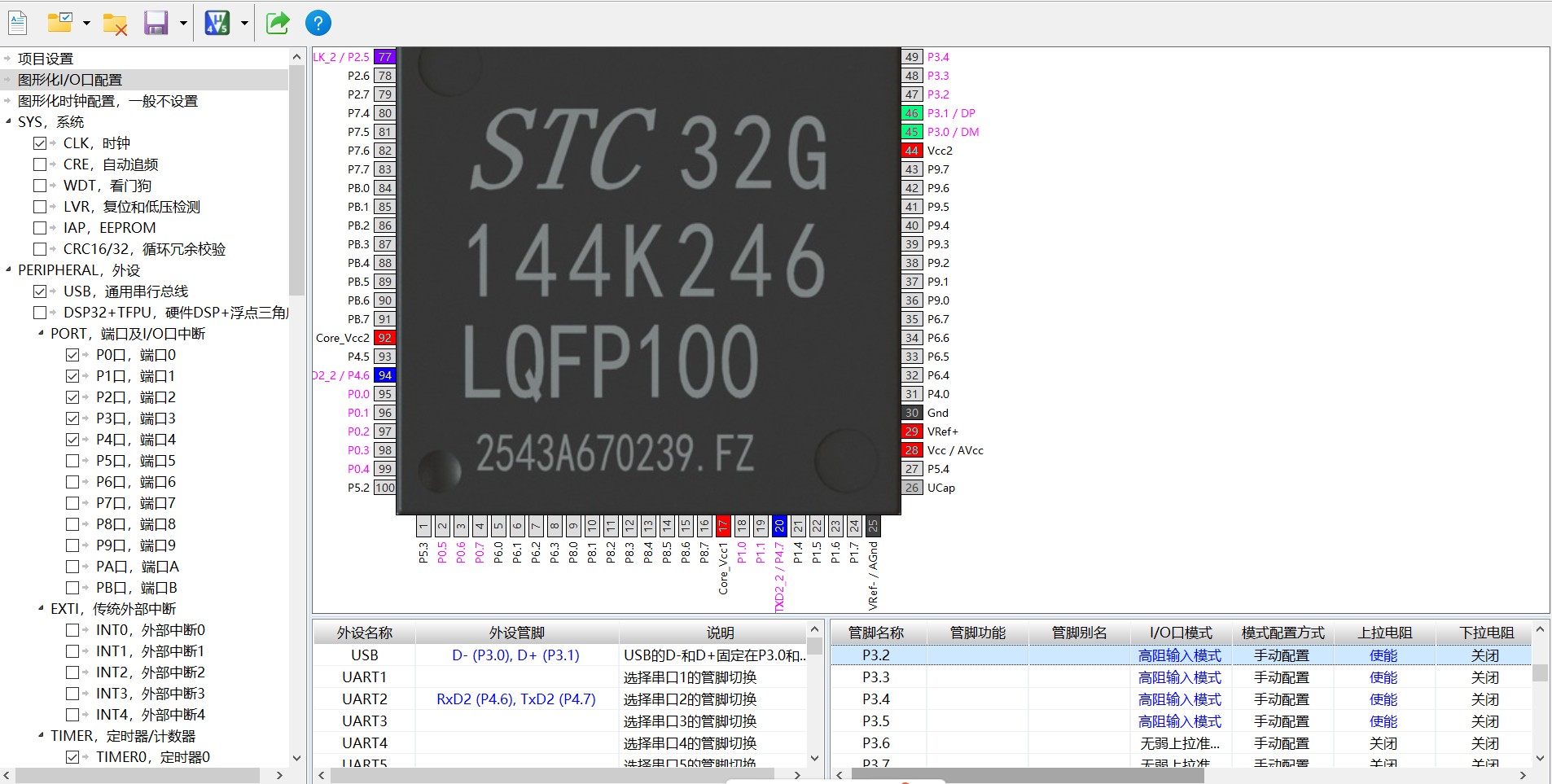

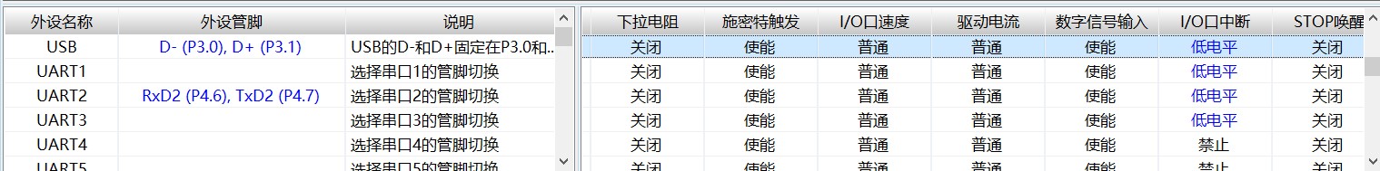

常见的操作,在原有的基础上增加P32按键,需要设置普通IO口按键中断:
是在原有的程序上增加P32按键,只有在AiCube 里增加P32的设置,回到Keil5 编译,就会报错:
".\Objects\main.obj",
".\Objects\port.obj",
".\Objects\clock.obj",
".\Objects\timer.obj",
".\Objects\uart.obj",
".\Objects\spi.obj",
".\Objects\usblib.obj",
".\Sources\lib\stc_usb_cdc_32g.lib"
TO ".\Objects\99-01_test_WSDCJ"
PRINT(".\Listings\99-01_test_WSDCJ.map") CASE DISABLEWARNING (16)
REMOVEUNUSED, NOOVERLAY
CLASSES (EDATA (0x0-0x3FFF),
HDATA (0x0-0x3FFF))
*** ERROR L256: UNKNOWN
Target not created.
Build Time Elapsed:  00:00:03
报错后,就算在AiCUb里删除P32的设置,回原来的状态编译也是同样报错,不知道哪里出问题啦?
