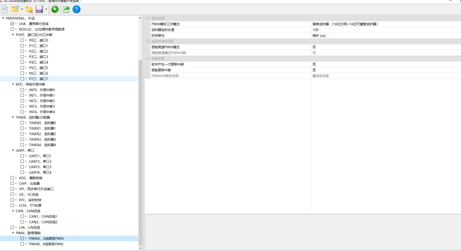

第一次用 AiCube-ISP  STC32G芯片配置PWM   未添加任何代码,编译时报错,求解
下面时编译时的报错信息

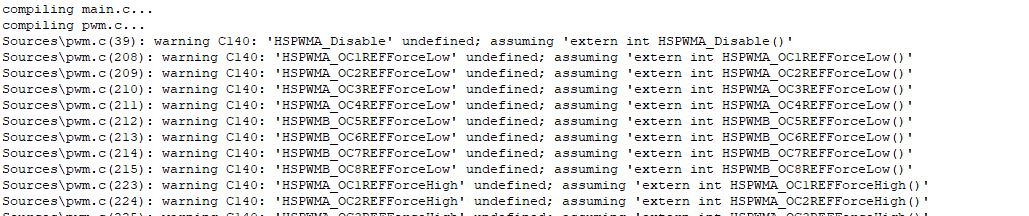

按你的方式,还是不行,PWM函数找不到Sources\pwm.c(39): warning C140: 'HSPWMA_Disable' undefined; assuming 'extern int HSPWMA_Disable()'
Sources\pwm.c(208): warning C140: 'HSPWMA_OC1REFForceLow' undefined; assuming 'extern int HSPWMA_OC1REFForceLow()'
Sources\pwm.c(209): warning C140: 'HSPWMA_OC2REFForceLow' undefined; assuming 'extern int HSPWMA_OC2REFForceLow()'
Sources\pwm.c(210): warning C140: 'HSPWMA_OC3REFForceLow' undefined; assuming 'extern int HSPWMA_OC3REFForceLow()'
Sources\pwm.c(211): warning C140: 'HSPWMA_OC4REFForceLow' undefined; assuming 'extern int HSPWMA_OC4REFForceLow()'
