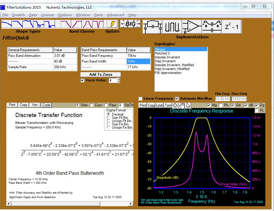

发表于 2025-8-12 22:23:20 | 显示全部楼层
深海*** 发表于 2025-8-12 18:38
本来想用max262这类片滤波处理,但是这些老芯片价格很高,现在想问问各位老师ai8051软件滤波方案是否可行 ...
15khz最高的话,应该没有问题,
具体要看带宽指标和带外衰减斜率.
可以用数字滤波器软件来生成代码测试
比如下面这个参数:
200khz采样率,15khz中心频率,带宽1khz,4阶滤波器
  1. float DigFil(invar, setic)
  2. float invar; int setic;
  3. /******************************************************************************/
  4. /* Filter Solutions Version 2015                 Nuhertz Technologies, L.L.C. */
  5. /*                                                            www.nuhertz.com */
  6. /*                                                            +1 602-279-2448 */
  7. /* 4th Order Band Pass Butterworth                                            */
  8. /* Bilinear Transformation with Prewarping                                    */
  9. /* Sample Frequency = 200.0 KHz                                               */
  10. /* Standard Form                                                              */
  11. /* Arithmetic Precision = 4 Digits                                            */
  12. /*                                                                            */
  13. /* Center Frequency = 15.00 KHz                                               */
  14. /* Pass Band Width = 1.000 KHz                                                */
  15. /*                                                                            */
  16. /******************************************************************************/
  17. /*                                                                            */
  18. /* Input Variable Definitions:                                                */
  19. /* Inputs:                                                                    */
  20. /*   invar    float       The input to the filter                             */
  21. /*   setic    int         1 to initialize the filter to zero                  */
  22. /*                                                                            */
  23. /* Option Selections:                                                         */
  24. /* Standard C;   Initializable;            Internal States;   Optimized;      */
  25. /*                                                                            */
  26. /* There is no requirement to ever initialize the filter.                     */
  27. /* The default initialization is zero when the filter is first called         */
  28. /*                                                                            */
  29. /******************************************************************************/
  30. /*                                                                            */
  31. /* This software is automatically generated by Filter Solutions               */
  32. /* no restrictions from Nuhertz Technologies, L.L.C. regarding the use and    */
  33. /* distributions of this software.                                            */
  34. /*                                                                            */
  35. /******************************************************************************/
  36. {
  37.     float sumnum=0.0, sumden=0.0;  int i=0;
  38.     static float states[8] = {0.0,0.0,0.0,0.0,0.0,0.0,0.0,0.0};
  39.     static float znum[5] = {
  40.         5.845e-08,
  41.         0.0,
  42.         -2.338e-07,
  43.         0.0,
  44.         3.507e-07
  45.     };
  46.     static float zden[8] = {
  47.         .9212,
  48.         -6.634,
  49.         21.67,
  50.         -41.81,
  51.         52.0,
  52.         -42.68,
  53.         22.58,
  54.         -7.055
  55.     };
  56.     if (setic==1){
  57.         for (i=0;i<8;i++) states[i] = 461.4*invar;
  58.         return 0.0;
  59.     }
  60.     else{
  61.         sumnum = sumden = 0.0;
  62.         for (i=0;i<8;i++){
  63.             sumden += states[i]*zden[i];
  64.             sumnum += states[i]*znum[i<5?i:8-i];
  65.             if (i<7) states[i] = states[i+1];
  66.         }
  67.         states[7] = invar-sumden;
  68.         sumnum += states[7]*znum[0];
  69.         return sumnum;
  70.     }
  71. }
