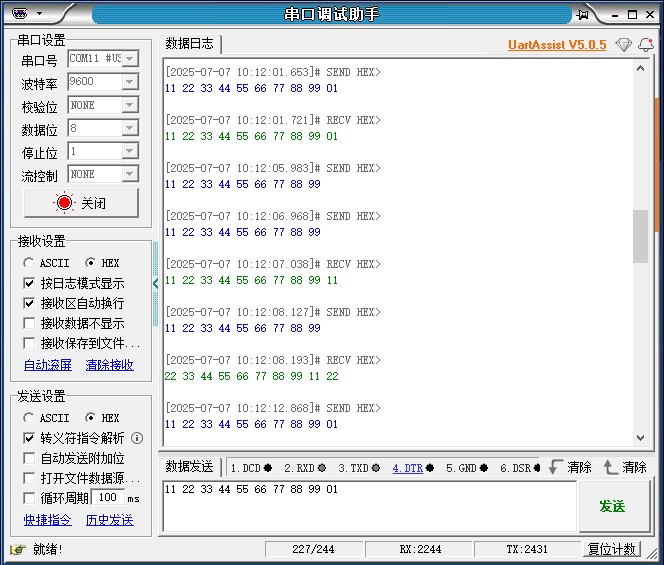

[2025-07-07 10:12:01.465]# SEND HEX>
11 22 33 44 55 66 77 88 99 01
[2025-07-07 10:12:01.545]# RECV HEX>
[2025-07-07 10:12:01.653]# SEND HEX>
[2025-07-07 10:12:01.721]# RECV HEX>
[2025-07-07 10:12:05.983]# SEND HEX>
[2025-07-07 10:12:06.968]# SEND HEX>
[2025-07-07 10:12:07.038]# RECV HEX>
11 22 33 44 55 66 77 88 99 11
[2025-07-07 10:12:08.127]# SEND HEX>
[2025-07-07 10:12:08.193]# RECV HEX>
22 33 44 55 66 77 88 99 11 22
[2025-07-07 10:12:12.868]# SEND HEX>
[2025-07-07 10:12:12.937]# RECV HEX>
33 44 55 66 77 88 99 11 22 33
[2025-07-07 10:12:14.684]# SEND HEX>
[2025-07-07 10:12:14.748]# RECV HEX>
44 55 66 77 88 99 01 11 22 33
[2025-07-07 10:12:15.364]# SEND HEX>
[2025-07-07 10:12:15.437]# RECV HEX>
[2025-07-07 10:12:16.050]# SEND HEX>
[2025-07-07 10:12:16.110]# RECV HEX>
[2025-07-07 10:12:16.251]# SEND HEX>
[2025-07-07 10:12:16.319]# RECV HEX>
[2025-07-07 10:12:16.430]# SEND HEX>
[2025-07-07 10:12:16.495]# RECV HEX>
[2025-07-07 10:12:16.622]# SEND HEX>
[2025-07-07 10:12:16.688]# RECV HEX>
[2025-07-07 10:12:16.802]# SEND HEX>
[2025-07-07 10:12:16.864]# RECV HEX>
[2025-07-07 10:12:16.982]# SEND HEX>
[2025-07-07 10:12:17.057]# RECV HEX>

就是意思是有超时处理,但是超时复位不了DMA,功能都正常,就是超时时间到了,DMA复位不了,然后还是一直等待,就是问问怎么样复位DMA的,也重新配置了,不行。
