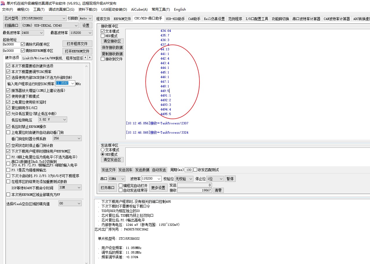

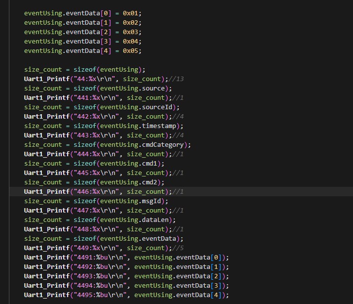

STC15F2K60S2单片机,使用Keil编译sizeof计算结构体长度和实际对应不上
整个结构体计算是13字节
但是单独计算和程序运行计算每个变量的长度19个字节
2853
1453
1453

发表于 2025-4-18 11:41:35 | 显示全部楼层

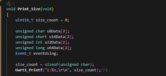

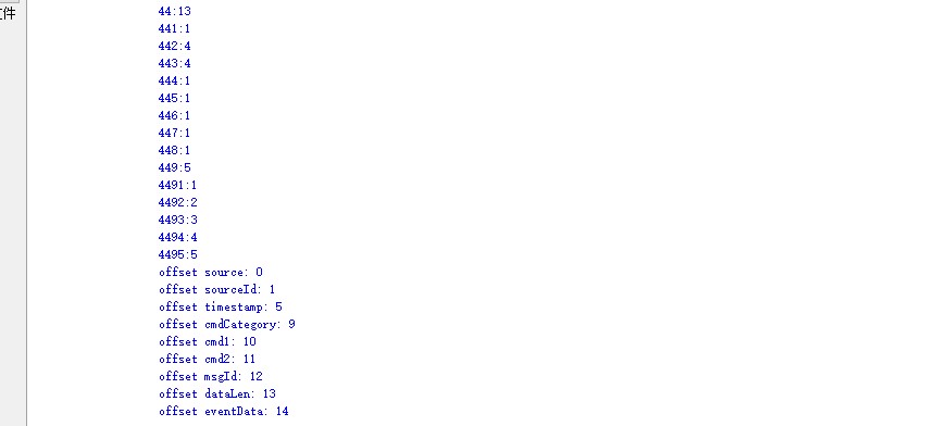

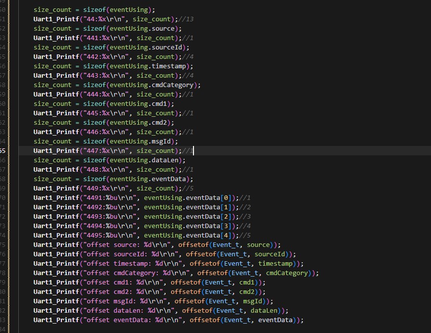

    size_count = sizeof(eventUsing);
    Uart1_Printf("44:%x\r\n", size_count);//13
    size_count = sizeof(eventUsing.source);
    Uart1_Printf("441:%x\r\n", size_count);//1
    size_count = sizeof(eventUsing.sourceId);
    Uart1_Printf("442:%x\r\n", size_count);//4
    size_count = sizeof(eventUsing.timestamp);
    Uart1_Printf("443:%x\r\n", size_count);//4
    size_count = sizeof(eventUsing.cmdCategory);
    Uart1_Printf("444:%x\r\n", size_count);//1
    size_count = sizeof(eventUsing.cmd1);
    Uart1_Printf("445:%x\r\n", size_count);//1
    size_count = sizeof(eventUsing.cmd2);
    Uart1_Printf("446:%x\r\n", size_count);//1
    size_count = sizeof(eventUsing.msgId);
    Uart1_Printf("447:%x\r\n", size_count);//1
    size_count = sizeof(eventUsing.dataLen);
    Uart1_Printf("448:%x\r\n", size_count);//1
    size_count = sizeof(eventUsing.eventData);
    Uart1_Printf("449:%x\r\n", size_count);//5
    Uart1_Printf("4491:%bu\r\n", eventUsing.eventData[0]);//1
    Uart1_Printf("4492:%bu\r\n", eventUsing.eventData[1]);//2
    Uart1_Printf("4493:%bu\r\n", eventUsing.eventData[2]);//3
    Uart1_Printf("4494:%bu\r\n", eventUsing.eventData[3]);//4
    Uart1_Printf("4495:%bu\r\n", eventUsing.eventData[4]);//5
    Uart1_Printf("offset source: %d\r\n", offsetof(Event_t, source));
    Uart1_Printf("offset sourceId: %d\r\n", offsetof(Event_t, sourceId));
    Uart1_Printf("offset timestamp: %d\r\n", offsetof(Event_t, timestamp));
    Uart1_Printf("offset cmdCategory: %d\r\n", offsetof(Event_t, cmdCategory));
    Uart1_Printf("offset cmd1: %d\r\n", offsetof(Event_t, cmd1));
    Uart1_Printf("offset cmd2: %d\r\n", offsetof(Event_t, cmd2));
    Uart1_Printf("offset msgId: %d\r\n", offsetof(Event_t, msgId));
    Uart1_Printf("offset dataLen: %d\r\n", offsetof(Event_t, dataLen));
    Uart1_Printf("offset eventData: %d\r\n", offsetof(Event_t, eventData));
这个日志eventData,size_count 的类型是一个都看不到哇~  详情 回复 发表于 2025-4-18 11:44

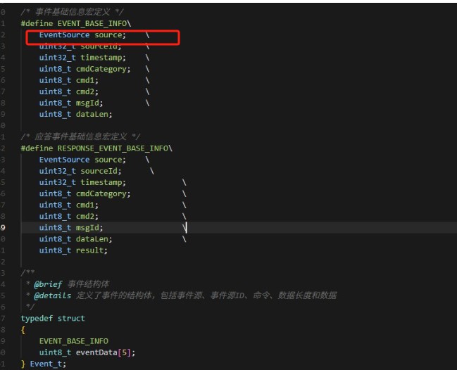

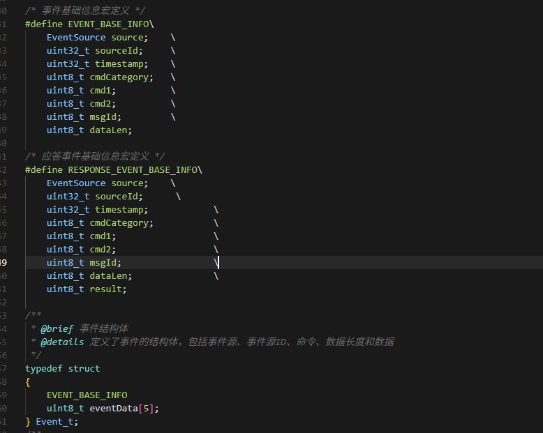

发这个没用,发结构体声明代码,或者上传工程。另外下次回复时点击这里我才能收到提醒~。不然只能F5不停刷新了。 [attachimg]94364[/attachimg]  详情 回复 发表于 2025-4-18 11:43
  • 打卡总天数:535
  • 最近打卡:2026-05-14 08:52:33
108
4398
9852
9852
发表于 2025-4-18 11:43:53 | 显示全部楼层
    size_count = ...

发表于 2025-4-18 11:44:47 | 显示全部楼层
    size_count = ...

发表于 2025-4-18 11:45:59 | 显示全部楼层
增加数据

发表于 2025-4-18 11:46:35 | 显示全部楼层
上传了,您看一下

发表于 2025-4-18 11:47:52 | 显示全部楼层
上传

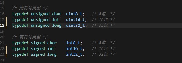

发表于 2025-4-18 11:58:37 | 显示全部楼层
是不是漏了这个
