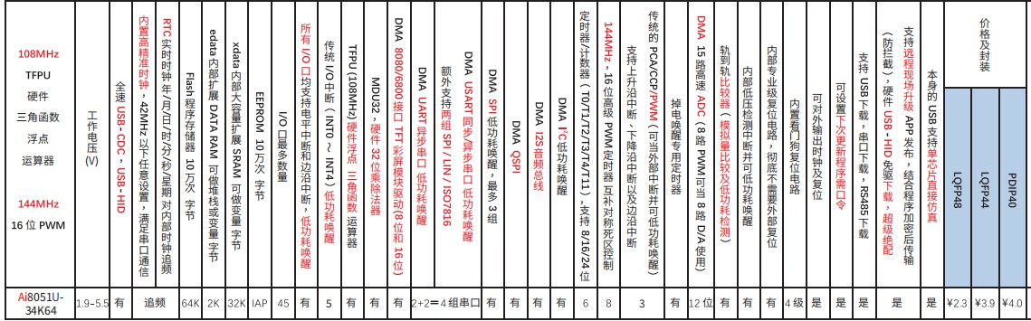

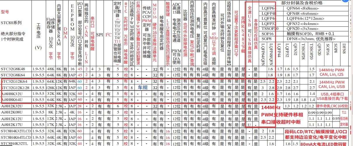

8H8K64U-QFN64/48/32,
STC32G12K128-QFN64/48/32
AI8051U-QFN48

就只有8h8k64U了吧,2.5
