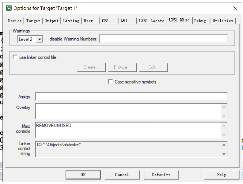

选择LX51连接器,LX misc中增加REMOVEUNUSED,编译优化后:
Rebuild started: Project: atxtester
Rebuild target 'Target 1'
assembling STARTUP.A51...
compiling main.c...
compiling tm1640.c...
linking...
Program Size: data=35.0 xdata=300 const=0 code=3219
creating hex file from ".\Objects\atxtester"...
".\Objects\atxtester" - 0 Error(s), 0 Warning(s).
Build Time Elapsed:  00:00:01

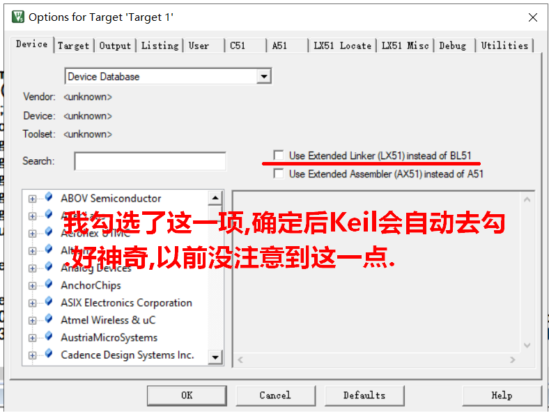

谢谢你的指点,问题确实是出在这里.我排查代码好久都没结果.多谢
图片1,我勾选了LX51选项,确定后Keil会自动去勾.好神奇,以前没注意到这一点.
