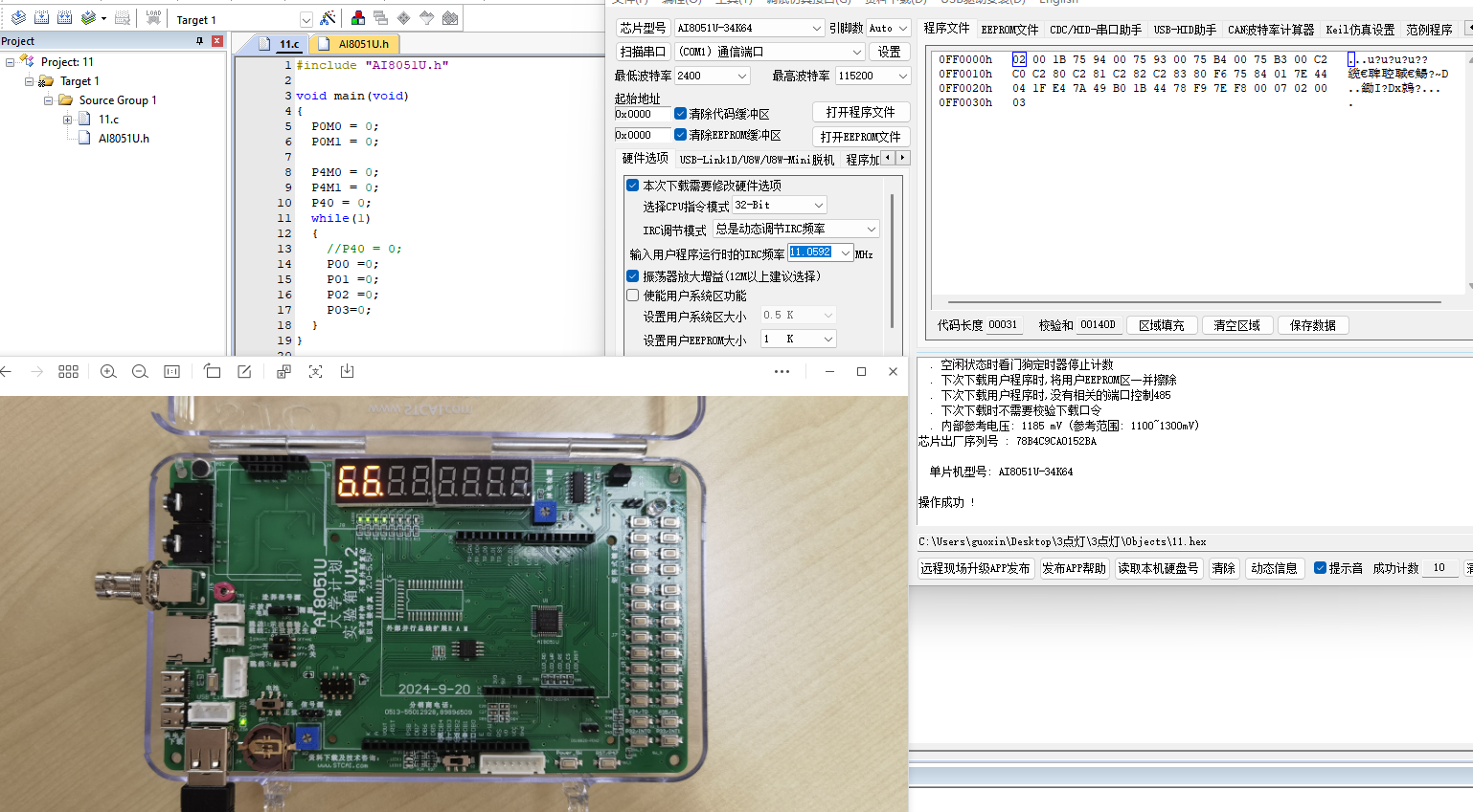

第3集已学习,已手敲代码,测试通过
第三集 点亮LED.zip
39.18 KB, 下载次数: 42

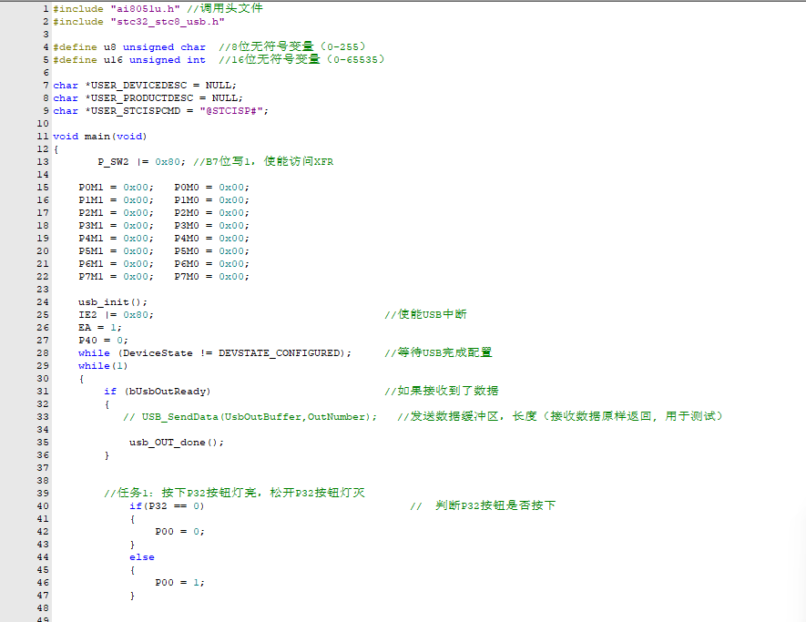

第6集学习打卡
第6集代码:
#include "ai8051u.h" //调用头文件
#include "stc32_stc8_usb.h"
#include "intrins.h" //调用头文件
#define u8 unsigned char //8位无符号变量(0-255)
#define u16 unsigned int //16位无符号变量(0-65535)
u8 state = 0; // 初始状态
char *USER_DEVICEDESC = NULL;
void Delay20ms(void) //@24.000MHz
unsigned long edata i;
nop();
nop();
i = 119998UL;
while (i) i--;
void main(void)
WTST = 0;
EAXFR = 1;
CKCON = 0;
P0M1 = 0x00; P0M0 = 0x00;
P1M1 = 0x00; P1M0 = 0x00;
P2M1 = 0x00; P2M0 = 0x00;
P3M1 = 0x00; P3M0 = 0x00;
P4M1 = 0x00; P4M0 = 0x00;
P5M1 = 0x00; P5M0 = 0x00;
P6M1 = 0x00; P6M0 = 0x00;
P7M1 = 0x00; P7M0 = 0x00;
usb_init();
IE2 |= 0x80;
EA = 1;
    P40 = 0;
    while (DeviceState != DEVSTATE_CONFIGURED);
    while(1)
            if (bUsbOutReady)
       // USB_SendData(UsbOutBuffer,OutNumber);
        usb_OUT_done();
                    if(P32 == 0)                                                                       //判断P32按钮是否按下
                            P00 = 0;
                    else
                            P00 = 1;

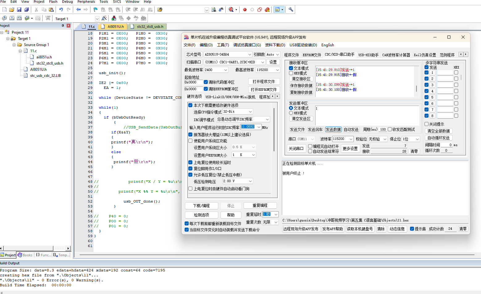

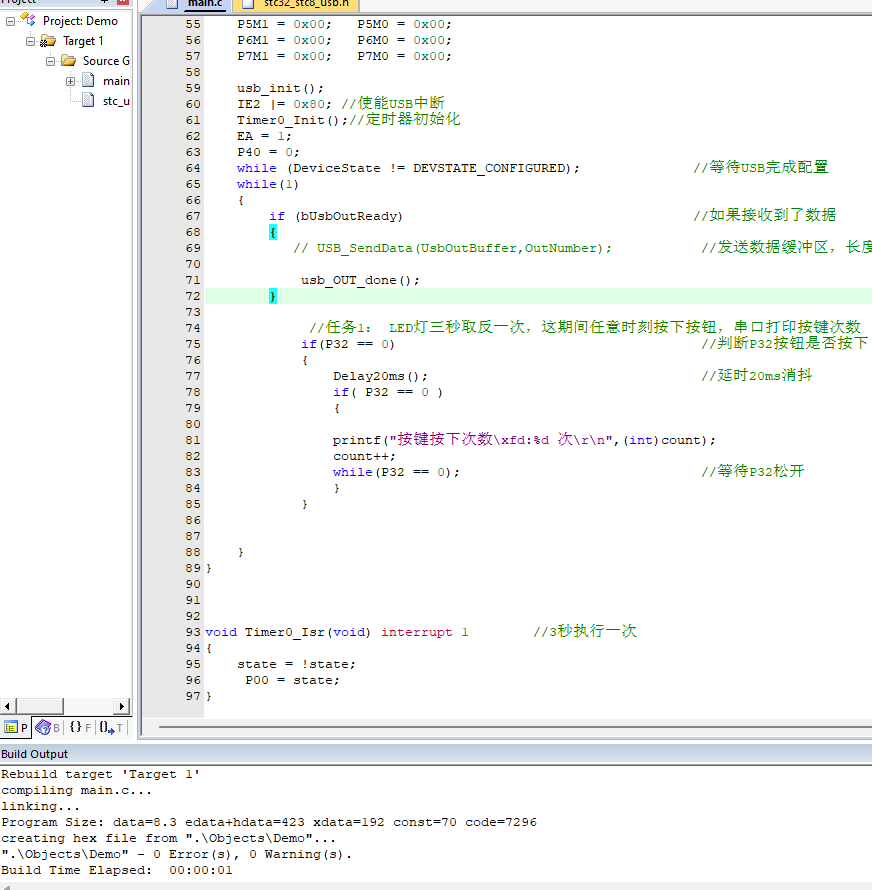

第7集打卡学习
程序:
u8 state = 0;             //初始状态
//u8 Run_State = 0;         //运行状态
    _nop_();
    _nop_();
    i = 119998UL;
    while (i) i--;
void Timer0_Init(void)        //3秒@24.000MHz
    TM0PS = 0x5B;            //设置定时器时钟预分频 ( 注意:并非所有系列都有此寄存器,详情请查看数据手册 )
    AUXR &= 0x7F;            //定时器时钟12T模式
    TMOD &= 0xF0;            //设置定时器模式
    TL0 = 0x3F;                //设置定时初始值
    TH0 = 0x01;                //设置定时初始值
    TF0 = 0;                //清除TF0标志
    TR0 = 1;                //定时器0开始计时
    ET0 = 1;                //使能定时器0中断
    //TM0PS = 91;
    //12T  /12
    // TH0-TL0=319
void main(void)
    int count = 1;                                              //按键计数
    WTST = 0;                                               //设置程序指令延时参数,赋值为0可将CPU执行指令的速度设置为最快
    EAXFR = 1;                                              //扩展寄存器(XFR)访问使能
    CKCON = 0;                                              //提高访问XRAM速度
    usb_init();
    IE2 |= 0x80; //使能USB中断
    Timer0_Init();//定时器初始化
    EA = 1;
    P40 = 0;
    while (DeviceState != DEVSTATE_CONFIGURED);              //等待USB完成配置
    while(1)
        if (bUsbOutReady)                                    //如果接收到了数据
           // USB_SendData(UsbOutBuffer,OutNumber);           //发送数据缓冲区,长度(接收数据原样返回, 用于测试)
            usb_OUT_done();
             //任务1: LED灯三秒取反一次,这期间任意时刻按下按钮,串口打印按键次数
                Delay20ms();                                  //延时20ms消抖
                if( P32 == 0 )
                printf("按键按下次数\xfd:%d 次\r\n",(int)count);
                count++;
                while(P32 == 0);                              //等待P32松开
void Timer0_Isr(void) interrupt 1        //3秒执行一次
    state = !state;
     P00 = state;

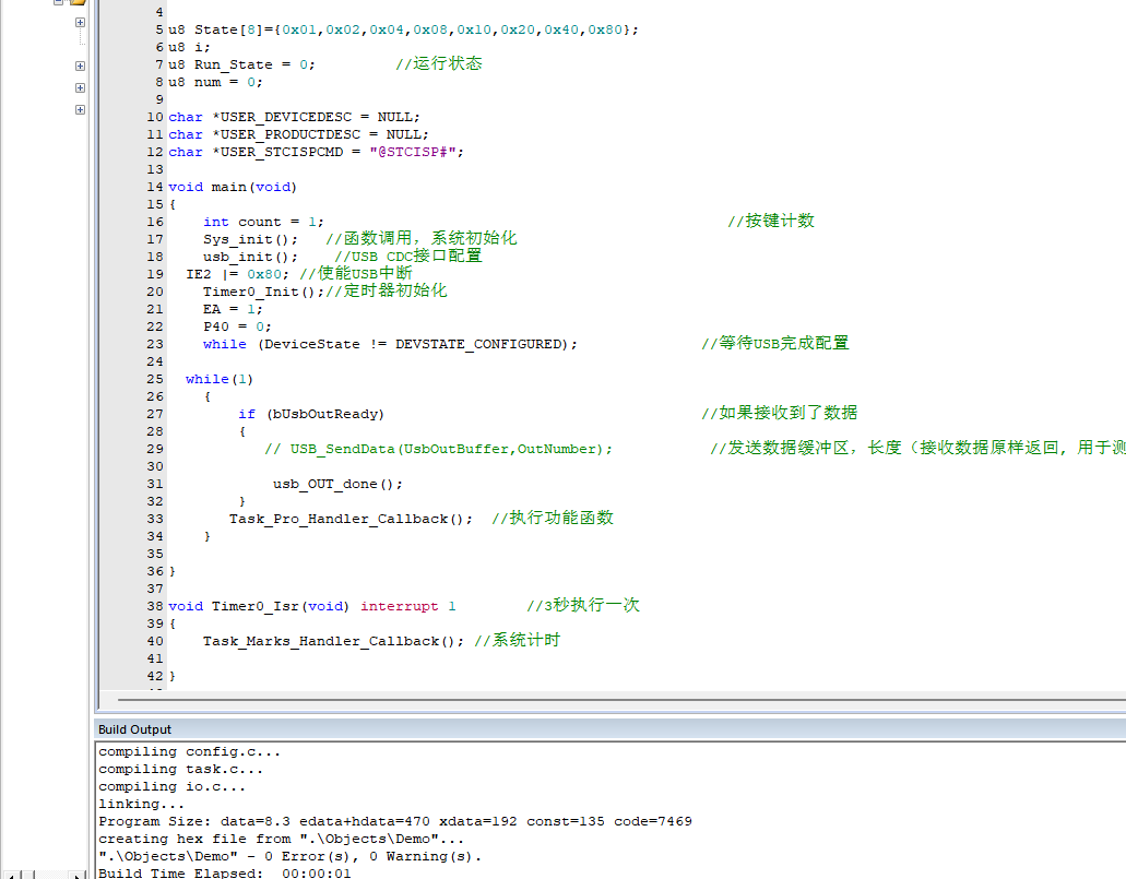

第8集
#include "config.h"
#include "task.h"
#include "io.h"
u8 State[8]={0x01,0x02,0x04,0x08,0x10,0x20,0x40,0x80};
u8 i;
u8 Run_State = 0;
u8 num = 0;
void main(void)
    int count = 1;
    Sys_init();
    usb_init();
        IE2 |= 0x80;
    Timer0_Init();
    EA = 1;
    P40 = 0;
        while(1)
        if (bUsbOutReady)
            usb_OUT_done();
       Task_Pro_Handler_Callback();
                Task_Marks_Handler_Callback();
第8集 实验箱视频.mp4
1.3 MB, 下载次数: 27

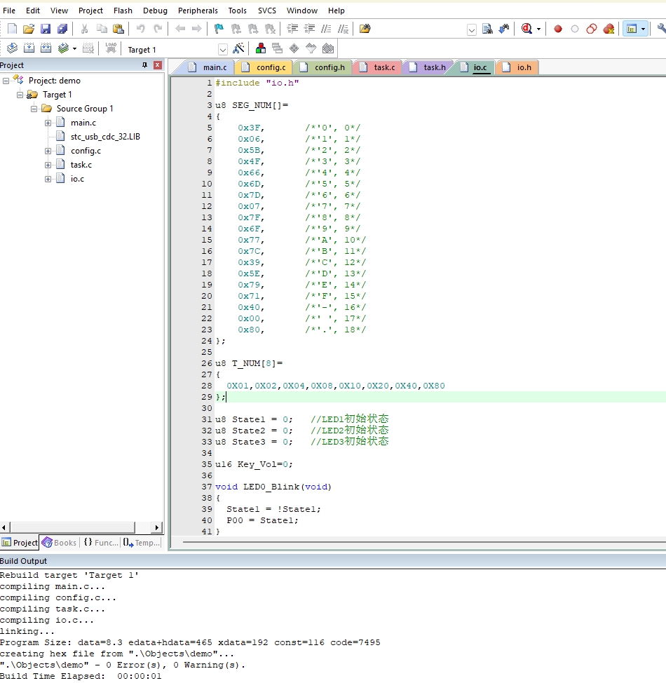

第9集  手敲代码通过
#include "config.h"
#include "task.h"
#include "io.h"
void main(void)
        Sys_init();                                                                                //ϵͳ³õʼ»¯
        usb_init();                                     //USB CDC ½Ó¿ÚÅäÖÃ
    IE2 |= 0x80;                                    //ʹÄÜUSBÖжÏ
        Timer0_Init();                                                                        //¶¨Ê±Æ÷³õʼ»¯
    Init_595();
        EA = 1;                                                                                        //IE |= 0X80;
        P40 = 0;
        while (DeviceState != DEVSTATE_CONFIGURED);     //µÈ´ýUSBÍê³ÉÅäÖÃ
        while(1)
        if (bUsbOutReady)                                                        //Èç¹û½ÓÊÕµ½ÁËÊý¾Ý
            //USB_SendData(UsbOutBuffer,OutNumber);   //·¢ËÍÊý¾Ý»º³åÇø£¬³¤¶È£¨½ÓÊÕÊý¾ÝÔ­Ñù·µ»Ø, ÓÃÓÚ²âÊÔ£©
            usb_OUT_done();                                                        //
                Task_Pro_Handler_Callback();                                //Ö´Ðй¦Äܺ¯Êý
void Timer0_Isr(void) interrupt 1                //1MSÖ´ÐÐÒ»´Î
        Task_Marks_Handler_Callback();                                        //ϵͳ¼ÆÊ±

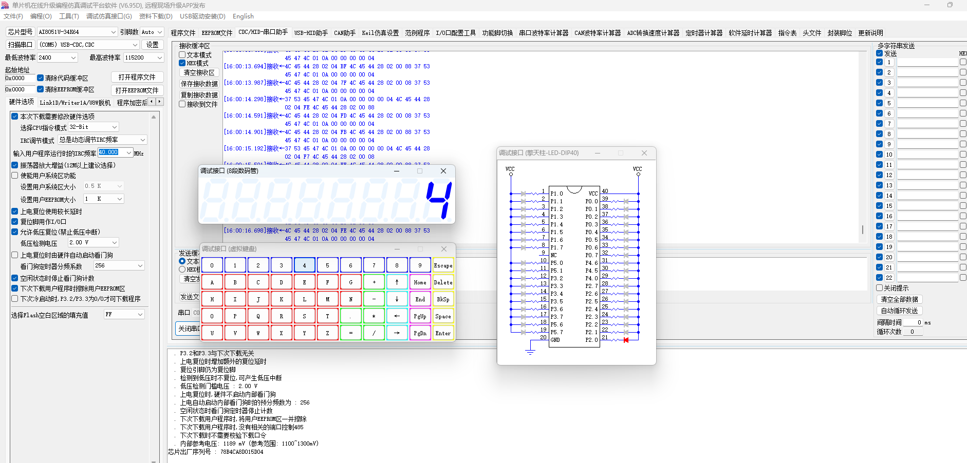

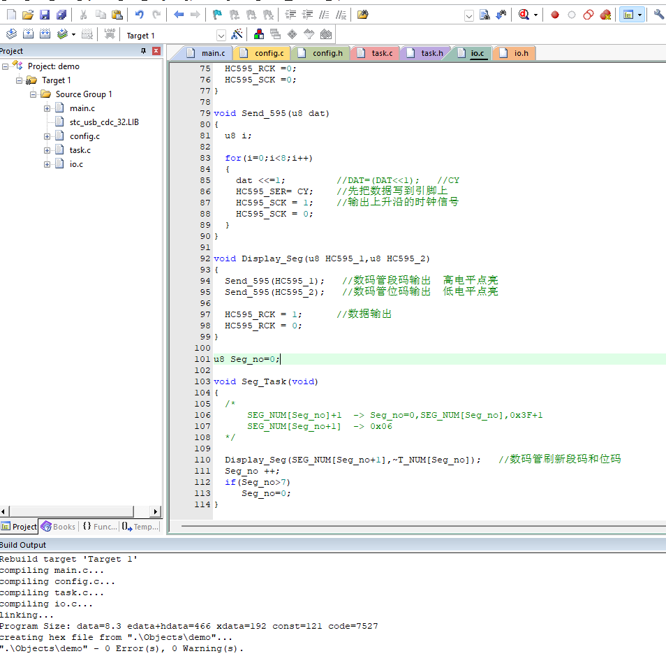

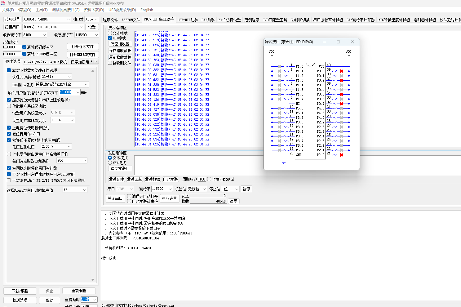

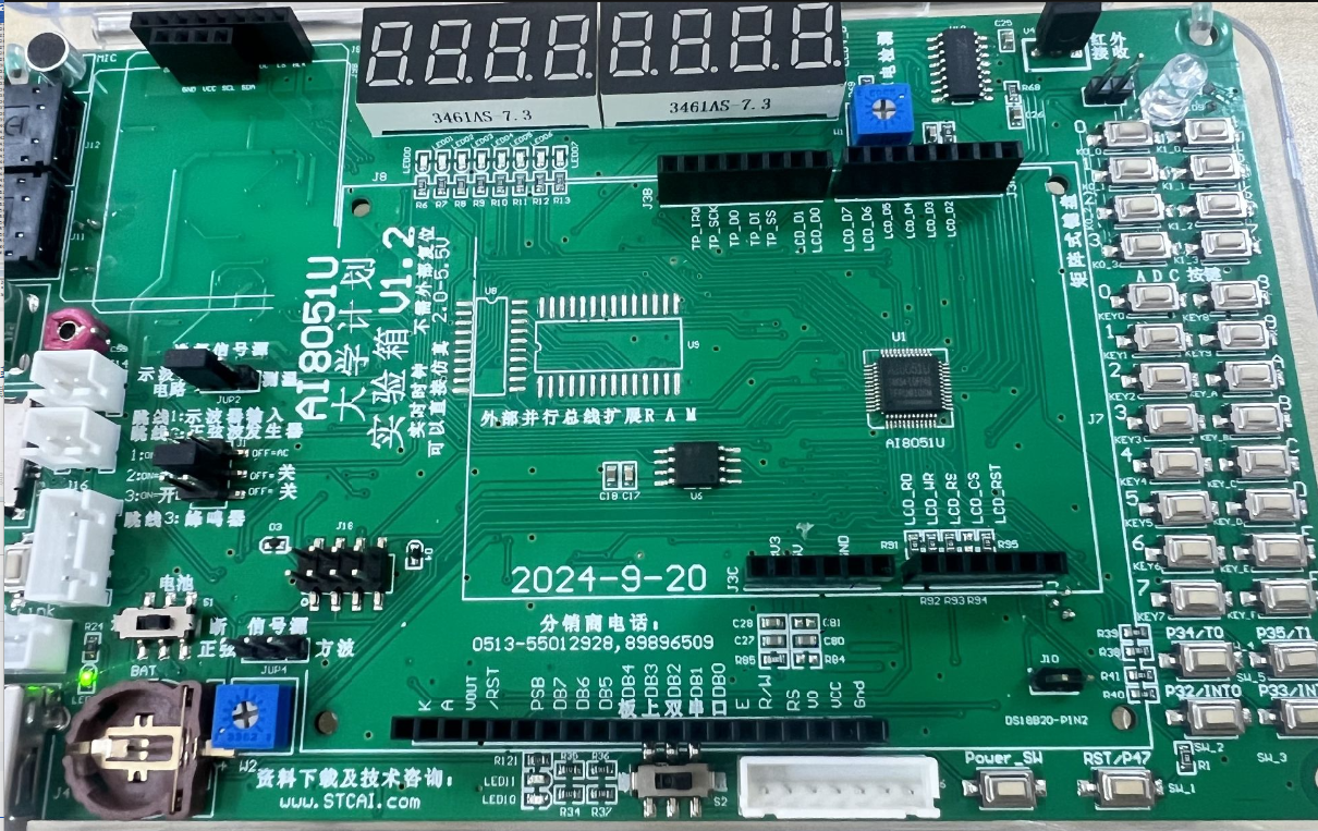

第十集:
点亮P20端口
void TASK_1( void )
    //-------------------------p2端口流水灯------------------------
    LED40_SetPort(2,~P2_STATE);  //点亮P20端口
P2口流水灯,P10闪烁 ,见视频
左边数码管显示p32按下次数,右边数码管显示p33按下次数
按下数字按键在数码管显示对应的数字按键
第十集.mp4
1.62 MB, 下载次数: 28
第十集 虚拟LED和数码管.zip
464.92 KB, 下载次数: 28

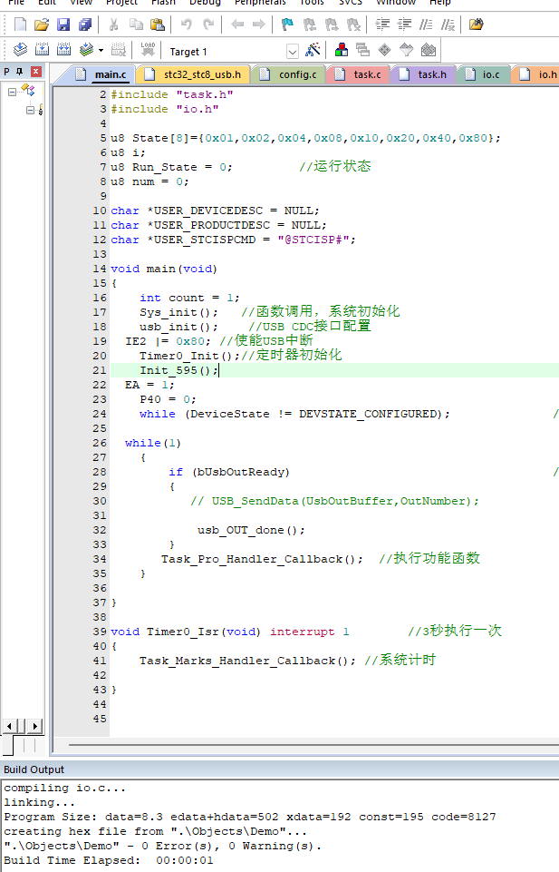

1500
发表于 2025-1-14 15:26:14 | 显示全部楼层

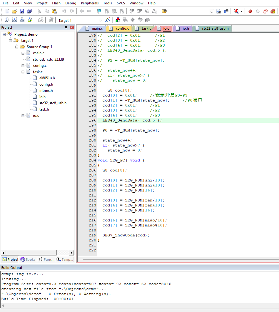

第十一集
任务一
代码:
#include "config.h"
#include "task.h"
#include "io.h"
u8 i;
u8 num = 0;
void main(void)
    Sys_init();   //函数调用,系统初始化
    usb_init();    //USB CDC接口配置
    Init_595();
    EA = 1;
    P40 = 0;
    while(1)
        if (bUsbOutReady)
            usb_OUT_done();
任务二
代码:
#include "config.h"
#include "task.h"
#include "io.h"
u8 i;
u8 num = 0;
void main(void)
    int count = 1;
    Init_595();
    EA = 1;
    P40 = 0;
    while(1)
        if (bUsbOutReady)
            usb_OUT_done();
第11集视频1.mp4
2.83 MB, 下载次数: 20
11-2.mp4
4.75 MB, 下载次数: 14

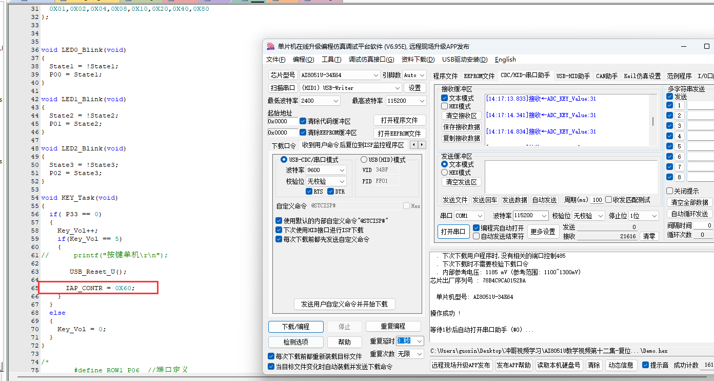

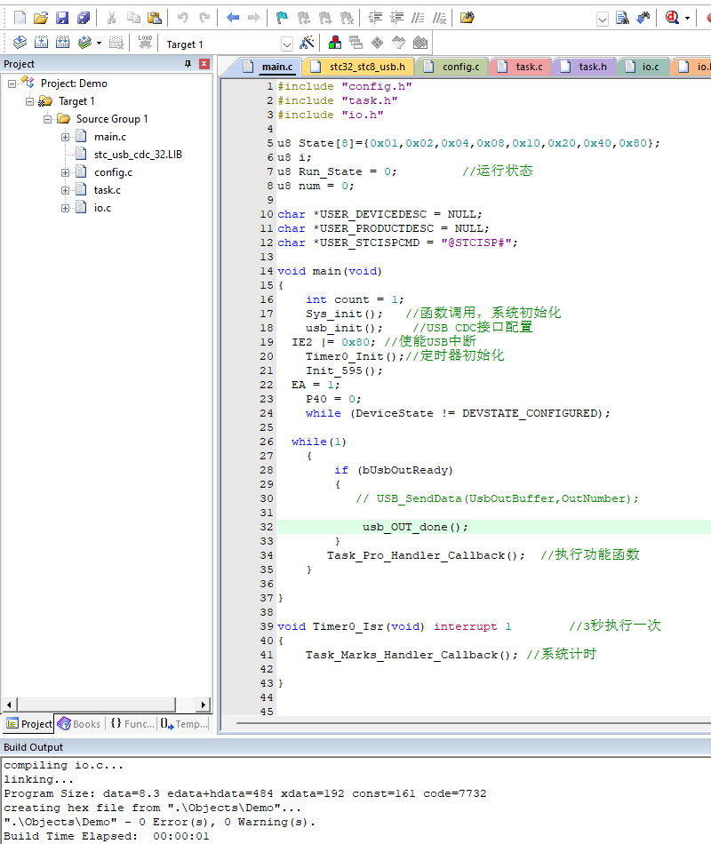

第12集  复位系统
任务一:
代码:
#include "config.h"
#include "task.h"
#include "io.h"
u8 i;
u8 num = 0;
void main(void)
    Init_595();
        EA = 1;
    P40 = 0;
    WDT_CONTR = 0X24;
        while(1)
            usb_OUT_done();
       Task_Pro_Handler_Callback();  //执行功能函数
       if( P33 !=0)
                WDT_CONTR = 0X34;
                Task_Marks_Handler_Callback(); //系统计时

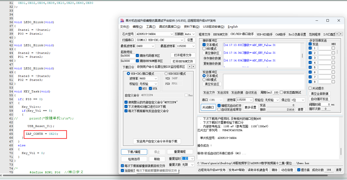

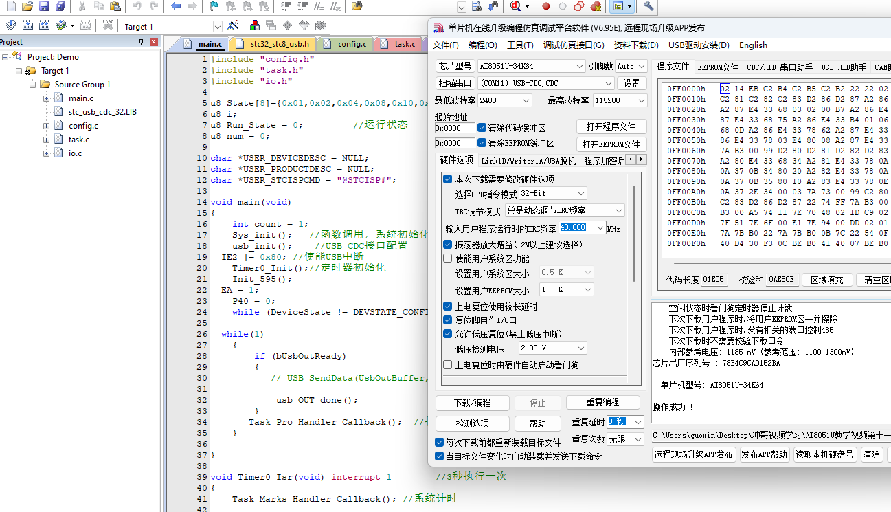

任务二
(1)复位后进入下载模式
(2)复位后从头开始运行用户程序
程序:
#include "config.h"
#include "task.h"
#include "io.h"
u8 i;
u8 num = 0;
void main(void)
    Init_595();
        EA = 1;
    P40 = 0;
    WDT_CONTR = 0X24;
        while(1)
            usb_OUT_done();
                WDT_CONTR = 0X34;
