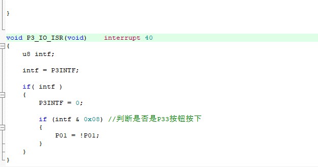

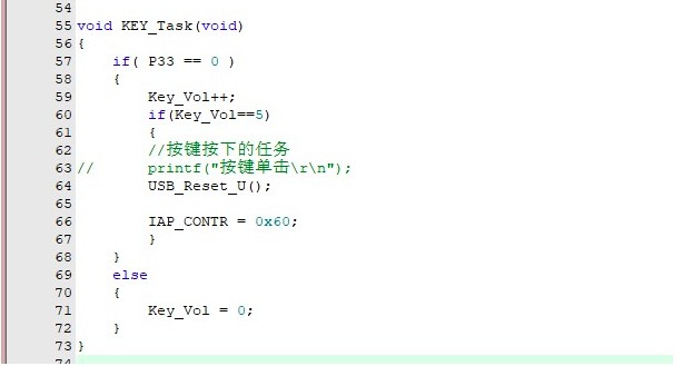

第十四集  IO中断  手敲代码
#include "io.h"
u8 State1 = 0;                                        //LED1初始状态
u8 State2 = 0;                                        //LED2初始状态
u8 State3 = 0;                                        //LED3初始状态
u16 Key_Vol ;                                //按键按下持续时间
u8 SEG_NUM[]=
    0x3F,       /*'0', 0*/
    0x06,       /*'1', 1*/
    0x5B,       /*'2', 2*/
    0x4F,       /*'3', 3*/
    0x66,       /*'4', 4*/
    0x6D,       /*'5', 5*/
    0x7D,       /*'6', 6*/
    0x07,       /*'7', 7*/
    0x7F,       /*'8', 8*/
    0x6F,       /*'9', 9*/
    0x77,       /*'A', 10*/
    0x7C,       /*'B', 11*/
    0x39,       /*'C', 12*/
    0x5E,       /*'D', 13*/
    0x79,       /*'E', 14*/
    0x71,       /*'F', 15*/
    0x40,       /*'-', 16*/
    0x00,       /*' ', 17*/
    0x80,       /*'.', 18*/
u8 T_NUM[8] =
        0X01,0X02,0X04,0X08,0X10,0X20,0X40,0X80
void LED0_Blink(void)
        State1 = !State1;
        P00 = State1;
void LED1_Blink(void)
        State2 = !State2;
        P01 = State2;
void LED2_Blink(void)
        State3 = !State3;
        P02 = State3;
void KEY_Task(void)
        if( P33 == 0 )
                Key_Vol++;
                if( Key_Vol==5 )
                        //按键按下的任务
//                        printf( "按键单击\r\n" );
                        USB_Reset_U();
                        IAP_CONTR = 0X20;
        else
                Key_Vol = 0;

void P3_IO_Init(void)
        P3IM0 = 0X00;    //IO中断模式设置为下降沿
        P3IM1 = 0X00;
        P3INTE= 0X08;        //打开中断
void P3_IO_ISR(void)        interrupt 40
        u8 intf;
        intf = P3INTF;
        if( intf )
                P3INTF = 0;
                if (intf & 0x08) //判断是否是P33按钮按下
                        P01 = !P01;

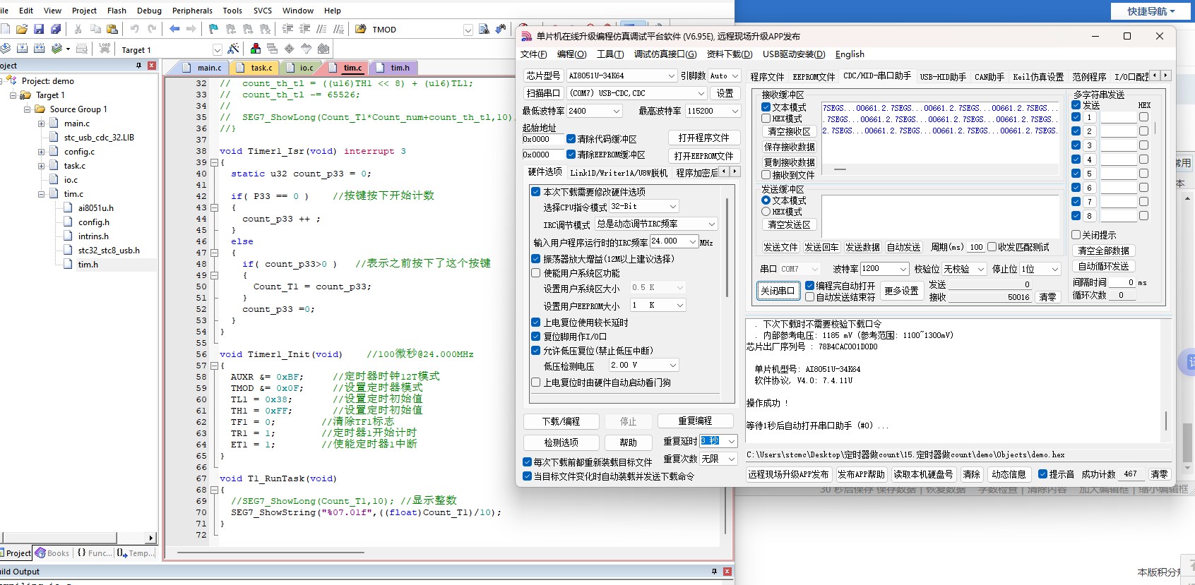

任务2 :编写INT1测量低电平时间(由按键模拟信号,100us的计数周期计数)
#include "tim.h"
u32 Count_T1 = 0;
//void TIM1_Count_Init(void)
//        T1_CT = 1;
//        T1_M1 = 0;
//        T1_M0 = 0;
//        T1_GATE = 0;
//        TH1 = (65536-Count_num)>>8;        //65526
//        TL1 = (65536-Count_num);
//        P3PU |= 0x20;
//        TR1 = 1;
//        ET1 = 1;
//void Timer1_Isr(void) interrupt 3
//        Count_T1 ++;
//void T1_RunTask(void)
//        u32 count_th_tl = 0;
//        count_th_tl = ((u16)TH1 << 8) + (u16)TL1;
//        count_th_tl -= 65526;
//        SEG7_ShowLong(Count_T1*Count_num+count_th_tl,10);
        static u32 count_p33 = 0;
        if( P33 == 0 )
                count_p33 ++ ;
        else
                if( count_p33>0 )
                        Count_T1 = count_p33;
                count_p33 =0;
void Timer1_Init(void)
        AUXR &= 0xBF;
        TMOD &= 0x0F;
        TL1 = 0x38;
        TH1 = 0xFF;
        TF1 = 0;
        TR1 = 1;
        ET1 = 1;
        SEG7_ShowString("%07.01f",((float)Count_T1)/10);

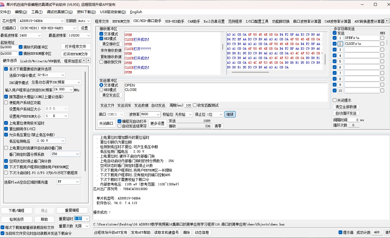

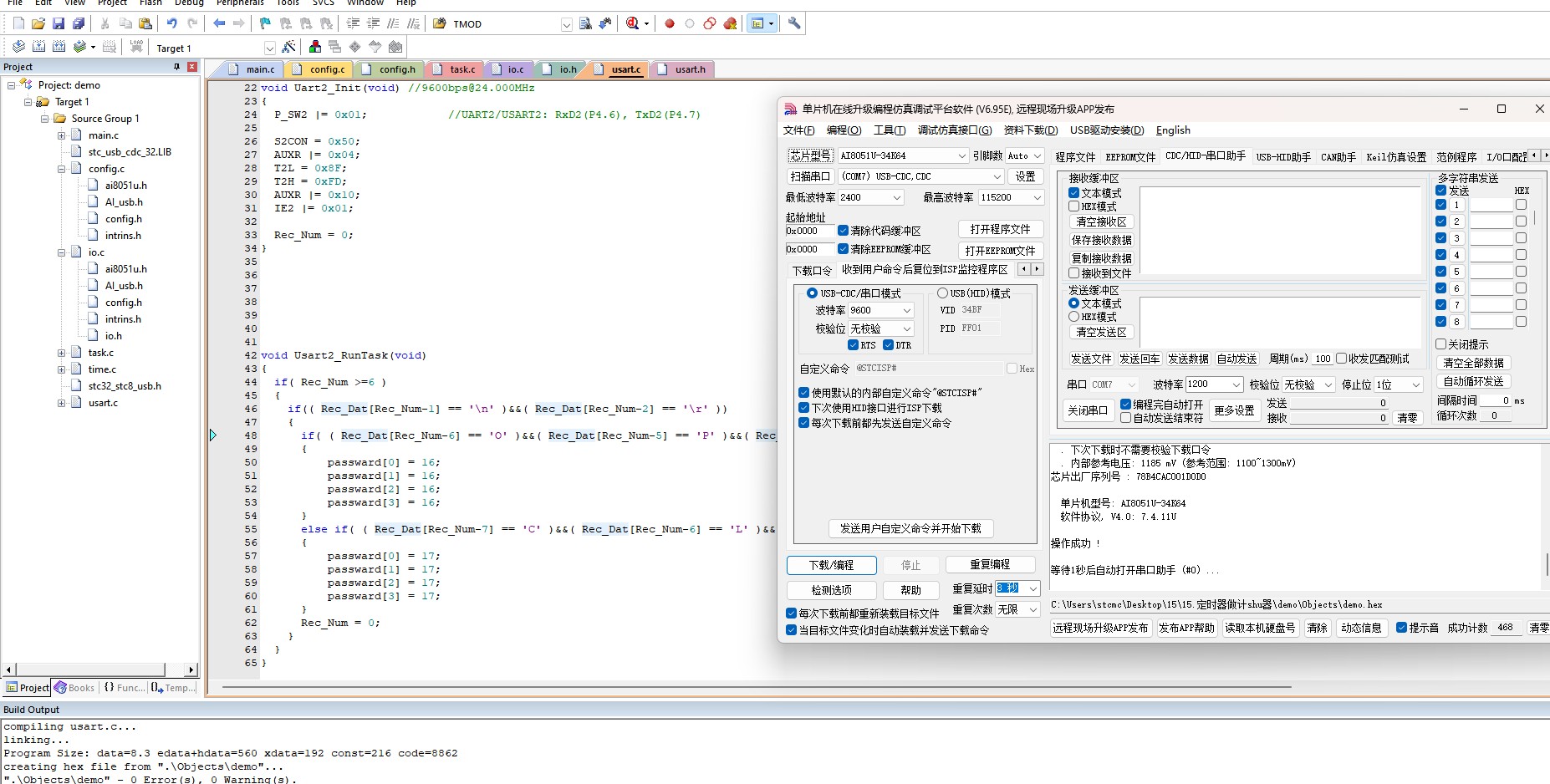

第十六集 串口的简单应用
#include "usart.h"
#include "io.h"
u8 Rec_Dat[50];
u8 Rec_Num = 0;
void Uart2_Isr(void) interrupt 8
        if (S2CON & 0x02)
                S2CON &= ~0x02;
        if (S2CON & 0x01)
                S2CON &= ~0x01;
                Rec_Dat[Rec_Num++] = S2BUF;
void Uart2_Init(void)        //9600bps@24.000MHz
        P_SW2 |= 0x01;                                                //UART2/USART2: RxD2(P4.6), TxD2(P4.7)
        S2CON = 0x50;
        AUXR |= 0x04;
        T2L = 0x8F;
        T2H = 0xFD;
        AUXR |= 0x10;
        IE2 |= 0x01;
        Rec_Num = 0;
void Usart2_RunTask(void)
        if( Rec_Num >=6 )
                if(( Rec_Dat[Rec_Num-1] == '\n' )&&( Rec_Dat[Rec_Num-2] == '\r' ))
                        if( ( Rec_Dat[Rec_Num-6] == 'O' )&&( Rec_Dat[Rec_Num-5] == 'P' )&&( Rec_Dat[Rec_Num-4] == 'E' )&&( Rec_Dat[Rec_Num-3] == 'N' ) )
                                        passward[0] = 16;
                                        passward[1] = 16;
                                        passward[2] = 16;
                                        passward[3] = 16;
                        else if( ( Rec_Dat[Rec_Num-7] == 'C' )&&( Rec_Dat[Rec_Num-6] == 'L' )&&( Rec_Dat[Rec_Num-5] == 'O' )&&( Rec_Dat[Rec_Num-4] == 'S' )&&( Rec_Dat[Rec_Num-3] == 'E' ) )
                                        passward[0] = 17;
                                        passward[1] = 17;
                                        passward[2] = 17;
                                        passward[3] = 17;
                        Rec_Num = 0;
