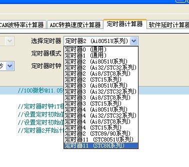

最新版AIappISP定时器计算器和范例程序里没有适合AI8051U的

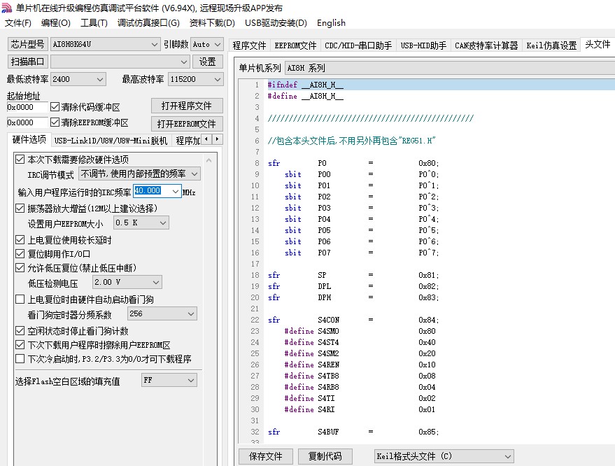

#ifndef __AI8H_H__
#define __AI8H_H__
//包含本头文件后,不用另外再包含"REG51.H"
sfr         P0          =           0x80;
    sbit    P00         =           P0^0;
    sbit    P01         =           P0^1;
    sbit    P02         =           P0^2;
    sbit    P03         =           P0^3;
    sbit    P04         =           P0^4;
    sbit    P05         =           P0^5;
    sbit    P06         =           P0^6;
    sbit    P07         =           P0^7;
sfr         SP          =           0x81;
sfr         DPL         =           0x82;
sfr         DPH         =           0x83;
sfr         S4CON       =           0x84;

//下面这个 8G 的头文件就是 2种风格都有
sfr         T4T3M       =           0xD1;
sfr         T4H         =           0xD2;
sfr         T4L         =           0xD3;
sfr         T3H         =           0xD4;
sfr         T3L         =           0xD5;
sfr         T2H         =           0xD6;
sfr         T2L         =           0xD7;
sfr         T3T4M       =           0xD1;
sfr         TH4         =           0xD2;
sfr         TL4         =           0xD3;
sfr         TH3         =           0xD4;
sfr         TL3         =           0xD5;
sfr         TH2         =           0xD6;
sfr         TL2         =           0xD7;
收到,希望AI8051U的头文件也做相同的更新  发表于 2024-11-10 13:47

sfr         T3T4M       =           0xd1;
sfr         TH4         =           0xd2;
sfr         TL4         =           0xd3;
sfr         TH3         =           0xd4;
sfr         TL3         =           0xd5;
sfr         TH2         =           0xd6;
sfr         TL2         =           0xd7;
sfr         CCON        =           0xd8;
    sbit    CF          =           CCON^7;
    sbit    CR          =           CCON^6;
    sbit    CCF3        =           CCON^3;
    sbit    CCF2        =           CCON^2;
    sbit    CCF1        =           CCON^1;
    sbit    CCF0        =           CCON^0;
sfr         CMOD        =           0xd9;
sfr         CCAPM0      =           0xda;
sfr         CCAPM1      =           0xdb;
sfr         CCAPM2      =           0xdc;
sfr         ADCCFG      =           0xde;
sfr         IP3         =           0xdf;
sfr         ACC         =           0xe0;
sfr         P7M1        =           0xe1;
sfr         P7M0        =           0xe2;
sfr         DPS         =           0xe3;
sfr         DPL1        =           0xe4;
sfr         DPH1        =           0xe5;
sfr         CMPCR1      =           0xe6;
sfr         CMPCR2      =           0xe7;
sfr         P6          =           0xe8;
    sbit    P60         =           P6^0;
    sbit    P61         =           P6^1;
    sbit    P62         =           P6^2;
    sbit    P63         =           P6^3;
    sbit    P64         =           P6^4;
    sbit    P65         =           P6^5;
    sbit    P66         =           P6^6;
    sbit    P67         =           P6^7;
sfr         CL          =           0xe9;
sfr         CCAP0L      =           0xea;
sfr         CCAP1L      =           0xeb;
sfr         CCAP2L      =           0xec;
sfr         IP3H        =           0xee;
sfr         AUXINTIF    =           0xef;
sfr         B           =           0xf0;
sfr         PWMSET      =           0xf1;
sfr         PCA_PWM0    =           0xf2;
sfr         PCA_PWM1    =           0xf3;
sfr         PCA_PWM2    =           0xf4;
sfr         IAP_TPS     =           0xf5;
sfr         PWMCFG      =           0xf6;
sfr         P7          =           0xf8;
    sbit    P70         =           P7^0;
    sbit    P71         =           P7^1;
    sbit    P72         =           P7^2;
    sbit    P73         =           P7^3;
    sbit    P74         =           P7^4;
    sbit    P75         =           P7^5;
    sbit    P76         =           P7^6;
    sbit    P77         =           P7^7;
sfr         CH          =           0xf9;
sfr         CCAP0H      =           0xfa;
sfr         CCAP1H      =           0xfb;
sfr         CCAP2H      =           0xfc;
sfr         RSTCFG      =           0xff;
//如下特殊功能寄存器位于扩展RAM区域
//访问这些寄存器,需先将P_SW2的BIT7设置为1,才可正常读写
//FF00H-FFFFH
#define     PWMC                    (*(unsigned int  volatile xdata *)0xff00)
#define     PWMCH                   (*(unsigned char volatile xdata *)0xff00)
#define     PWMCL                   (*(unsigned char volatile xdata *)0xff01)
#define     PWMCKS                  (*(unsigned char volatile xdata *)0xff02)
#define     PWMTADC                 (*(unsigned int  volatile xdata *)0xff03)
#define     PWMTADCH                (*(unsigned char volatile xdata *)0xff03)
#define     PWMTADCL                (*(unsigned char volatile xdata *)0xff04)
#define     PWMIF                   (*(unsigned char volatile xdata *)0xff05)
#define     PWMFDCR                 (*(unsigned char volatile xdata *)0xff06)
#define     PWMDELSEL               (*(unsigned char volatile xdata *)0xff07)
#define     PWM0T1                  (*(unsigned int  volatile xdata *)0xff10)
#define     PWM0T1H                 (*(unsigned char volatile xdata *)0xff10)
#define     PWM0T1L                 (*(unsigned char volatile xdata *)0xff11)
#define     PWM0T2                  (*(unsigned int  volatile xdata *)0xff12)
#define     PWM0T2H                 (*(unsigned char volatile xdata *)0xff12)
#define     PWM0T2L                 (*(unsigned char volatile xdata *)0xff13)
#define     PWM0CR                  (*(unsigned char volatile xdata *)0xff14)
#define     PWM0HLD                 (*(unsigned char volatile xdata *)0xff15)
#define     PWM1T1                  (*(unsigned int  volatile xdata *)0xff18)
#define     PWM1T1H                 (*(unsigned char volatile xdata *)0xff18)
#define     PWM1T1L                 (*(unsigned char volatile xdata *)0xff19)
#define     PWM1T2                  (*(unsigned int  volatile xdata *)0xff1a)
#define     PWM1T2H                 (*(unsigned char volatile xdata *)0xff1a)
#define     PWM1T2L                 (*(unsigned char volatile xdata *)0xff1b)
#define     PWM1CR                  (*(unsigned char volatile xdata *)0xff1c)
#define     PWM1HLD                 (*(unsigned char volatile xdata *)0xff1d)
#define     PWM2T1                  (*(unsigned int  volatile xdata *)0xff20)
#define     PWM2T1H                 (*(unsigned char volatile xdata *)0xff20)
#define     PWM2T1L                 (*(unsigned char volatile xdata *)0xff21)
#define     PWM2T2                  (*(unsigned int  volatile xdata *)0xff22)
#define     PWM2T2H                 (*(unsigned char volatile xdata *)0xff22)
#define     PWM2T2L                 (*(unsigned char volatile xdata *)0xff23)
#define     PWM2CR                  (*(unsigned char volatile xdata *)0xff24)
#define     PWM2HLD                 (*(unsigned char volatile xdata *)0xff25)
#define     PWM3T1                  (*(unsigned int  volatile xdata *)0xff28)
#define     PWM3T1H                 (*(unsigned char volatile xdata *)0xff28)
#define     PWM3T1L                 (*(unsigned char volatile xdata *)0xff29)
#define     PWM3T2                  (*(unsigned int  volatile xdata *)0xff2a)
#define     PWM3T2H                 (*(unsigned char volatile xdata *)0xff2a)
#define     PWM3T2L                 (*(unsigned char volatile xdata *)0xff2b)
#define     PWM3CR                  (*(unsigned char volatile xdata *)0xff2c)
#define     PWM3HLD                 (*(unsigned char volatile xdata *)0xff2d)
#define     PWM4T1                  (*(unsigned int  volatile xdata *)0xff30)
#define     PWM4T1H                 (*(unsigned char volatile xdata *)0xff30)
#define     PWM4T1L                 (*(unsigned char volatile xdata *)0xff31)
#define     PWM4T2                  (*(unsigned int  volatile xdata *)0xff32)
#define     PWM4T2H                 (*(unsigned char volatile xdata *)0xff32)
#define     PWM4T2L                 (*(unsigned char volatile xdata *)0xff33)
#define     PWM4CR                  (*(unsigned char volatile xdata *)0xff34)
#define     PWM4HLD                 (*(unsigned char volatile xdata *)0xff35)
#define     PWM5T1                  (*(unsigned int  volatile xdata *)0xff38)
#define     PWM5T1H                 (*(unsigned char volatile xdata *)0xff38)
#define     PWM5T1L                 (*(unsigned char volatile xdata *)0xff39)
#define     PWM5T2                  (*(unsigned int  volatile xdata *)0xff3a)
#define     PWM5T2H                 (*(unsigned char volatile xdata *)0xff3a)
#define     PWM5T2L                 (*(unsigned char volatile xdata *)0xff3b)
#define     PWM5CR                  (*(unsigned char volatile xdata *)0xff3c)
#define     PWM5HLD                 (*(unsigned char volatile xdata *)0xff3d)
#define     PWM6T1                  (*(unsigned int  volatile xdata *)0xff40)
#define     PWM6T1H                 (*(unsigned char volatile xdata *)0xff40)
#define     PWM6T1L                 (*(unsigned char volatile xdata *)0xff41)
#define     PWM6T2                  (*(unsigned int  volatile xdata *)0xff42)
#define     PWM6T2H                 (*(unsigned char volatile xdata *)0xff42)
#define     PWM6T2L                 (*(unsigned char volatile xdata *)0xff43)
#define     PWM6CR                  (*(unsigned char volatile xdata *)0xff44)
#define     PWM6HLD                 (*(unsigned char volatile xdata *)0xff45)
#define     PWM7T1                  (*(unsigned int  volatile xdata *)0xff48)
#define     PWM7T1H                 (*(unsigned char volatile xdata *)0xff48)
#define     PWM7T1L                 (*(unsigned char volatile xdata *)0xff49)
#define     PWM7T2                  (*(unsigned int  volatile xdata *)0xff4a)
#define     PWM7T2H                 (*(unsigned char volatile xdata *)0xff4a)
#define     PWM7T2L                 (*(unsigned char volatile xdata *)0xff4b)
#define     PWM7CR                  (*(unsigned char volatile xdata *)0xff4c)
#define     PWM7HLD                 (*(unsigned char volatile xdata *)0xff4d)
//FE00H-FEFFH
#define     CLKSEL                  (*(unsigned char volatile xdata *)0xfe00)
#define     CLKDIV                  (*(unsigned char volatile xdata *)0xfe01)
#define     HIRCCR                  (*(unsigned char volatile xdata *)0xfe02)
#define     XOSCCR                  (*(unsigned char volatile xdata *)0xfe03)
#define     IRC32KCR                (*(unsigned char volatile xdata *)0xfe04)
#define     MCLKOCR                 (*(unsigned char volatile xdata *)0xfe05)
#define     IRCDB                   (*(unsigned char volatile xdata *)0xfe06)
#define     P0PU                    (*(unsigned char volatile xdata *)0xfe10)
#define     P1PU                    (*(unsigned char volatile xdata *)0xfe11)
#define     P2PU                    (*(unsigned char volatile xdata *)0xfe12)
#define     P3PU                    (*(unsigned char volatile xdata *)0xfe13)
#define     P4PU                    (*(unsigned char volatile xdata *)0xfe14)
#define     P5PU                    (*(unsigned char volatile xdata *)0xfe15)
#define     P6PU                    (*(unsigned char volatile xdata *)0xfe16)
#define     P7PU                    (*(unsigned char volatile xdata *)0xfe17)
#define     P0NCS                   (*(unsigned char volatile xdata *)0xfe18)
#define     P1NCS                   (*(unsigned char volatile xdata *)0xfe19)
#define     P2NCS                   (*(unsigned char volatile xdata *)0xfe1a)
#define     P3NCS                   (*(unsigned char volatile xdata *)0xfe1b)
#define     P4NCS                   (*(unsigned char volatile xdata *)0xfe1c)
#define     P5NCS                   (*(unsigned char volatile xdata *)0xfe1d)
#define     P6NCS                   (*(unsigned char volatile xdata *)0xfe1e)
#define     P7NCS                   (*(unsigned char volatile xdata *)0xfe1f)
#define     P0SR                    (*(unsigned char volatile xdata *)0xfe20)
#define     P1SR                    (*(unsigned char volatile xdata *)0xfe21)
#define     P2SR                    (*(unsigned char volatile xdata *)0xfe22)
#define     P3SR                    (*(unsigned char volatile xdata *)0xfe23)
#define     P4SR                    (*(unsigned char volatile xdata *)0xfe24)
#define     P5SR                    (*(unsigned char volatile xdata *)0xfe25)
#define     P6SR                    (*(unsigned char volatile xdata *)0xfe26)
#define     P7SR                    (*(unsigned char volatile xdata *)0xfe27)
#define     P0DR                    (*(unsigned char volatile xdata *)0xfe28)
#define     P1DR                    (*(unsigned char volatile xdata *)0xfe29)
#define     P2DR                    (*(unsigned char volatile xdata *)0xfe2a)
#define     P3DR                    (*(unsigned char volatile xdata *)0xfe2b)
#define     P4DR                    (*(unsigned char volatile xdata *)0xfe2c)
#define     P5DR                    (*(unsigned char volatile xdata *)0xfe2d)
#define     P6DR                    (*(unsigned char volatile xdata *)0xfe2e)
#define     P7DR                    (*(unsigned char volatile xdata *)0xfe2f)
#define     P0IE                    (*(unsigned char volatile xdata *)0xfe30)
#define     P1IE                    (*(unsigned char volatile xdata *)0xfe31)
#define     P2IE                    (*(unsigned char volatile xdata *)0xfe32)
#define     P3IE                    (*(unsigned char volatile xdata *)0xfe33)
#define     P4IE                    (*(unsigned char volatile xdata *)0xfe34)
#define     P5IE                    (*(unsigned char volatile xdata *)0xfe35)
#define     P6IE                    (*(unsigned char volatile xdata *)0xfe36)
#define     P7IE                    (*(unsigned char volatile xdata *)0xfe37)
#define     LCMIFCFG                (*(unsigned char volatile xdata *)0xfe50)
#define     LCMIFCFG2               (*(unsigned char volatile xdata *)0xfe51)
#define     LCMIFCR                 (*(unsigned char volatile xdata *)0xfe52)
#define     LCMIFSTA                (*(unsigned char volatile xdata *)0xfe53)
#define     LCMIFDATL               (*(unsigned char volatile xdata *)0xfe54)
#define     LCMIFDATH               (*(unsigned char volatile xdata *)0xfe55)
#define     I2CCFG                  (*(unsigned char volatile xdata *)0xfe80)
#define     I2CMSCR                 (*(unsigned char volatile xdata *)0xfe81)
#define     I2CMSST                 (*(unsigned char volatile xdata *)0xfe82)
#define     I2CSLCR                 (*(unsigned char volatile xdata *)0xfe83)
#define     I2CSLST                 (*(unsigned char volatile xdata *)0xfe84)
#define     I2CSLADR                (*(unsigned char volatile xdata *)0xfe85)
