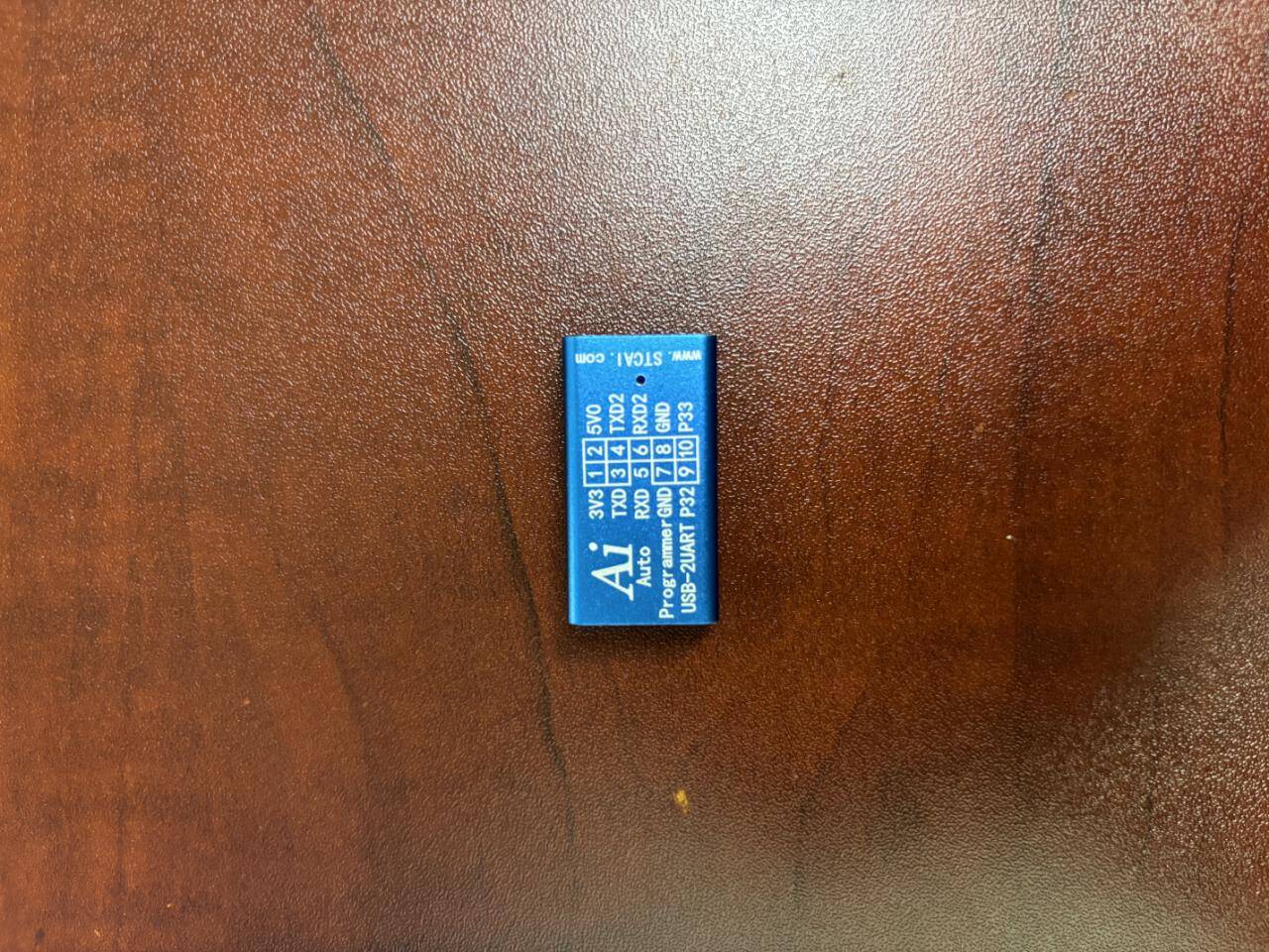

发表于 2024-11-5 06:41:25 | 显示全部楼层
That is looking very nice indeed.
Do you have hardware tests of the fastest UART BAUD speeds without dropping or losing bytes ?
eg a FT232H talking to this, how fast can the link sustain continual TX/RX ?
Can DTR/RTS be enabled to improve highest speeds ?
611
751
751

 楼主| 发表于 2024-11-5 10:32:30 | 显示全部楼层
Do you have hardware tests of the fastest UART BAUD speeds wit ...
Q:
这看起来确实很漂亮。
你们有对最快的UART波特率进行硬件测试,以确保不会出现数据丢失或损坏的情况吗?例如,FT232H与该设备通信时,链接能够持续进行传输和接收的最高速度是多少?
是否可以启用DTR/RTS功能以提高最高传输速度?
A:
最高支持10M波特率
10M波特率发送大文件(一个PDF文件)测试:
https://www.stcaimcu.com/forum.php?mod=viewthread&tid=11607
官方固件无DTR/RTS功能,但一箭双雕开源例程中有(A2、A3),可以修改IO口后重新编译下载实现
https://www.stcaimcu.com/data/download/DemoCode/STC8H8K64U-USB-TO-2-UART.zip
T:
The highest supported baud rate is 10M.
10Mbps transmission of large files (a PDF file) test:
The official firmware does not have DTR/RTS functionality, but there are open-source examples (A2, A3) with this feature that can be modified and recompiled for download to achieve the same result.

发表于 2024-11-7 10:48:14 | 显示全部楼层
CyberH*** 发表于 2024-11-5 10:32
Q:
这看起来确实很漂亮。
你们有对最快的UART波特率进行硬件测试,以确保不会出现数据丢失或损坏的情况吗 ...
Can this board design also support AI8H8K64U-45I-SOP16 ? (Which should allow DMA-UART available on the AI8H8K64U-45I-SOP16)
