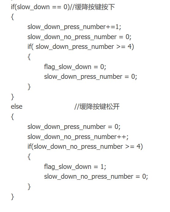

 楼主| 发表于 2024-10-9 08:37:55 | 显示全部楼层
王*** 发表于 2024-10-8 11:56
那你要用标志位给转动和操作分开,不要对电机操作函数做多次重复调用
你现在这样子感觉不像有标志位做限 ...
您好,能麻烦您帮我看看嘛?我希望得到的是按下按键转一圈,转到一圈即使按着按键也不动了,松开按键,回到原点。但是现在实际情况是这样,按着按键转一圈后,不停下 还会缓慢转动,但是释放按键后,回到原点,不在转动,这是怎么回事呢。
#include "STC8Hxxx.h"       //包含此头文件后,不需要再包含"reg51.h"头文件
#include "test.h"
#include        "SineTable-256.h"
#define     MAIN_Fosc       24000000L   //定义主时钟
程序使用
AIN1-P1.1
AIN2-P1.2
BIN1-P1.5
BIN2-P3.4
驱动步进电机
#include "intrins.h"
sfr VRTRIM = 0xA6;
#define CLKSEL (*(unsigned char volatile xdata *)0xfe00)
#define CLKDIV (*(unsigned char volatile xdata *)0xfe01)
//下表为 STC8H1K08-20Pin 的参数列表
#define ID_ROMADDR ((unsigned char code *)0x1ff9)
#define VREF_ROMADDR (*(unsigned int code *)0x1ff7)
#define F32K_ROMADDR (*(unsigned int code *)0x1ff5)
#define T22M_ROMADDR (*(unsigned char code *)0x1ff4) //22.1184MHz
#define T24M_ROMADDR (*(unsigned char code *)0x1ff3) //24MHz
#define T20M_ROMADDR (*(unsigned char code *)0x1ff2) //20MHz
#define T27M_ROMADDR (*(unsigned char code *)0x1ff1) //27MHz
#define T30M_ROMADDR (*(unsigned char code *)0x1ff0) //30MHz
#define T33M_ROMADDR (*(unsigned char code *)0x1fef) //33.1776MHz
#define T35M_ROMADDR (*(unsigned char code *)0x1fee) //35MHz
#define T36M_ROMADDR (*(unsigned char code *)0x1fed) //36.864MHz
#define VRT20M_ROMADDR (*(unsigned char code *)0x1fea) //VRTRIM_20M
#define VRT35M_ROMADDR (*(unsigned char code *)0x1fe9) //VRTRIM_35M
//================== 步进电机相关变量定义 ===================
bit                B_M1_RunEn;                //运行允许
bit                B_M1_RunEnTmp;        //用于检测电机从运行到停止的事件
bit                B_M1_DIR;                //运行方向, 0:顺时针(正转), 1:逆时针(反转)
bit                B_f1_update;        //请求刷新频率值
bit                B_TIMER1_12T;        //定时器1时钟模式
u16                f1_period;                //当前频率对应的周期
u16                f1;                                //当前频率
u16                f1_set;                        //目标频率
u16                f1_step;                //加减速频率变化的步长
u16                M1_UpPulse;                //加(减)速脉冲数
u16                M1_PulseCnt;        //电机运行总脉冲数, 为0则连续运行
u16                M1_DownCnt;                //运行到要减速输出的脉冲数
u8                M1_StepCnt;                //步数计数
u8                M1_devide;                //细分数  1, 2, 4, 8, 16, 32, 64
u8                M1_step;                //步距, M1_step = 64 / M1_devide.
sbit A1F = P1^1;
sbit A2F = P1^2;
sbit B1F = P1^5;
sbit B2F = P3^4;
sbit SLEEP = P1^4;
sbit DECAY = P1^0;
sbit up = P3^2;
sbit down = P3^3;
sbit slow_down = P3^5;
sbit test_flag = P3^6;
sbit nFAULT = P1^3;
bit        B_1ms;        //1ms时隙标志
unsigned int speed;
unsigned char STEP;
unsigned char LOOP;
unsigned int temp;
unsigned int flag_up;
unsigned int flag_down;
unsigned int flag_slow_down;
unsigned int flag_up_N = 1;
unsigned int flag_down_N = 1;
unsigned int flag_slow_down_N = 1;
unsigned char up_press_number;
unsigned char down_press_number;
unsigned char slow_down_press_number;
unsigned char up_no_press_number;
unsigned char down_no_press_number;
unsigned char slow_down_no_press_number;
unsigned char up_locked;
unsigned char down_locked;
unsigned char slow_down_locked;
unsigned int ms_cnt;
unsigned int P_CNT;
unsigned int p_flag = 0;
unsigned int ms_flag;
unsigned int f_pl;//频率
unsigned char pwm_duty;//占空比
unsigned char Flag_jushengState = 0;//进入举升标志位  =1进入举升  =0举升回转结束
unsigned char Flag_xiajiangState = 0;//进入下降标志位  =1进入下降  =0下降回转结束
unsigned char Flag_huanjiangState = 0;//进入缓降标志位  =1进入缓降  =0缓降回转结束
unsigned char Flag_jushengState_N = 0;//进入举升标志位  =1进入举升  =0举升回转结束
unsigned char Flag_xiajiangState_N = 0;//进入下降标志位  =1进入下降  =0下降回转结束
unsigned char Flag_huanjiangState_N = 0;//进入缓降标志位  =1进入缓降  =0缓降回转结束
unsigned char guzhang_number;
unsigned char jusheng_enable = 0;
unsigned char jusheng_back_enable = 0;
unsigned char xiajiang_enable = 0;
unsigned char xiajiang_back_enable = 0;
unsigned char huanjiang_enable = 0;
unsigned char huanjiang_back_enable = 0;
unsigned char DIR;
/*************        本地函数声明        **************/
void delay_ms(unsigned int ms);
void Delay10ms(void);
void Driver();
void fDriver();
void STEP_MOTOR_Driver(unsigned char RL);
void STEP_MOTOR_NUM(unsigned char RL, unsigned int num);
void STEP_MOTOR_LOOP(unsigned char RL,unsigned char LOOP);
void         PWMA_config(void);
u8                Timer1_Config(u8 t, u32 reload);        //t=0: reload值是主时钟周期数,  t=1: reload值是时间(单位us)
u8                Timer0_Config(u8 t, u32 reload);        //t=0: reload值是主时钟周期数,  t=1: reload值是时间(单位us), 返回0正确, 返回1装载值过大错误.
void        UART1_config(u32 brt, u8 timer, u8 io);        // brt: 通信波特率,  timer=2: 波特率使用定时器2, 其它值: 使用Timer1做波特率. io=0: 串口1切换到P3.0 P3.1,  =1: 切换到P3.6 P3.7,  =2: 切换到P1.6 P1.7,  =3: 切换到P4.3 P4.4
void         UART1_PrintString(u8 *puts);
void         UART1_TxByte(u8 dat);                // 串口1发送一个字节
void         RX1_process(void);                        // 串口1处理函数
u16                GetStep(u16 f, u16 f_set);        // 计算速度变化步进长度
void        GetDownPulse(void);                        // 由M1_PulseCnt(总脉冲数) 和 M1_UpPulse(加速脉冲数) 计算开始减速的脉冲数, .
void        LoadTimer1(void);                        // 计算更新频率的时间参数
void        GetFreq1(void);                                // 计算加减速频率
void        StopMotor1(void);                        // 停止运行一个电机
void        RunMotor1(void);                        // 启动运行一个电机
void        LockMotor1(void);                        //电机停止时减小电流锁转子
void main(void)
        P_SW2 |= 0x80;  //扩展寄存器(XFR)访问使能
    //选择 24MHz
        CLKDIV = 0x04;
        IRTRIM = T24M_ROMADDR;
        VRTRIM = VRT20M_ROMADDR;
        IRCBAND = 0x00;
        CLKDIV = 0x00;
        MCLKOCR = 0x04;
        ms_cnt = 0;
        P_CNT = 0;
        ms_flag = 0;
        p_flag = 0;
           P1M1 = 0x08;
        P1M0 = 0xf7;   //设置P1推挽输出         //P1^3设置为高阻输入
    P3M1 = 0x2c;                                           //           0 0 1 0 1 1 0 0
        P3M0 = 0xd3;   //设置P3推挽输出和高阻输入           1 1 0 1 0 0 1 1
        DECAY = 0;
        SLEEP = 1;
    PWMA_config();
        Timer0_Config(0, MAIN_Fosc / 1000);        //t=0: reload值是主时钟周期数,  t=1: reload值是时间(单位us)
        Timer1_Config(1, 20000);                        //t=0: reload值是主时钟周期数,  t=1: reload值是时间(单位us, 这里随便给个值)
        EA = 1;
        B_M1_RunEn    = 0;
        B_M1_RunEnTmp = 0;
        M1_StepCnt = 0;
        M1_devide = 64;                                 //细分数  1, 2, 4, 8, 16, 32, 64
        M1_step = 64 / M1_devide;         //倒数关系.
        while (1)
                if(B_1ms)        //1ms时隙
                        B_1ms = 0;
                        if(B_M1_RunEn)        //加减速处理
                                GetFreq1();
                                if(f1 < 100)
                                        B_M1_RunEn = 0;        //停止
//                        F0 = B_M1_RunEnTmp;
//                        B_M1_RunEnTmp = B_M1_RunEn;
//                        if(F0 && !B_M1_RunEnTmp)        LockMotor1();        //检测到电机停止, 则锁转子, 减小电流
                if((flag_up == 0)&&(flag_down == 1)&&(flag_slow_down == 1)&&(Flag_xiajiangState == 0)&&(Flag_huanjiangState == 0)) //正转
                                Flag_jushengState=1;//进入举升标志位  =1进入举升  =0举升回转结束
                                if(!B_M1_RunEn)         f1 = 200;
                                M1_PulseCnt = 12800;
                                B_M1_DIR = 0;
                                if(P_CNT < 1)
                                        f1_set = 65000;
                                        RunMotor1();
                                        P_CNT++;
                                else if (P_CNT >= 1)
                                        P_CNT = 1;
                else if((flag_up == 1)&&(Flag_jushengState==1)&&(Flag_xiajiangState == 0)&&(Flag_huanjiangState == 0))        //举升松开
                                B_M1_DIR = 1;
                                if(P_CNT == 0)
                                        Flag_jushengState=0;
                                else
                                        if(P_CNT == 0)
                                        else
                                                if(P_CNT>0)
                                                        f1_set = 65000;
                                                        RunMotor1();
                                                        P_CNT --;
                        }//end  else
                else if((flag_down == 0)&&(flag_up == 1)&&(flag_slow_down == 1)&&(Flag_jushengState == 0)&&(Flag_huanjiangState == 0))
                                Flag_xiajiangState=1;//进入下降标志位  =1进入下降  =0下降回转结束
                                B_M1_DIR = 1;
                                if(P_CNT < 1)
                                        f1_set = 65000;
                                        RunMotor1();
                                        P_CNT++;
                                else if(P_CNT >= 1)
                                        P_CNT = 1;
                        }//        end  if(flag_down == 0) //下降
                        //下降松开执行程序
                        else if((flag_down == 1)&&(Flag_xiajiangState==1)&&(Flag_jushengState == 0)&&(Flag_huanjiangState == 0))        //下降松开
                                B_M1_DIR = 0;
                                if(P_CNT == 0)
                                        Flag_xiajiangState=0;;
                                else
                                        if(P_CNT == 0)
                                        else
                                                if(P_CNT>0)
                                                        f1_set = 65000;
                                                        RunMotor1();
                                                        P_CNT --;
                        }//end  else
                                //缓降45°执行程序
                        else if((flag_slow_down == 0)&&(flag_up == 1)&&(flag_down == 1)&&(Flag_jushengState == 0)&&(Flag_xiajiangState == 0))
                                Flag_huanjiangState=1;//进入缓降45°标志位  =1进入缓降45°  =0缓降45°回转结束
                                M1_PulseCnt = 6400;
                                B_M1_DIR = 1;
                                if(P_CNT < 1)
                                        f1_set = 65000;
                                        RunMotor1();
                                           P_CNT++;
                                else if(P_CNT >= 1)
                                        P_CNT = 1;
                        }//        end  if(flag_slow_down == 0) //缓降45°
                        //缓降45°松开执行程序
                        else if((flag_slow_down == 1)&&(Flag_huanjiangState==1)&&(Flag_jushengState == 0)&&(Flag_xiajiangState == 0))        //缓降45°松开
                                M1_PulseCnt = 6400;
                                B_M1_DIR = 0;
                                if(P_CNT == 0)
                                        Flag_huanjiangState=0;
                                else
                                        if(P_CNT == 0)
                                        else
                                                if(P_CNT>0)
                                                        f1_set = 65000;
                                                        RunMotor1();
                                                        P_CNT --;
                                }//end  else
#define        UpTime        100                //加(减)速时间(ms)
u16        GetStep(u16 f, u16 f_set)        //计算速度变化步进长度
        u16        i;
        M1_UpPulse = (u16)((u32)(f + f_set)*UpTime / 2000);        // 理论加速脉冲数
        if(f_set >= f)        f_set = f_set - f;                //计算频率差
        else                        f_set = f - f_set;                //计算频率差
        i = f_set / UpTime;                                // 加(减)速步进
        if(i == 0)        i = 1;        //步进不能为0
        return        i;                        //返回加减速步进值
void        GetDownPulse(void)        // 由M1_PulseCnt(总脉冲数) 和 M1_UpPulse(加速脉冲数) 计算开始减速的脉冲数, .
        u16 pulse;
        if(M1_PulseCnt != 0)        //运行总脉冲数非0才有开始减速脉冲数
                pulse = M1_UpPulse * 2;                //加减速脉冲数之和 = M1_UpPulse * 2
                if(M1_PulseCnt >= pulse)        pulse = M1_UpPulse;                        //脉冲数 >= 加减速脉冲数之和, 则减速脉冲数按理论计算值
                else                                                pulse = M1_PulseCnt / 2;        //脉冲数 <  加减速脉冲数之和, 则平分脉冲
                M1_DownCnt = M1_PulseCnt - pulse;                                                // 电机开始减速需要走过的脉冲数;
void        LoadTimer1(void)        //计算更新频率的时间参数
        if(f1 < 100)        f1 = 90;

请使用这部分代码替换你的按键扫描函数 需要被替换的部分 [attachimg]59252[/attachimg] 原来的代码无法实现一次按下后只触发一次,会造成多次触发。  详情 回复 发表于 2024-10-9 09:03
huatl*** 发表于 2024-10-9 08:37
您好,能麻烦您帮我看看嘛?我希望得到的是按下按键转一圈,转到一圈即使按着按键也不动了,松开按键,回 ...
请使用这部分代码替换你的按键扫描函数
  1. if (slow_down == 0) // 当缓降按键被按下时
  2. {
  3.     slow_down_no_press_number = 0;   // 重置缓降按键未按下的计数器
  4.     if (slow_down_press_number >= 4) // 如果缓降按键连续按下扫描次数达到4次
  5.         flag_slow_down = 0;          // 设置标志位flag_slow_down为0
  6.     else
  7.         slow_down_press_number++; // 否则增加缓降按键按下的计数
  8. }
  9. else // 当缓降按键被松开时
  10. {
  11.     slow_down_press_number = 0;         // 重置缓降按键按下的计数器
  12.     if (slow_down_no_press_number >= 4) // 如果缓降按键连续未按下扫描次数达到4次
  13.         flag_slow_down = 1;             // 设置标志位flag_slow_down为1
  14.     else
  15.         slow_down_no_press_number++; // 否则增加缓降按键未按下的计数
  16. }
需要被替换的部分
105
353
353
 楼主| 发表于 2024-10-9 09:19:13 | 显示全部楼层

 楼主| 发表于 2024-10-9 10:08:30 | 显示全部楼层
王*** 发表于 2024-10-9 09:26
那你就在结束的时候使用
PWMA_ENO = 0x00;
这句话强制停止PWM输出
感觉这一部分有点问题,为什么if执行不了呢
if(P_CNT < 1)
                                        RunMotor1();
                                        P_CNT++;
                                        PWMA_ENO = 0x00;
                                        P_CNT = 1;
你这部分中,PCNT只有第一次等于0的时候进入了一次。 然后就一直卡在下面这个>=1的判断里面循环了,你加在这里肯定是不对的。 你这个逻辑也比较混乱,看不出来你的这些标志位是要干什么的  详情 回复 发表于 2024-10-9 10:17
