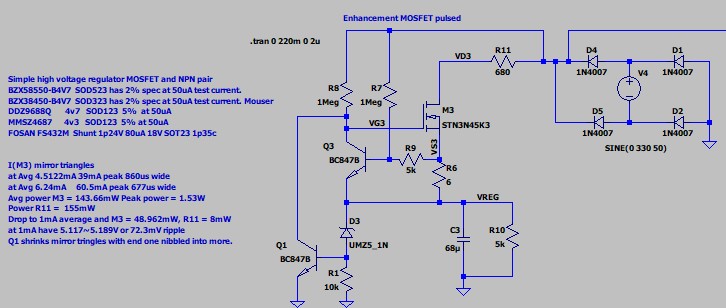

The last side approach is good,I once wanted to use a db 3 to drive a Controllable silicon diode,  ...
Did you mean DK5030 ?
lcsc have those for 4.5c
You can also create a similar part using discretes, tho the placement cost & PCB area could make this less economic.
Here is a spice circuit I trialed for pulsed power AC rectified drive, tested at up to 6.24mA output.
Power loss drops as load current drops.

发表于 2024-9-11 07:45:53 | 显示全部楼层
This circuit diagram is so complicated that I can't understand it.

发表于 2024-9-11 17:47:42 | 显示全部楼层
功夫不负有心人,我找到一款dcdc集成电路,正好有输出5V-300ma模式。片子表价0.2,加上外围,不到5毛钱。分享给各位大佬。它是SM6035。

发表于 2024-9-12 08:12:12 | 显示全部楼层
dcdc集成电路要注意开机过冲。
