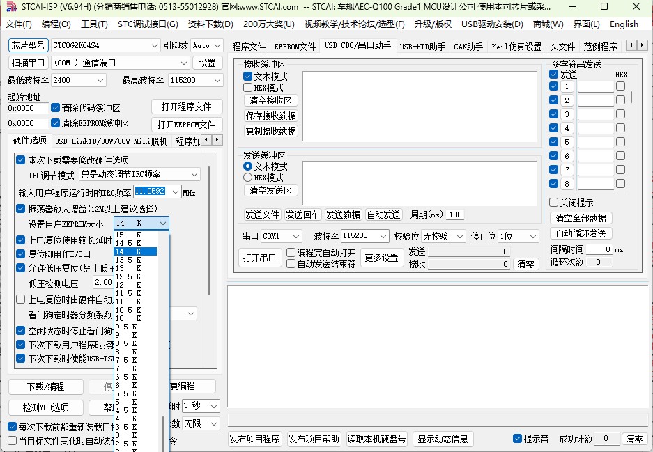

用STC8G2K64S4, 我的这个HEX文件50K,那EEPROM还能怎么设置?我设置过很多选项,存储后的数据都变了

absacc.h是个好东西
没注释掉的Iap_Read_Byte效率比注释掉的Iap_Read_Byte效率高些
读EEPROM
IAP寄存器访问的是相对地址,首地址为0
MOVC访问的是绝对地址,EEPROM从后向前规划,首地址由STCISP决定(可自定义EEPROM大小的型号
#include <absacc.h>
#define                IAP_OFFSET        0x2000        //EEPROM首地址(STC8G1K08A)
void Iap_Idle(void)
        IAP_CONTR&=~IAPEN;
        IAP_CMD=IAP_IDL;
        IAP_TRIG=0x00;
        IAP_ADDRH=0x80;
        IAP_ADDRL=0x00;
unsigned char Iap_Read_Byte(unsigned char sector,unsigned int addr)
        return *(CBYTE+IAP_OFFSET+sector*0x0200+addr);

void Iap_Program_Byte(unsigned char sector,unsigned int addr,unsigned char dat)
        unsigned int add;
        add=sector*0x0200+addr;
        IAP_CONTR|=IAPEN;
        IAP_TPS=IAP_TPS_;
        IAP_CMD=IAP_WRITE;
        IAP_ADDRL=add;
        IAP_ADDRH=add>>8;
        IAP_DATA=dat;
        IAP_TRIG=0x5A;
        IAP_TRIG=0xA5;
        _nop_();
        Iap_Idle();
void Iap_Erase_Sector(unsigned char sector)
        unsigned int add;
        add=sector*0x0200;
        IAP_CONTR|=IAPEN;
        IAP_TPS=IAP_TPS_;
        IAP_CMD=IAP_ERASE;
        IAP_ADDRL=add;
        IAP_ADDRH=add>>8;
        IAP_TRIG=0x5A;
        IAP_TRIG=0xA5;
        _nop_();
        Iap_Idle();

程序空间和EEPROM空间划分可以在下载软件上选你要的分配方式
