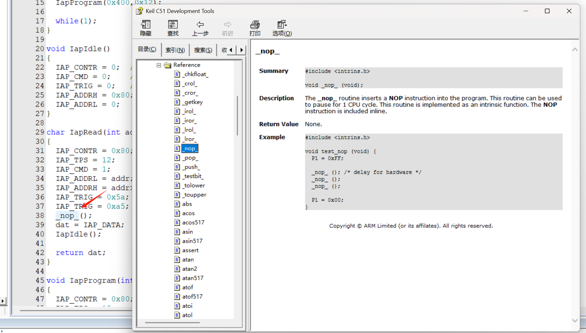

  31.         IAP_TPS = 12;                      //设置等待参数12MHz
  32.         IAP_CMD = 1;                            //设置IAP读命令
  33.         IAP_ADDRL = addr;                  //设置IAP低地址
  34.         IAP_ADDRH = addr>>8;  //设置IAP高地址
  35.         IAP_TRIG = 0x5a;                   //写触发寄命令 0x5a
  36.         IAP_TRIG = 0xa5;                   //写触发寄命令 0xa5
  37.         _nop_();
  38.         dat = IAP_DATA;                                //读IAP数据
  39.         IapIdle();                                                //关闭IAP功能
  40.
  41.         return dat;
  42. }
  43. void IapProgram(int addr, char dat)
  44. {
  45.         IAP_CONTR = 0x80;                  //使能IAP
  46.         IAP_TPS = 12;                      //设置等待参数12MHz
  47.         IAP_CMD = 2;                            //设置IAP读命令
  48.         IAP_ADDRL = addr;                  //设置IAP低地址
  49.         IAP_ADDRH = addr>>8;  //设置IAP高地址
  50.         IAP_DATA = dat;       //写IAP数据
  51.         IAP_TRIG = 0x5a;                   //写触发寄命令 0x5a
  52.         IAP_TRIG = 0xa5;                   //写触发寄命令 0xa5
  53.         _nop_();
  54.         dat = IAP_DATA;                                //读IAP数据
  55.         IapIdle();                                                //关闭IAP功能
  56. }
  57. void IapErase(int addr)
  58. {
  59.         IAP_CONTR = 0x80;                    //使能IAP
  60.         IAP_TPS = 12;                      //设置等待参数12MHz
  61.         IAP_CMD = 3;                            //设置IAP读命令
  62.         IAP_ADDRL = addr;                  //设置IAP低地址
  63.         IAP_ADDRH = addr>>8;  //设置IAP高地址
  64.         IAP_TRIG = 0x5a;                   //写触发寄命令 0x5a
  65.         IAP_TRIG = 0xa5;                   //写触发寄命令 0xa5
  66.         _nop_();
  67.         IapIdle();                                                //关闭IAP功能
  68. }
  69.
擦除dataread
Ctrl+F1查看手册
P21闪烁.mp4
