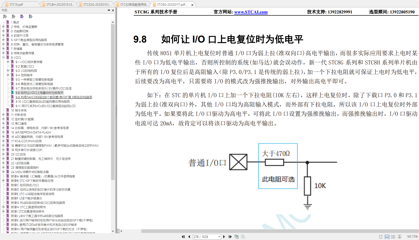

Hey
After power on, the ports are high.
How to have a low level when the power is turned on on the ports?

100K ----GND

Set the port register (e.g. P0)to 0 at first, and then initialize the port mode registers (e.g. P0M0 and P0M1) when power on initial
like this:
P0 = 0x00;
P0M0 = 0x00;
P0M1 = 0x00;
