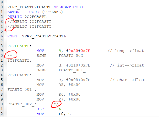

 楼主| 发表于 2024-6-2 06:09:05 | 显示全部楼层
把 FCASTL 文件中, 注释(红圈内容)去掉,再编译成库,试试。
?PR?_FCASTL?FCASTL SEGMENT CODE
EXTRN    CODE (?C?LNEG)
PUBLIC ?C?FCASTL
PUBLIC ?C?FCASTI
PUBLIC ?C?FCASTC
RSEG  ?PR?_FCASTL?FCASTL
?C?FCASTL:
                    MOV      B, #0x20+0x7E       // long-->float
                    SJMP     FCASTC_002_
?C?FCASTI:
                    MOV      B, #0x10+0x7E        // int-->float
                SJMP     FCASTC_001_
?C?FCASTC:
                    MOV      B, #0x08+0x7E        // char-->float
                    MOV      R5, #0x00
FCASTC_001_:
                    MOV      R6, #0x00
                MOV      R7, #0x00
FCASTC_002_:
                    RLC      A
                MOV      F0, C
                JNB      F0, FCASTC_003_
                LCALL    ?C?LNEG
FCASTC_003_:
