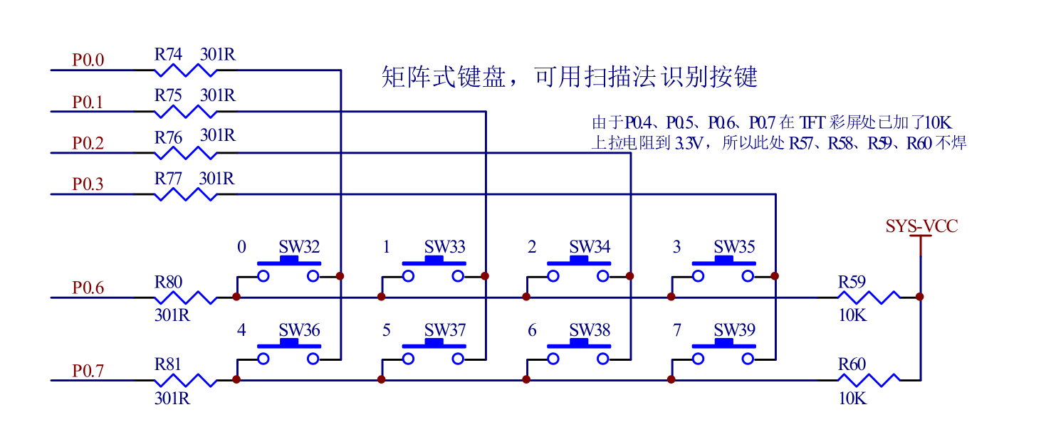

void IO_KeyScan(void)    //50ms call
    u8  j;
    j = IO_KeyState1;   //保存上一次状态
    P0 = 0xf0;  //X低,读Y
    IO_KeyDelay();
    IO_KeyState1 = P0 & 0xf0;
    P0 = 0x0f;  //Y低,读X
    IO_KeyDelay();
    IO_KeyState1 |= (P0 & 0x0f);
    IO_KeyState1 ^= 0xff;   //取反
    if(j == IO_KeyState1)   //连续两次读相等
        j = IO_KeyState;
        IO_KeyState = IO_KeyState1;
        if(IO_KeyState != 0)    //有键按下
            F0 = 0;
            if(j == 0)  F0 = 1; //第一次按下
            else if(j == IO_KeyState)
                if(++IO_KeyHoldCnt >= 20)   //1秒后重键
                    IO_KeyHoldCnt = 18;
                    F0 = 1;
            if(F0) // 只处理一次
                j = T_KeyTable[IO_KeyState >> 4];
                if((j != 0) && (T_KeyTable[IO_KeyState& 0x0f] != 0))
                    KeyCode = (j - 1) * 4 + T_KeyTable[IO_KeyState & 0x0f] + 16;    //计算键码,17~32
        else    IO_KeyHoldCnt = 0;
    P0 = 0xff;

发表于 2024-5-5 16:08:27 | 显示全部楼层
电路图如下:
