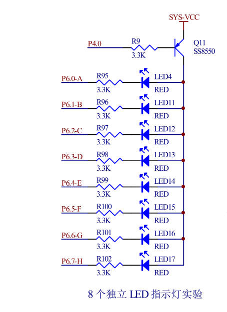

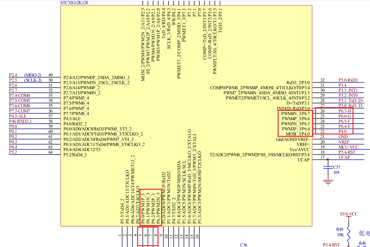

原理图:
例子分析:
    EAXFR = 1; //扩展寄存器(XFR)访问使能
    CKCON = 0; //提高访问XRAM速度
    P0M1 = 0x30;   P0M0 = 0x30;   //设置P0.4、P0.5为漏极开路(实验箱加了上拉电阻到3.3V)
    P1M1 = 0x30;   P1M0 = 0x30;   //设置P1.4、P1.5为漏极开路(实验箱加了上拉电阻到3.3V)
    P2M1 = 0x3c;   P2M0 = 0x3c;   //设置P2.2~P2.5为漏极开路(实验箱加了上拉电阻到3.3V)
    P3M1 = 0x50;   P3M0 = 0x50;   //设置P3.4、P3.6为漏极开路(实验箱加了上拉电阻到3.3V)
    P4M1 = 0x3c;   P4M0 = 0x3c;   //设置P4.2~P4.5为漏极开路(实验箱加了上拉电阻到3.3V)
    P5M1 = 0x0c;   P5M0 = 0x0c;   //设置P5.2、P5.3为漏极开路(实验箱加了上拉电阻到3.3V)
    P6M1 = 0x00;   P6M0 = 0xff;   //设置为推挽输出
    P40 = 0;                //LED Power On
    while(1)
        P60 = 0;                //LED On
        delay_ms(250);
        P60 = 1;                //LED Off
        P61 = 0;                //LED On
        delay_ms(250);
        P61 = 1;                //LED Off
        P62 = 0;                //LED On
        delay_ms(250);
        P62 = 1;                //LED Off
        P63 = 0;                //LED On
        delay_ms(250);
        P63 = 1;                //LED Off
        P64 = 0;                //LED On
        delay_ms(250);
        P64 = 1;                //LED Off
        P65 = 0;                //LED On
        delay_ms(250);
        P65 = 1;                //LED Off
        P66 = 0;                //LED On
        delay_ms(250);
        P66 = 1;                //LED Off
        P67 = 0;                //LED On
        delay_ms(250);
        P67 = 1;                //LED Off
