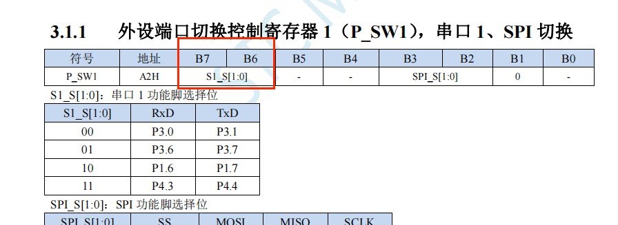

修改后可用的STC32F12的UART2复用初始化函数:
// 函数: UART2_config(u8 s2_sw)
// 描述: UART2初始化函数, 参数对应为S2_S选项
// 版本: VER1.0
// 日期: 2024-2-4
// 备注:
#define S2_SW_P10_P11 0
#define S2_SW_P46_P47 1
void UART2_config(u8 s2_sw)
  if (0 == s2_sw) {
    P1NCS = 0x00; P1IE = 0xff;
    P1M0 = 0x00; P1M1 = 0x00;
    P1PU = 0x02;
    S2_S = 0;         //UART2/USART2: RxD2(P1.0), TxD2(P1.1)
  } else {  // treat as (1 == s2_sw)
    P4NCS = 0x00; P4IE = 0xff;
    P4M0 = 0x00; P4M1 = 0x00;
    P4PU = 0x80;
    S2_S = 1;     //UART2/USART2: RxD2_2(P4.6), TxD2_2(P4.7)
  NOP(32);
  S2CFG = 0x01;     //W1 = 1;
        S2CON = 0x50;                  //8位数据,可变波特率
        AUXR |= 0x04;                  //定时器时钟1T模式
        T2L = 0xD0;                          //设置定时初始值
        T2H = 0xFF;                          //设置定时初始值
        AUXR |= 0x10;                  //定时器2开始计时
  ES2  = 1;
  B_TX2_Busy = 0;
  TX2_Cnt = 0;
  RX2_Cnt = 0;
