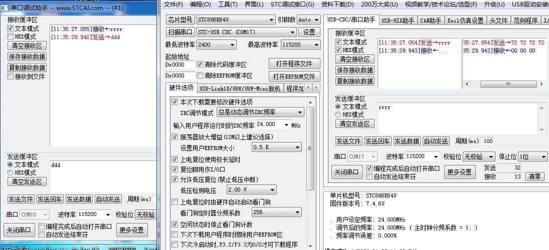

发表于 2024-1-29 11:39:34 | 显示全部楼层
uart.c修改后的代码如下,但仍然尚未正常。
  1. #include "stc.h"
  2. #include "uart.h"
  3. #include "usb.h"
  4. #include "util.h"
  5. #include "usb_req_class.h"
  6. BOOL UartBusy;
  7. void uart_init()
  8. {
  9.     P_SW1 |= 0x40;
  10.     P3M0 = 0x00; // P3.6,P3.7设置为准双向模式
  11.     P3M1 = 0x00;
  12.     AUXR |= 0x14; // 定时器2时钟1T模式,开始计时
  13.     IE2 |= 1;     // 允许中断
  14.     SCON = 0x50;  // 8位数据,可变波特率
  15.     AUXR |= 0x01; // 串口1选择定时器2为波特率发生器
  16.     AUXR |= 0x04; // 定时器时钟1T模式
  17.     T2L = BR(115200);
  18.     T2H = BR(115200) >> 8;
  19.     AUXR |= 0x10; // 定时器2开始计时
  20.     ES = 1;
  21.     LineCoding.dwDTERate = REV4(115200);
  22.     LineCoding.bCharFormat = 0;
  23.     LineCoding.bParityType = 0;
  24.     LineCoding.bDataBits = 8;
  25. }
  26. void uart1_isr() interrupt 4
  27. {
  28.     if (TI) // 检测串口1发送中断
  29.     {
  30.         TI = 0; // 清除串口1发送中断请求位
  31.         UartBusy = 0;
  32.     }
  33.     if (RI) // 检测串口1接收中断
  34.     {
  35.         RI = 0; // 清除串口1接收中断请求位
  36.         TxBuffer[TxWptr++] = S2BUF;
  37.     }
  38. }
  39. void uart_set_parity(BYTE parity)
  40. {
  41.     switch (parity)
  42.     {
  43.     case NONE_PARITY:
  44.         SCON = 0x50;
  45.         break;
  46.     case ODD_PARITY:
  47.     case EVEN_PARITY:
  48.     case MARK_PARITY:
  49.         SCON = 0xda;
  50.         break;
  51.     case SPACE_PARITY:
  52.         SCON = 0xd2;
  53.         break;
  54.     }
  55. }
  56. void uart_set_baud(DWORD baud)
  57. {
  58.     WORD temp;
  59.     temp = (WORD)BR(baud);
  60.     T2L = temp;
  61.     T2H = temp >> 8;
  62. }
  63. void uart_polling()
  64. {
  65.     BYTE dat;
  66.     BYTE cnt;
  67.     if (DeviceState != DEVSTATE_CONFIGURED)
  68.         return;
  69.     if (!UsbInBusy && (TxRptr != TxWptr))
  70.     {
  71.         IE2 &= ~0x80; // EUSB = 0;
  72.         UsbInBusy = 1;
  73.         usb_write_reg(INDEX, 1);
  74.         cnt = 0;
  75.         while (TxRptr != TxWptr)
  76.         {
  77.             usb_write_reg(FIFO1, TxBuffer[TxRptr++]);
  78.             cnt++;
  79.             if (cnt == EP1IN_SIZE)
  80.                 break;
  81.         }
  82.         usb_write_reg(INCSR1, INIPRDY);
  83.         IE2 |= 0x80; // EUSB = 1;
  84.     }
  85.     if (!UartBusy && (RxRptr != RxWptr))
  86.     {
  87.         dat = RxBuffer[RxRptr++];
  88.         UartBusy = 1;
  89.         switch (LineCoding.bParityType)
  90.         {
  91.         case NONE_PARITY:
  92.         case SPACE_PARITY:
  93.             SCON &= ~0x08; // STB8 = 0;
  94.             break;
  95.         case ODD_PARITY:
  96.             ACC = dat;
  97.             if (P)
  98.                 SCON &= ~0x08; // STB8 = !P;
  99.             else
  100.                 SCON |= 0x08;
  101.             break;
  102.         case EVEN_PARITY:
  103.             ACC = dat;
  104.             if (P)
  105.                 SCON |= 0x08; // STB8 = P;
  106.             else
  107.                 SCON &= ~0x08;
  108.             break;
  109.         case MARK_PARITY:
  110.             SCON |= 0x08; // STB8 = 1;
  111.             break;
  112.         }
  113.         SBUF = dat;
  114.         while (UartBusy)
  115.             ;
  116.     }
  117.     if (UsbOutBusy)
  118.     {
  119.         IE2 &= ~0x80; // EUSB = 0;
  120.         if (RxWptr - RxRptr < 256 - EP1OUT_SIZE)
  121.         {
  122.             UsbOutBusy = 0;
  123.             usb_write_reg(INDEX, 1);
  124.             usb_write_reg(OUTCSR1, 0);
  125.         }
  126.         IE2 |= 0x80; // EUSB = 1;
  127.     }
  128. }
现在的问题是这样的:从CDC发送出去的数据正常,但从另一个串口向USB-CDC发送数据,CDC接收不正常,只显示几个00,不知道需要再修改哪个地方。
  • 打卡总天数:813
  • 最近打卡:2026-03-06 07:51:35
126
2074
4631
4631
发表于 2024-1-29 11:45:51 | 显示全部楼层
哦,发现问题了,改好了改好了。
