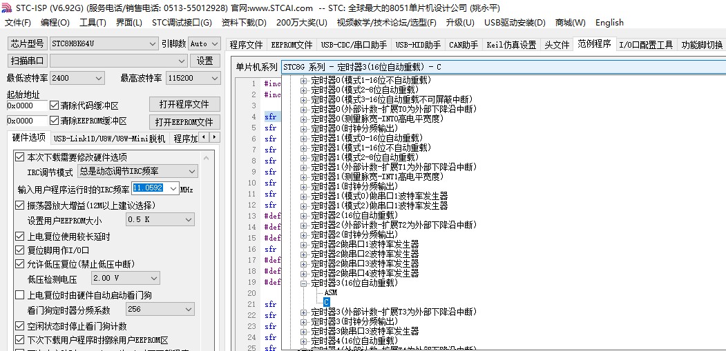

    IE2 = ET3;    //使能定时器中断
ET3不是IE2的一个位吗?怎么可以这样直接赋值???

发表于 2023-11-28 09:29:58 | 显示全部楼层
//看到你贴的图了:
#include "reg51.h"
#include "intrins.h"
sfr     T4T3M   =   0xd1;
sfr     T4L     =   0xd3;
sfr     T4H     =   0xd2;
sfr     T3L     =   0xd5;
sfr     T3H     =   0xd4;
sfr     T2L     =   0xd7;
sfr     T2H     =   0xd6;
sfr     AUXR    =   0x8e;
sfr     IE2     =   0xaf;
#define ET2         0x04
#define ET3         0x20
#define ET4         0x40
sfr     AUXINTIF =  0xef;
#define T2IF        0x01
#define T3IF        0x02
#define T4IF        0x04
sfr     P1M1    =   0x91;
sfr     P1M0    =   0x92;
sfr     P0M1    =   0x93;
sfr     P0M0    =   0x94;
sfr     P2M1    =   0x95;
sfr     P2M0    =   0x96;
sfr     P3M1    =   0xb1;
sfr     P3M0    =   0xb2;
sfr     P4M1    =   0xb3;
sfr     P4M0    =   0xb4;
sfr     P5M1    =   0xc9;
sfr     P5M0    =   0xca;
sbit    P10     =   P1^0;
void TM3_Isr() interrupt 19
    P10 = !P10;                                 //测试端口
void main()
    P0M0 = 0x00;
    P0M1 = 0x00;
    P1M0 = 0x00;
    P1M1 = 0x00;
    P2M0 = 0x00;
    P2M1 = 0x00;
    P3M0 = 0x00;
    P3M1 = 0x00;
    P4M0 = 0x00;
    P4M1 = 0x00;
    P5M0 = 0x00;
    P5M1 = 0x00;
    T3L = 0x66;                                 //65536-11.0592M/12/1000
    T3H = 0xfc;
    T4T3M = 0x08;                               //启动定时器
    EA = 1;
    while (1);

#define ET2         0x04

发表于 2023-11-28 10:15:06 | 显示全部楼层
神*** 发表于 2023-11-28 09:33
#define ET2         0x04
是ET3值等于0x20,把IE2的位5置1,不是ET2
