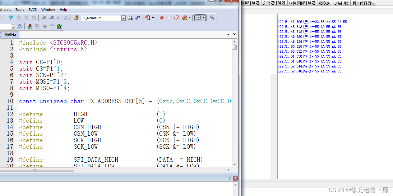

2.4G无线模块常用于无线鼠标键盘,遥控等场合。MCU和2.4G模块通过4线SPI通讯。本测采用XN297 2.4g模块原理图见下图:
XN297 四线SPI读写寄存器测试
  1. #include <STC89C5xRC.H>
  2. #include <intrins.h>
  3. sbit CE=P1^0;
  4. sbit CS=P1^1;
  5. sbit SCK=P1^2;
  6. sbit MOSI=P1^3;
  7. sbit MISO=P1^4;
  8. const unsigned char TX_ADDRESS_DEF[5] = {0xcc,0xCC,0xCC,0xCC,0xCC};                    //RF 地址:接收端和发送端需一致
  9. #define         HIGH                    (1)
  10. #define         LOW                     (0)
  11. #define         CSN_HIGH                (CSN |= HIGH)
  12. #define         CSN_LOW                 (CSN &= LOW)
  13. #define         SCK_HIGH                (SCK |= HIGH)
  14. #define         SCK_LOW                 (SCK &= LOW)
  15. #define         SPI_DATA_HIGH           (DATA |= HIGH)
  16. #define         SPI_DATA_LOW            (DATA &= LOW)
  17. #define         SPI_DATA_STATUS         (DATA)
  18. #define         SPI_DATA_OUTPUT_MODE     ;
  19. #define         SPI_DATA_INPUT_MODE      ;
  20. #define         CE_HIGH                  RF_WriteReg(CE_FSPI_ON, 0)
  21. #define         CE_LOW                   RF_WriteReg(CE_FSPI_OFF, 0)
  22. /********************SPI  REGISTER  ********************/
  23. #define                R_REGISTER                        0x00                            //SPI read RF data
  24. #define                W_REGISTER                        0x20                            //SPI write RF data
  25. #define                R_RX_PAYLOAD                        0x61                            //Read RX Payload
  26. #define                W_TX_PAYLOAD                        0xA0                            //Write TX Payload
  27. #define                FLUSH_TX                        0xE1                            //Flush RX FIFO
  28. #define                FLUSH_RX                        0xE2                            //Flush TX FIFO
  29. #define                REUSE_TX_PL                        0xE3                            //Reuse TX Payload
  30. #define                ACTIVATE                        0x50                            //ACTIVATE
  31. #define                DEACTIVATE                        0x50                            //DEACTIVATE
  32. #define                R_RX_PL_WID                        0x60                            //Read width of RX data
  33. #define                W_ACK_PAYLOAD                        0xA8                            //Data with ACK
  34. #define                W_TX_PAYLOAD_NOACK                0xB0                            //TX Payload no ACK Request
  35. #define                CE_FSPI_ON                        0xFD                            // CE HIGH
  36. #define                CE_FSPI_OFF                        0xFC                            // CE LOW
  37. #define                RST_FSPI                        0x53                            // RESET
  38. #define                NOP_N                                0xFF

主要用于测试的函数是:
unsigned char XN297_Check(void)
    unsigned char check_in_buf[5]={0x55,0xaa,0x55,0xaa,0x55};
    unsigned char check_out_buf[5]={0x00};
    unsigned char i;
    //CE_HIGH;
    RF_WriteBuf(W_REGISTER+TX_ADDR,check_in_buf,5);
    RF_ReadBuf(R_REGISTER+TX_ADDR,check_out_buf,5);
    for(i=0;i<5;i++)
        Sentdata(check_out_buf);
    if((check_out_buf[0]==0x55)&&\
        (check_out_buf[1]==0xaa)&&\
        (check_out_buf[1]==0x55)&&\
        (check_out_buf[1]==0x55))
        return 0;
    else
        return 1;
  就是向TX_ADDR寄存器写入0x55,0xaa,0x55,0xaa,0x55,然后通过RF_ReadBuf(R_REGISTER+TX_ADDR,check_out_buf,5)读出来保存到check_out_buf并发送给串口,通过串口助手得到:
可以证明2.4g模块寄存器工作正常,访问正常。
