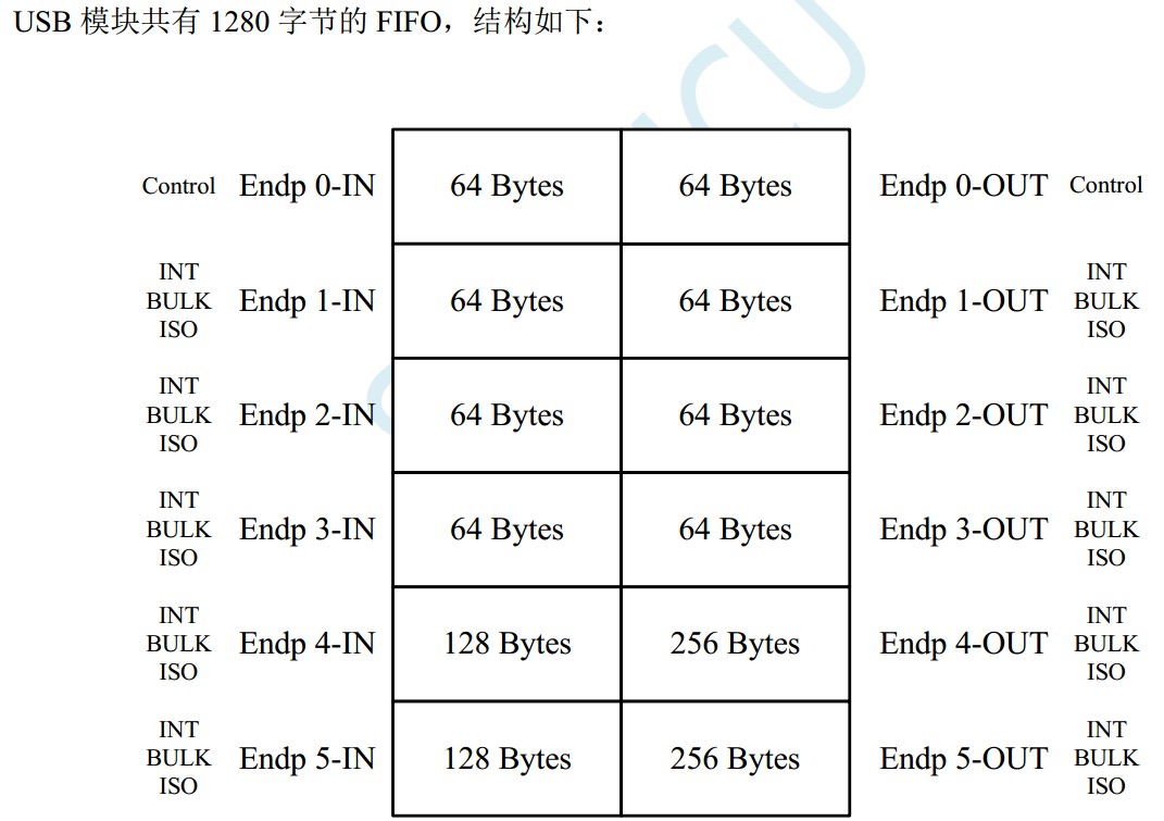

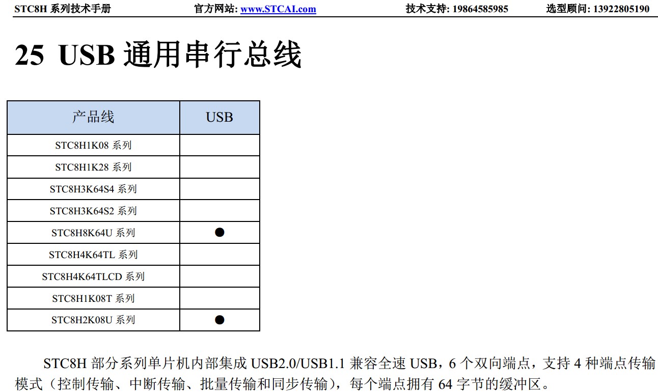

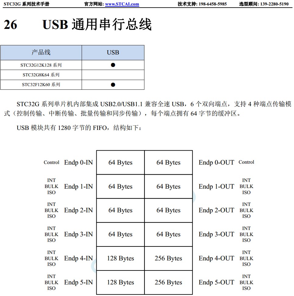

USB2.0
==2000年4月27日由USB-IF组织提出了USB2.0总线协议规范
==具备480MBit/S的高速传输速率,向下兼容低速1.5MBit/S和全速12MBit/S
==传输线缆最大度度5m
==对外提供供电电压为5V,最大电流500mA
==通过HUB级联的方式,一个USB接口理论上可以扩展127个USB设备
==支持 4种传输方式:控制传输、中断传输、同步传输和块传输。
STC 目前是 USB2.0-12Mbit/S及1.5MBit/S
D/S

发表于 2023-10-26 14:01:00 | 显示全部楼层
STC is currently USB2.0-12Mbit/S and 1.5MBit/S
What is sustained supported speed of STC parts, running real software  ?
ie how close to the USB hardware limit of about 10 megabits/sec average user data flows, can STC8H achieve ?
Any plans for faster USB in STC ?
I see WCH have HS-USB (480Mbps) in TSSOP20 microcontrollers.
