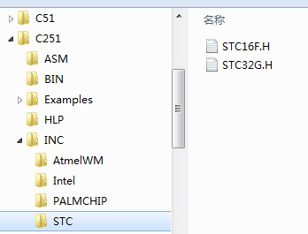

直接打开头文件“STC32G.H”就可以看见全部定义,比如:
//7E:FE00H-7E:FEFFH
#define     CLKSEL                  (*(unsigned char volatile far *)0x7efe00)
#define     CLKDIV                  (*(unsigned char volatile far *)0x7efe01)
#define     HIRCCR                  (*(unsigned char volatile far *)0x7efe02)
#define     XOSCCR                  (*(unsigned char volatile far *)0x7efe03)
#define     IRC32KCR                (*(unsigned char volatile far *)0x7efe04)
#define     MCLKOCR                 (*(unsigned char volatile far *)0x7efe05)
#define     IRCDB                   (*(unsigned char volatile far *)0x7efe06)
#define     IRC48MCR                (*(unsigned char volatile far *)0x7efe07)
#define     X32KCR                  (*(unsigned char volatile far *)0x7efe08)
#define     IRC48ATRIM              (*(unsigned char volatile far *)0x7efe09)
#define     IRC48BTRIM              (*(unsigned char volatile far *)0x7efe0a)
#define     HSCLKDIV                (*(unsigned char volatile far *)0x7efe0b)
#define     P0PU                    (*(unsigned char volatile far *)0x7efe10)
该头文件位于Keil的C251目录下:
