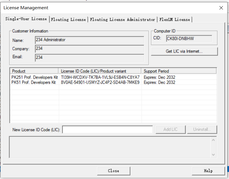

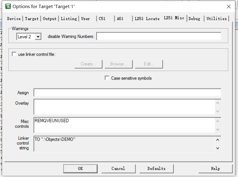

发表于 2024-11-1 20:06:39 | 显示全部楼层
第一集 STC8H编译时提升错误:LX51 LINKER/LOCATER V4.66.30.0 - SN: K1DZC-PIGMVC
COPYRIGHT ARM Germany GmbH 1995 - 2014
@.\Objects\DEMO.lnp ".\Objects\man.obj",
".\stc_usb_cdc_8h_xdata.LIB"
TO ".\Objects\DEMO"
PRINT(".\Listings\DEMO.map") REMQVEUNUSED
*** ERROR L204: INVALID KEYWORD
    POS: 117
    h_xdata.LIB TO .\Objects\DEMO PRINT (.\Listings\DEMO.map) REMQVEUNUSED
Target not created.
Build Time Elapsed:  00:00:00
删除REMQVEUNUSED后可以编译,有40个警告:".\Objects\DEMO" - 0 Error(s), 40 Warning(s).
