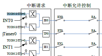

我现在的想法是用tim定时器的外部输入做计数源,我用的是AB线的,想知道正反,所以能不能在计数器在用作外部触发做计数源的时候还能触发上升沿中断这样的

but my encoder triggers at about 3kHz,
Do you need to count every edge, or are you ok with one count every 4 edges ?
If one count every 4 edges is ok, you can edge interrupt on one Quad line, and check the other line for direction information.
If you need to count every edge, it looks like INT0 and INT1 can react to both edges, so using two interrupts enabled for both edges (_/= and =\_ ) interrupts can use a table or state engine to react on every edge.
So can the counter be triggered to rise when it is used as an external trigger as the counting source?
You need UP/DOWN for a quad encoder, and the STC8 timers are all UP only, so a software counter is needed, the hardware counters cannot be used.
