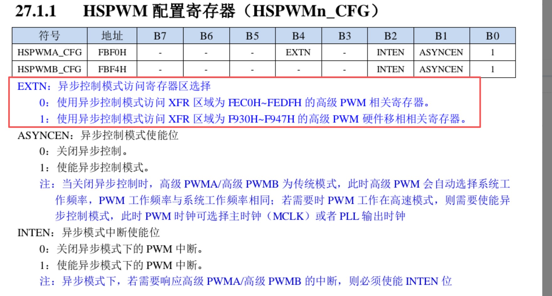

[attachimg]123207[/attachimg] 需要HSPWMA_CFG = 0x13;  详情 回复 发表于 2025-12-4 09:43
