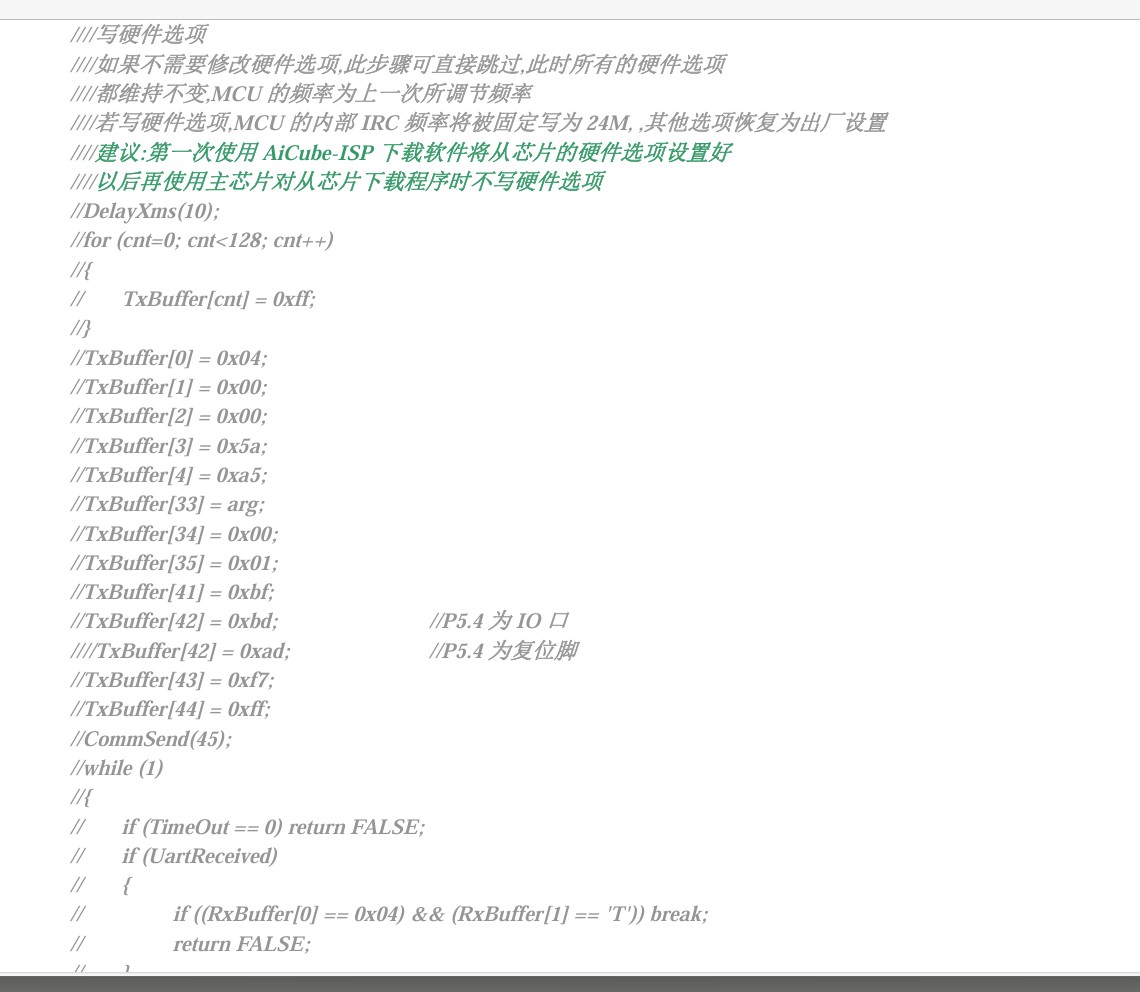

如题
我发送的报文和STC回复的报文:
  1. STCISP PKTDUMP: 46 B9 6A 00 33 04 00 00 5A A5 FF FF FF FF FF FF FF FF FF FF FF FF FF FF FF FF FF FF FF FF FF FF FF FF FF FF FF FF FF 00 01 FF FF FF FF FF BF AF F7 FF 26 E3 16
  2. STCISP PKTDUMP: 46 B9 68 00 08 04 54 00 C8 16

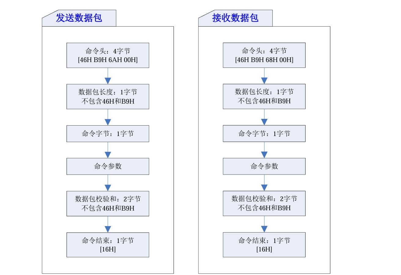

发表于 2025-12-1 23:10:46 | 显示全部楼层
示例里面的命令字是04,这里的04在33后面,所以不正常

 楼主| 发表于 2025-12-2 10:47:47 | 显示全部楼层

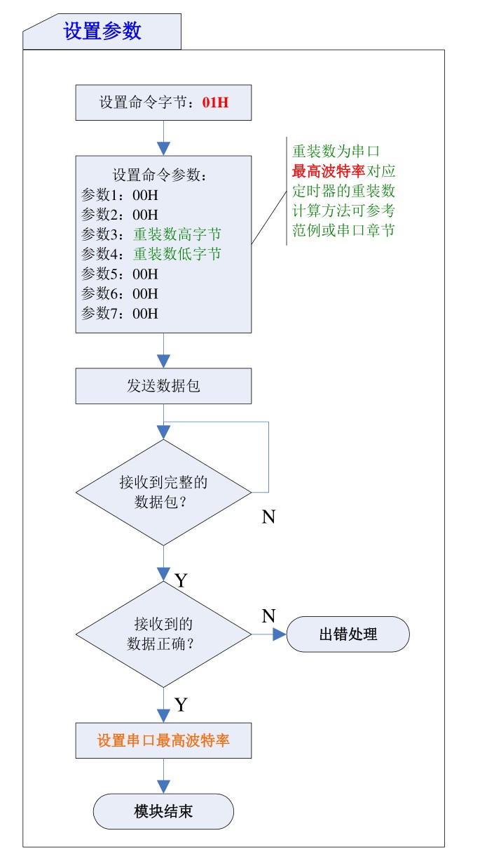

@王 报文头后面到底是跟长度还是跟指令?
