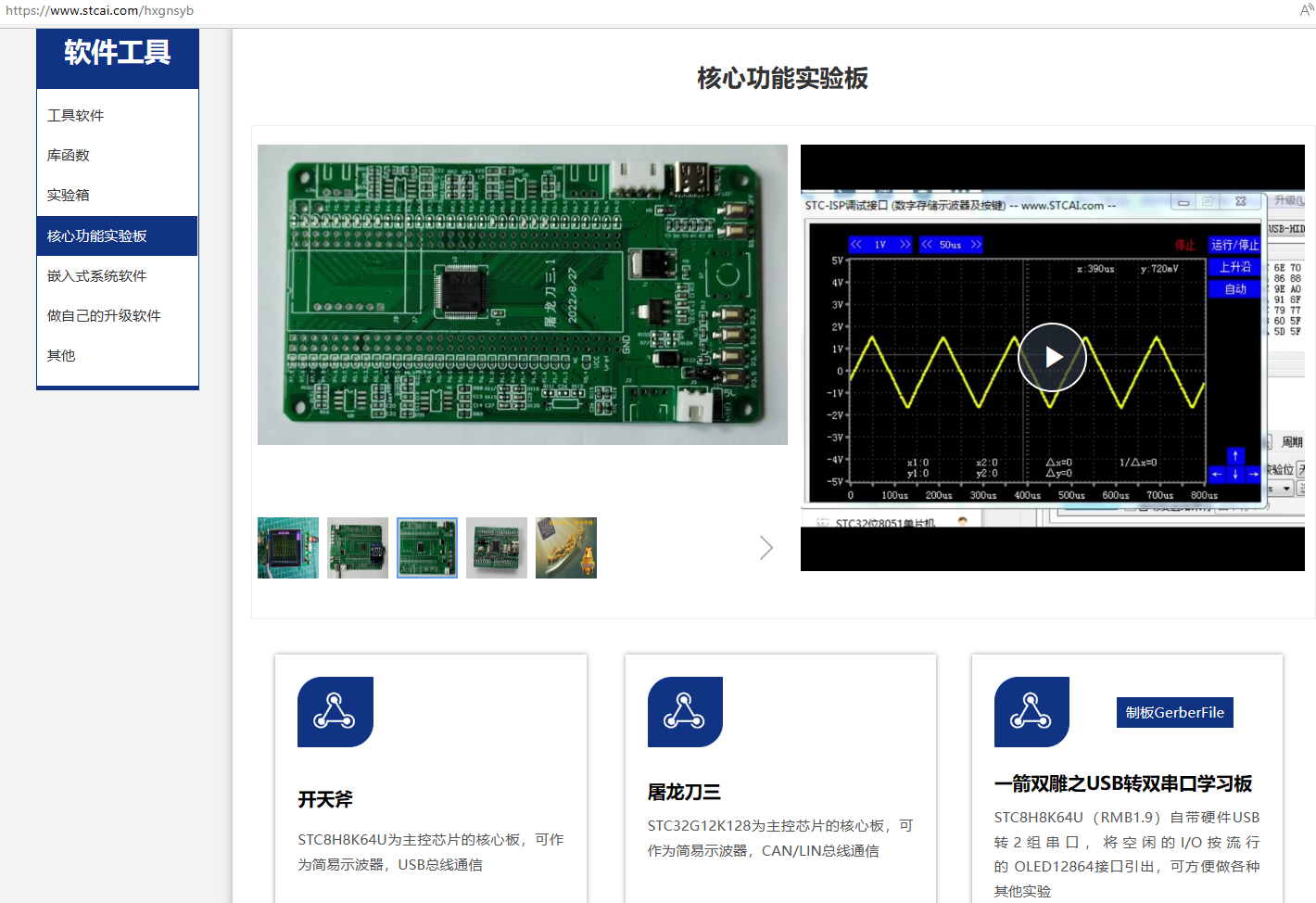

深圳国芯人工智能有限公司-核心功能实验板 (stcai.com)
感谢了!

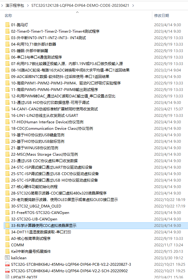

wr*** 发表于 2023-5-2 20:26
谢谢您!我在发送区, 文本发送:37H 53H 45H 47H 4CH 00H 10H 00H 12H 34H 56H 78H
数码管没反应是什么 ...
//虚拟数码管显示
        SBUF = 0x37;B_TX1_Busy = 1;        while(B_TX1_Busy);
        SBUF = 0x53;B_TX1_Busy = 1;        while(B_TX1_Busy);
        SBUF = 0x45;B_TX1_Busy = 1;        while(B_TX1_Busy);
        SBUF = 0x47;B_TX1_Busy = 1;        while(B_TX1_Busy);
        SBUF = 0x00;B_TX1_Busy = 1;        while(B_TX1_Busy);
                SBUF = 0x31;B_TX1_Busy = 1;        while(B_TX1_Busy);
                SBUF = 0x33;B_TX1_Busy = 1;        while(B_TX1_Busy);
//虚拟数码管显示
