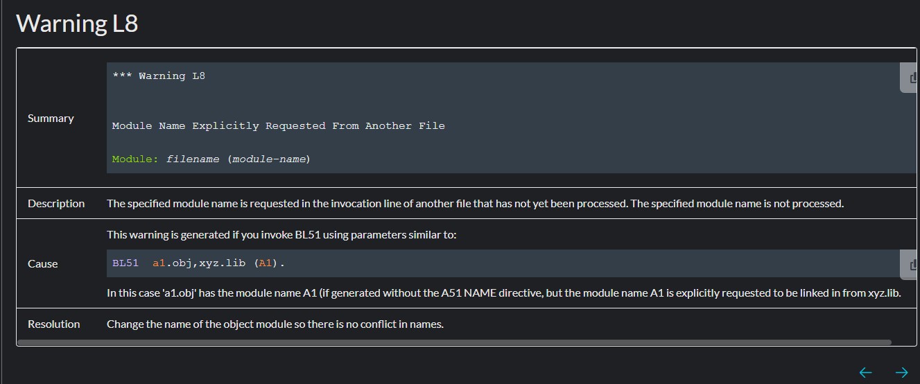

*** WARNING L8: MODULE NAME EXPLICITLY REQUESTED FROM ANOTHER FILE
    MODULE:  USB.obj (USB)
Program Size: data=8.3 xdata=238 const=0 code=4649
creating hex file from "USB"...
"USB" - 0 Error(s), 1 Warning(s).

Resolution        :Change the name of the object module so there is no conflict in names.
--修改代码文件名或者输出文件名
