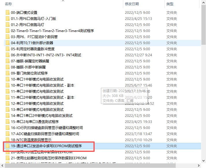

发表于 2025-9-30 11:17:33 | 显示全部楼层
/* --- STC MCU Limited ------------------------------------------------*/
/* --- STC 1T Series MCU Demo Programme -------------------------------*/
/* --- Mobile: (86)13922805190 ----------------------------------------*/
/* --- Fax: 86-0513-55012956,55012947,55012969 ------------------------*/
/* --- Tel: 86-0513-55012928,55012929,55012966 ------------------------*/

优先使用例程测试,注意型号间EEPROM大小差异
https://www.stcaimcu.com/data/do ... -DEMO-CODE-V9.6.zip

可以先使用实验箱例程测试一下
