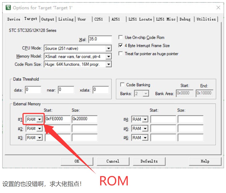

特意选了一个128的芯片,但超过64K之后,程序好像就报错了。

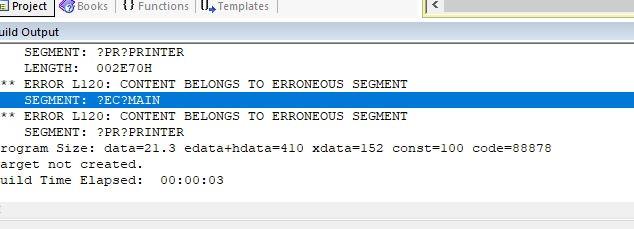

compiling lcd12232.c...
compiling printer.c...
compiling RTC+E2PROM.c...
linking...
*** WARNING L16: UNCALLED SEGMENT, IGNORED FOR OVERLAY PROCESS
*** ERROR L107: ADDRESS SPACE OVERFLOW
    SPACE:   ECODE
    SEGMENT: ?EC?MAIN
    LENGTH:  002F44H
    SPACE:   ECODE
    SEGMENT: ?PR?PRINTER
    LENGTH:  002E70H
*** ERROR L120: CONTENT BELONGS TO ERRONEOUS SEGMENT
    SEGMENT: ?EC?MAIN
Program Size: data=21.3 edata+hdata=410 xdata=152 const=100 code=88878
Target not created.
Build Time Elapsed:  00:00:03
设置的也没错啊,求大佬指点!

 楼主| 发表于 2025-8-9 17:52:13 | 显示全部楼层
收下我的膝盖,多谢大哥!
