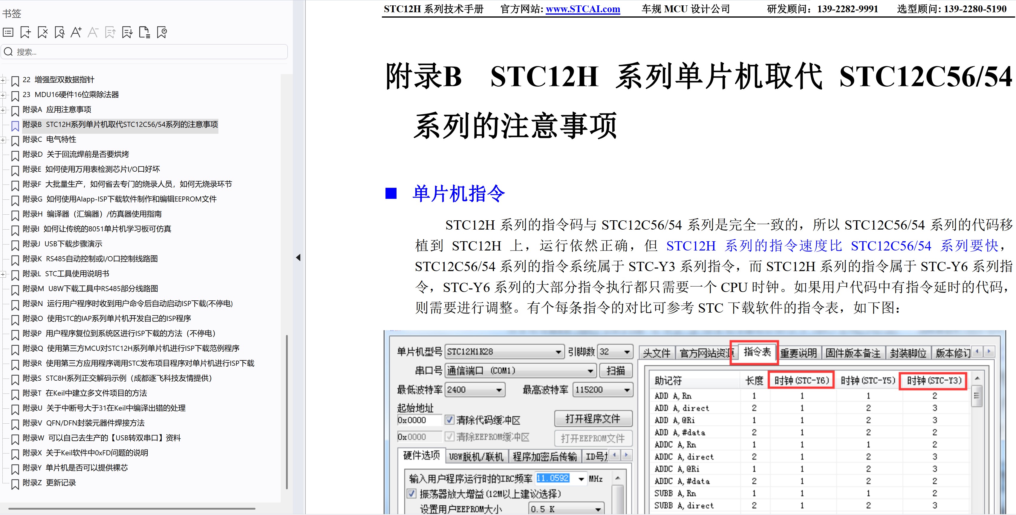

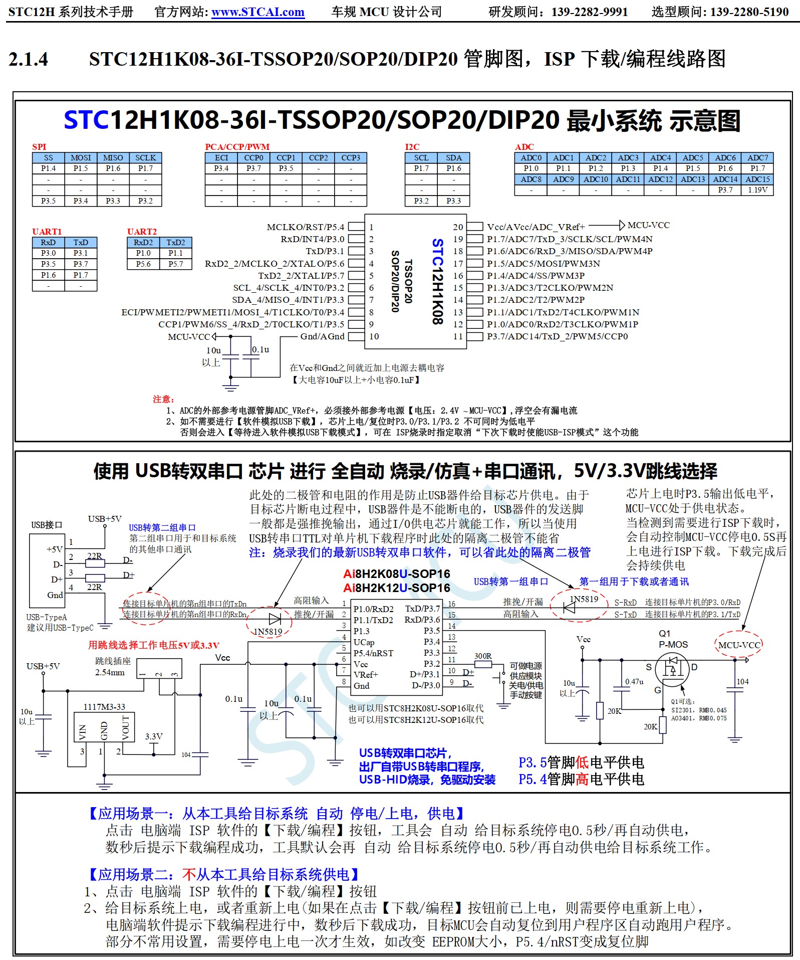

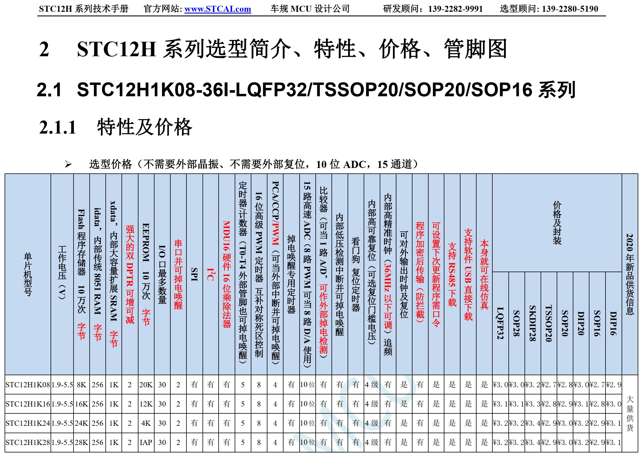

发表于 2025-6-28 18:05:06 | 显示全部楼层
STC12H1K16-36I-DIP20;
STC12H1K28-36I-DIP20;
https://www.stcaimcu.com/data/download/Datasheet/STC12H.pdf
