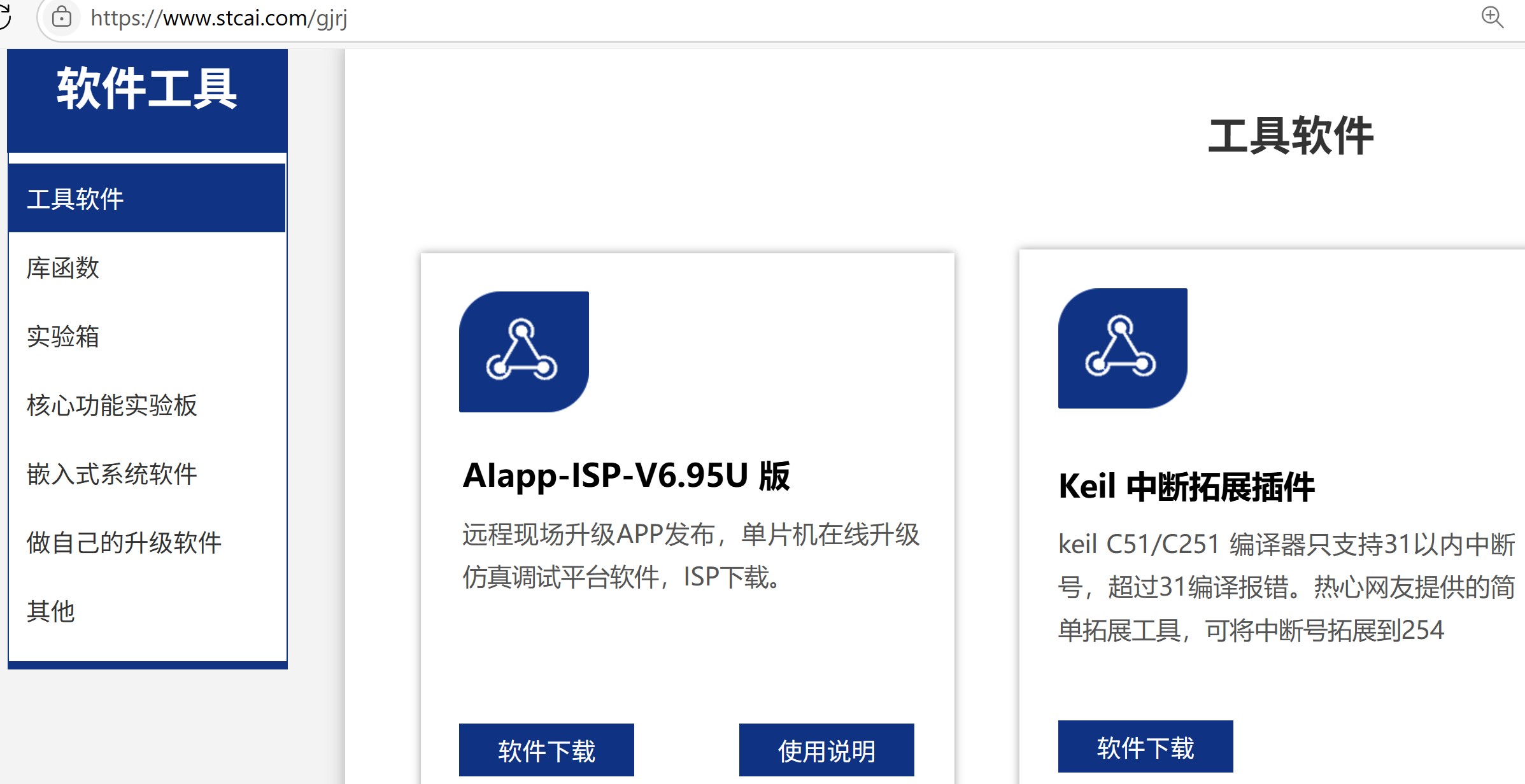

永远使用最新软件,才有最好的资源
深圳国芯人工智能有限公司-工具软件

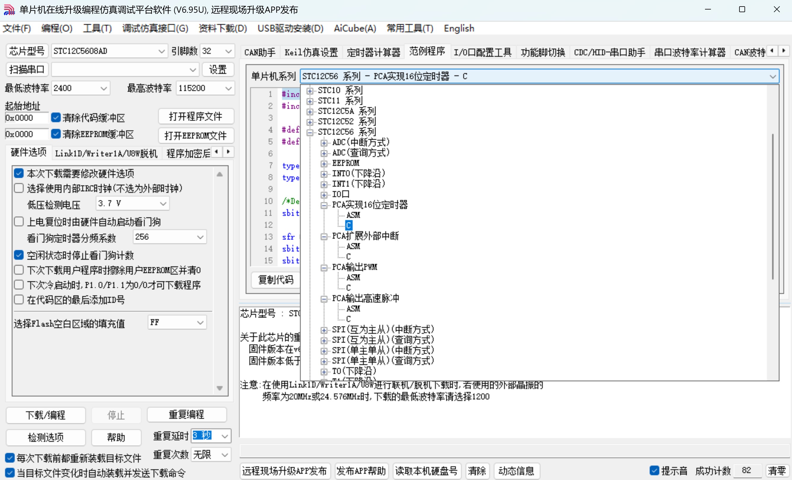

#include "reg51.h"
#include "intrins.h"
#define FOSC    11059200L
#define T100Hz  (FOSC / 12 / 100)
typedef unsigned char BYTE;
typedef unsigned int WORD;
/*Declare SFR associated with the PCA */
sbit EPCAI      =   IE^6;
sfr CCON        =   0xD8;           //PCA control register
sbit CCF0       =   CCON^0;         //PCA module-0 interrupt flag
sbit CCF1       =   CCON^1;         //PCA module-1 interrupt flag
sbit CR         =   CCON^6;         //PCA timer run control bit
sbit CF         =   CCON^7;         //PCA timer overflow flag
sfr CMOD        =   0xD9;           //PCA mode register
sfr CL          =   0xE9;           //PCA base timer LOW
sfr CH          =   0xF9;           //PCA base timer HIGH
sfr CCAPM0      =   0xDA;           //PCA module-0 mode register
sfr CCAP0L      =   0xEA;           //PCA module-0 capture register LOW
sfr CCAP0H      =   0xFA;           //PCA module-0 capture register HIGH
sfr CCAPM1      =   0xDB;           //PCA module-1 mode register
sfr CCAP1L      =   0xEB;           //PCA module-1 capture register LOW
sfr CCAP1H      =   0xFB;           //PCA module-1 capture register HIGH
sfr CCAPM2      =   0xDC;           //PCA module-2 mode register
sfr CCAP2L      =   0xEC;           //PCA module-2 capture register LOW
sfr CCAP2H      =   0xFC;           //PCA module-2 capture register HIGH
sfr CCAPM3      =   0xDD;           //PCA module-3 mode register
sfr CCAP3L      =   0xED;           //PCA module-3 capture register LOW
sfr CCAP3H      =   0xFD;           //PCA module-3 capture register HIGH
sbit PCA_LED    =   P1^0;           //PCA test LED
BYTE cnt;
WORD value;
void PCA_isr() interrupt 6
    CCF0 = 0;                       //Clear interrupt flag
    CCAP0L = value;
    CCAP0H = value >> 8;            //Update compare value
    value += T100Hz;
    if (cnt-- == 0)
        cnt = 100;                  //Count 100 times
        PCA_LED = !PCA_LED;         //Flash once per second
void main()
    CCON = 0;                       //Initial PCA control register
                                    //PCA timer stop running
                                    //Clear CF flag
                                    //Clear all module interrupt flag
    CL = 0;                         //Reset PCA base timer
    CH = 0;
    CMOD = 0x00;                    //Set PCA timer clock source as Fosc/12
                                    //Disable PCA timer overflow interrupt
    value = T100Hz;
    CCAP0L = value;
    CCAP0H = value >> 8;            //Initial PCA module-0
    value += T100Hz;
    CCAPM0 = 0x49;                  //PCA module-0 work in 16-bit timer mode and enable PCA interrupt
    CR = 1;                         //PCA timer start run
    EPCAI = 1;
    EA = 1;
    cnt = 0;
    while (1);

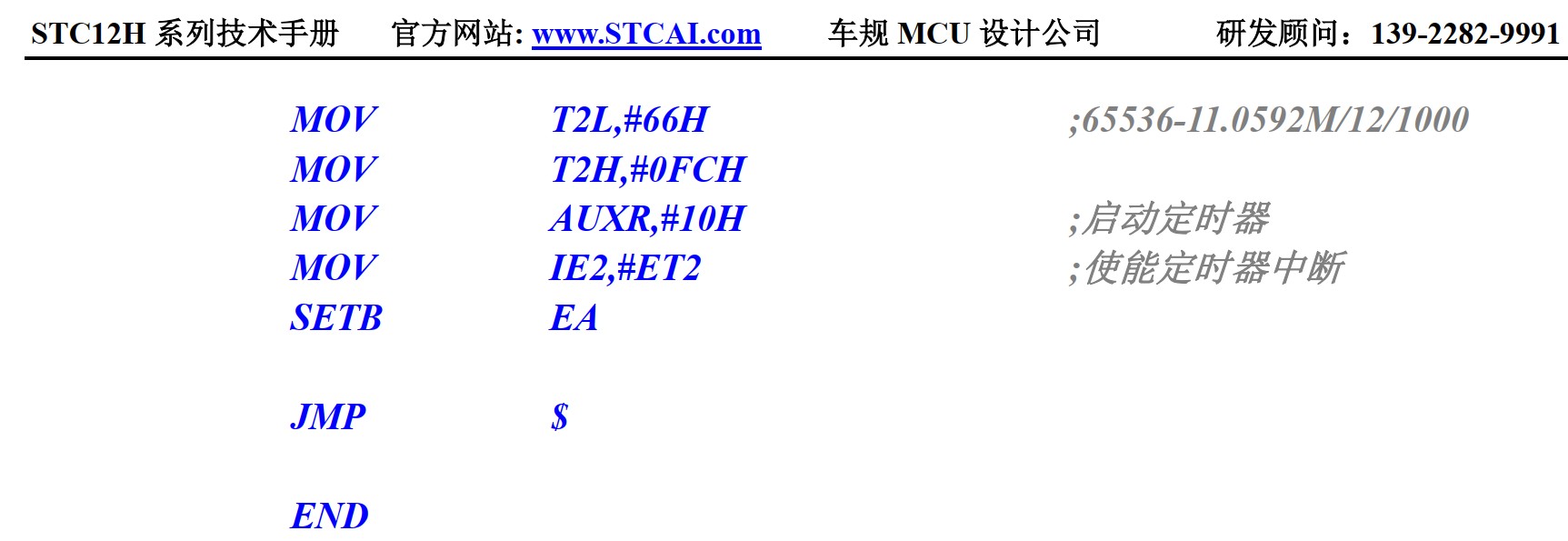

https://www.stcaimcu.com/data/download/Datasheet/STC12H.pdf
可以使用管脚兼容的 STC12H1K16 来代替 STC12C5608AD系列
STC12H1K16的定时器 T0/T1/T2/T3/T4比较强大
