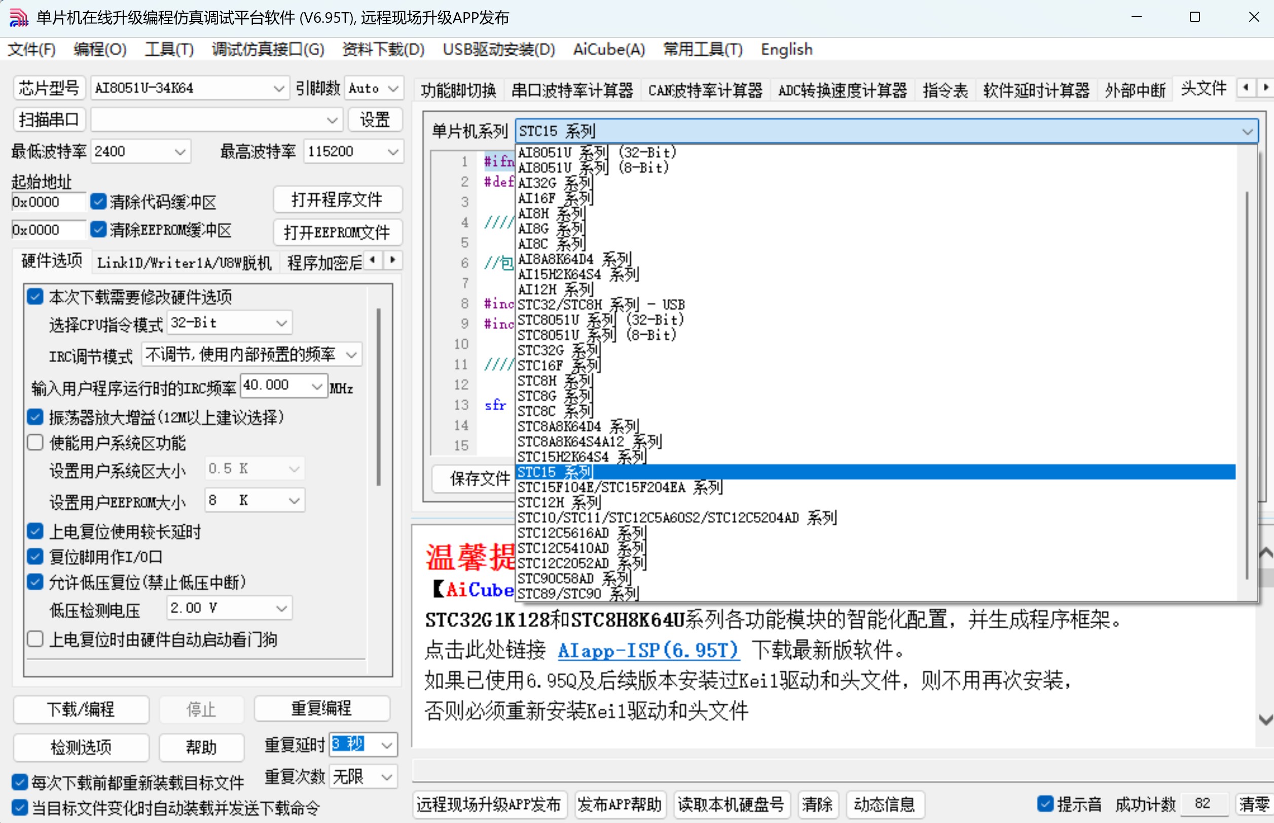

发表于 2025-6-4 11:28:52 | 显示全部楼层
sfr         P5          =           0xC8;
    sbit    P50         =           P5^0;
    sbit    P51         =           P5^1;
    sbit    P52         =           P5^2;
    sbit    P53         =           P5^3;
    sbit    P54         =           P5^4;
    sbit    P55         =           P5^5;
    sbit    P56         =           P5^6;
    sbit    P57         =           P5^7;
#ifndef __STC15_H__
#define __STC15_H__
//包含本头文件后,不用另外再包含"REG51.H"
#include "stdio.h"
#include "intrins.h"
