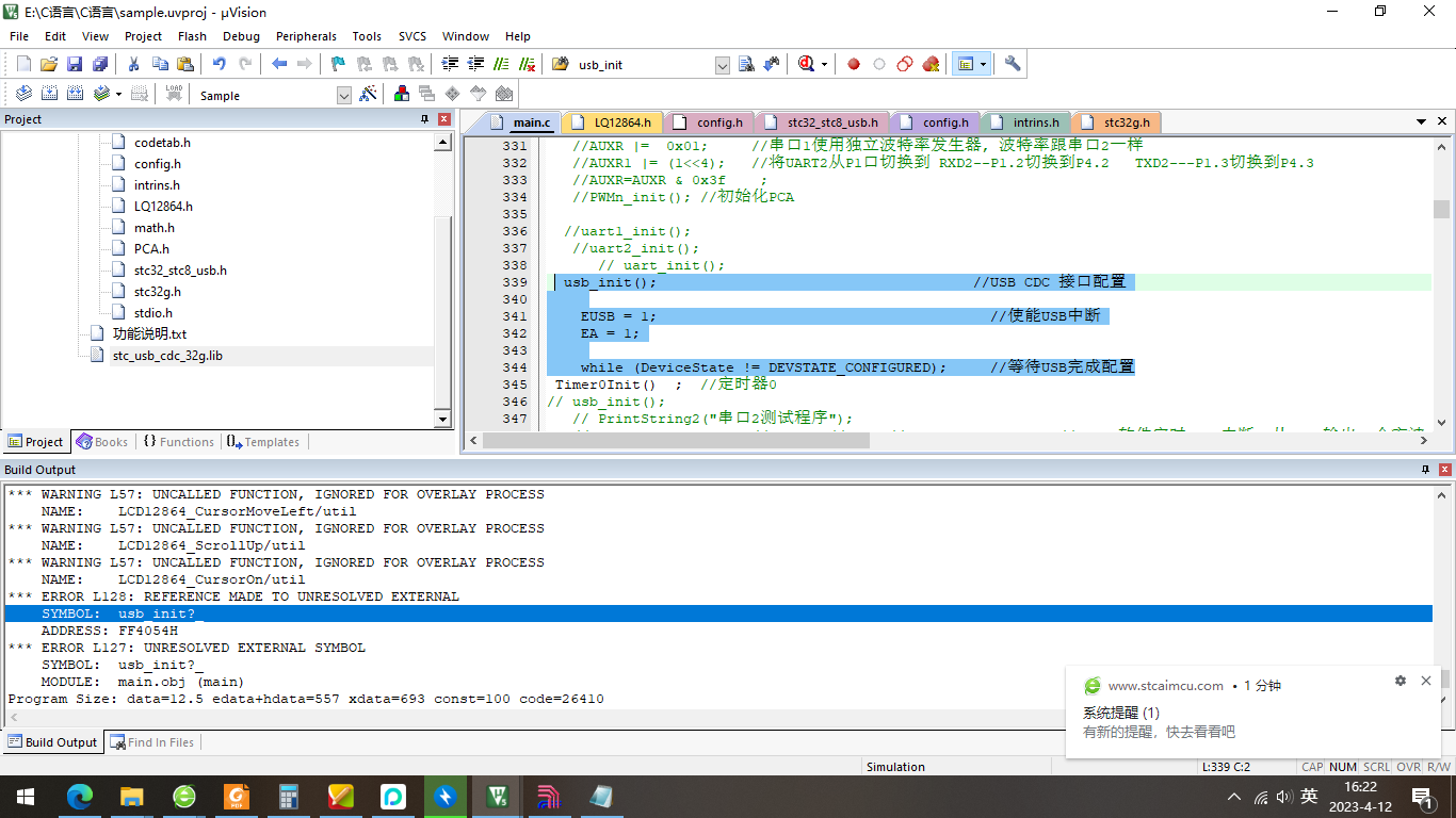

usb_init();                                     //USB CDC 接口配置
    EUSB = 1;                                       //使能USB中断
    EA = 1;
    while (DeviceState != DEVSTATE_CONFIGURED);     //等待USB完成配置
*** WARNING L57: UNCALLED FUNCTION, IGNORED FOR OVERLAY PROCESS
*** ERROR L128: REFERENCE MADE TO UNRESOLVED EXTERNAL
    SYMBOL:  usb_init?_
    ADDRESS: FF4054H
*** ERROR L127: UNRESOLVED EXTERNAL SYMBOL
    SYMBOL:  usb_init?_
    MODULE:  main.obj (main)
Program Size: data=12.5 edata+hdata=557 xdata=693 const=100 code=26410
Target not created.

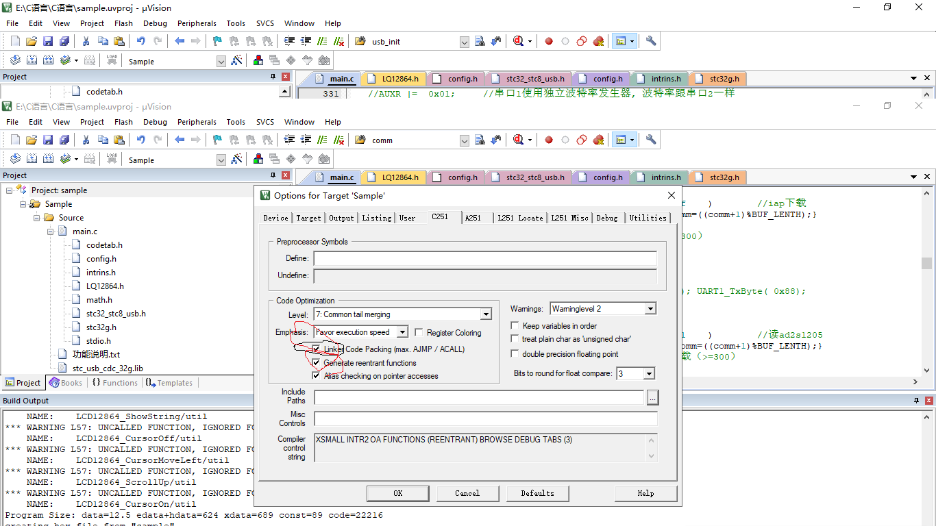

发表于 2023-4-12 23:16:56 | 显示全部楼层
将红色的勾选取消  ok了
