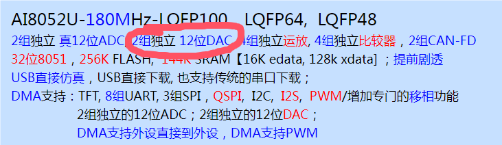

官方预告里只说了有两组独立12位内置DAC,并没有说最大速度是多少,有知道的吗?

AI8052U 内置的 2组独立 DAC 是 1M 的速度
7月芯片回来测试后,送样

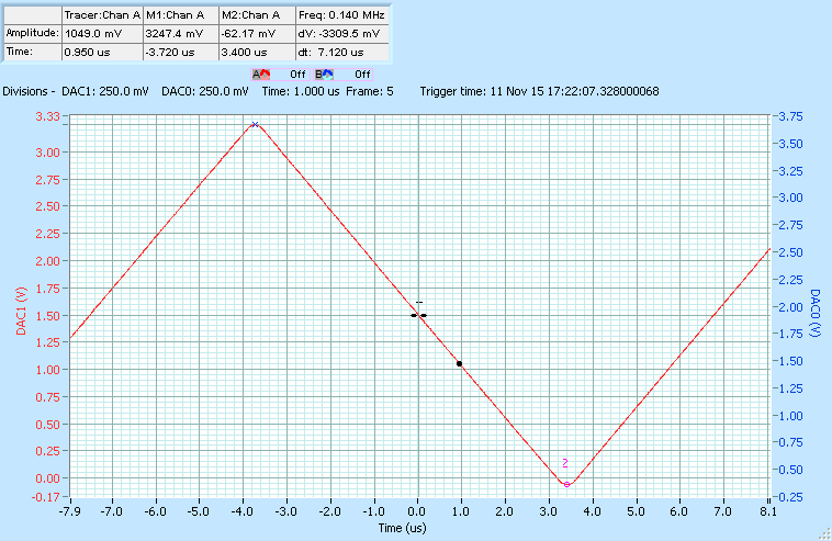

发表于 2025-5-4 16:43:17 | 显示全部楼层
Shennong Ding published on 2025-5-4 11:44
AI8052U has two sets of independent DACs built in at a speed of 1M.
After the chip is tested in July, samples will be sent.
What is the AI8051U slew rate = ?? V/us ?  DMA update rate ? MHz
In DAC on EFM8LB1 this is possible, which updates DAC0 at 36MHz rate, but this only makes small changes each time so this is within the slew rate of the part
Data: DAC Slew Rate SLEW ±1 V/μs   DAC Output Settling Time to 1% (25%->75%) Full Scale 2.6μs
INC DACH0  ;36MHz DAC feed rate (small steps of 0.39%)
INC DACH0
INC DACH0
INC DACH0
...x200
INC DACH0
INC DACH0
INC DACH0
DEC DACH0
DEC DACH0
DEC DACH0
...x200
DEC DACH0
DEC DACH0
DEC DACH0
AJMP Loop
and the scope result is a clean sawtooth, with a slope of 256/(72M/2) = 7.111us or a slew rate of 0.464V/us.
The slew rate here is what determines what is possible, not the spec update rate.
Can the Ai8052U support similar code?
