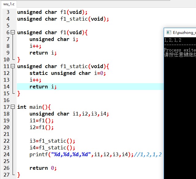

rt!真是见鬼了。i2居然是2!
程序如下
  1. #include "stdio.h"
  2. unsigned char f1(void);
  3. unsigned char f1_static(void);
  4. unsigned char f1(void){
  5.         unsigned char i;
  6.         i++;
  7.         return i;
  8. }
  9. unsigned char f1_static(void){
  10.         static unsigned char i=0;
  11.         i++;
  12.         return i;
  13. }
  14. int main(){
  15.         unsigned char i1,i2,i3,i4;
  16.         i1=f1();
  17.         i2=f1();
  18.         i3=f1_static();
  19.         i4=f1_static();
  20.         printf("%d,%d,%d,%d",i1,i2,i3,i4);//1,2,1,2
  21.
  22.         return 0;
  23. }

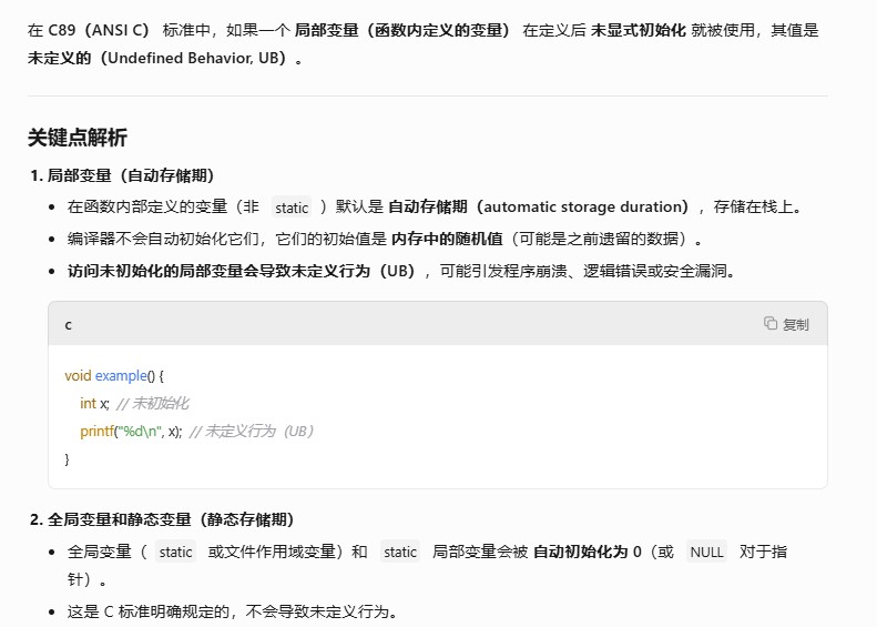

发表于 2025-4-22 20:52:46 | 显示全部楼层
1 喜欢他/她就送朵鲜花吧,赠人玫瑰,手有余香!

发表于 2025-4-23 10:06:55 | 显示全部楼层
感谢两位指点。确实是忘记初始化变量了。。。。
