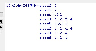

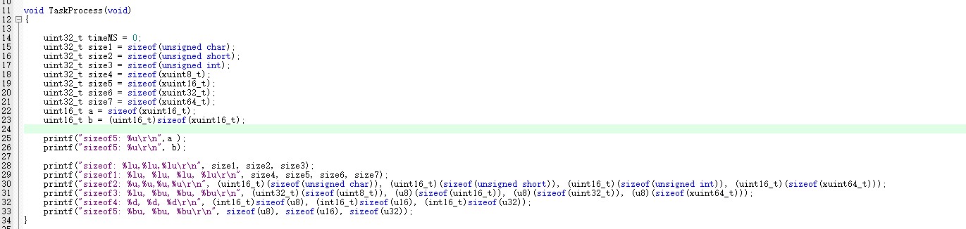

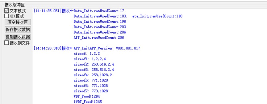

 楼主| 发表于 2025-4-17 14:26:44 | 显示全部楼层
芯片型号:STC15F2K60S2
编译工具为:keil
程序下载工具为
3085
7234
7234

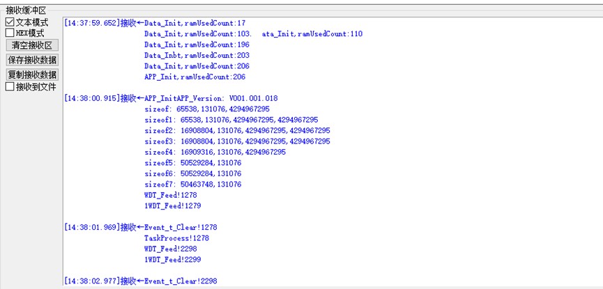

发表于 2025-4-17 14:35:07 | 显示全部楼层
%lu
3085
7234
7234
发表于 2025-4-17 14:36:05 | 显示全部楼层
关注一下 printf的用法

 楼主| 发表于 2025-4-17 14:39:00 | 显示全部楼层
改为%lu

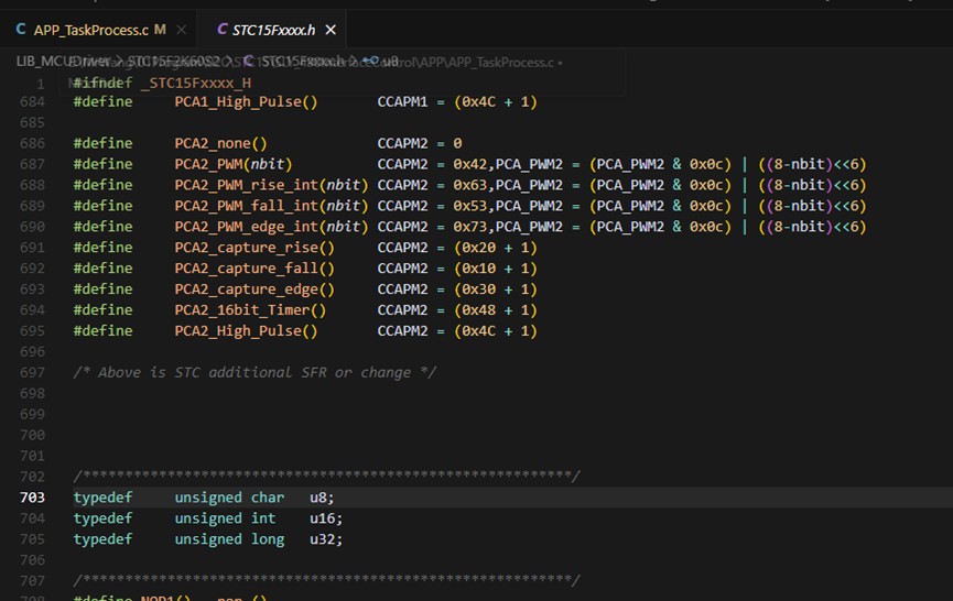

发表于 2025-4-17 15:07:29 | 显示全部楼层
char:8bit
int:16bit
long:32bit
47
144
144

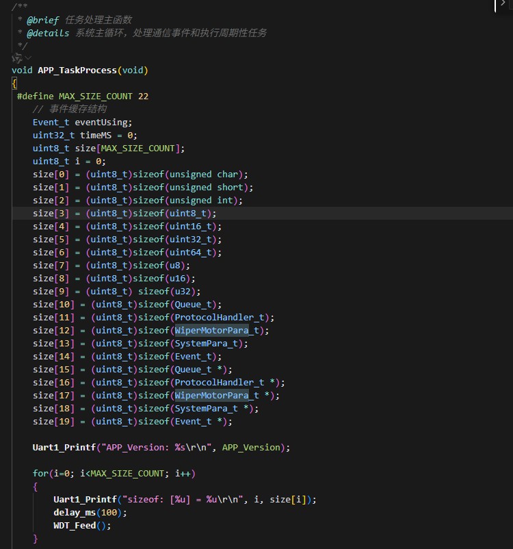

 楼主| 发表于 2025-4-17 15:46:37 | 显示全部楼层
[15:45:14.203]接收←Data_Init,Data_Init,ramUsedCount:103
                    Data_Init,ramUsedCount:110
                    Data_Init,ramUsedCount:196
                    Data_Init,ramUsedCount:203
                    Data_Init,ramUsedCount:206
                    APP_Init,ramUsedCount:206
[15:45:15.451]接收←APP_InitAPP_Version: V001.001.022
                    sizeof: [1] = 53777
[15:45:15.556]接收←sizeof: [258] = 53777
[15:45:15.662]接收←sizeof: [514] = 53777
[15:45:15.768]接收←sizeof: [769] = 53777
[15:45:15.873]接收←sizeof: [1026] = 53777
[15:45:15.978]接收←sizeof: [1282] = 53777
[15:45:16.068]接收←sizeof: [1540] = 53777
[15:45:16.174]接收←sizeof: [1793] = 53777
[15:45:16.280]接收←sizeof: [2050] = 53777
[15:45:16.387]接收←sizeof: [2308] = 53777
[15:45:16.493]接收←sizeof: [2571] = 53777
[15:45:16.583]接收←sizeof: [2823] = 53777
[15:45:16.689]接收←sizeof: [3075] = 53777
[15:45:16.796]接收←sizeof: [3345] = 53777
[15:45:16.901]接收←sizeof: [3599] = 53777
[15:45:17.006]接收←sizeof: [3843] = 53777
[15:45:17.097]接收←sizeof: [4099] = 53777
[15:45:17.202]接收←sizeof: [4355] = 53777
[15:45:17.308]接收←sizeof: [4611] = 53777
[15:45:17.414]接收←sizeof: [4867] = 53777
[15:45:17.519]接收←sizeof: [5170] = 53777
[15:45:17.609]接收←sizeof: [5525] = 53777
123
5133
11465

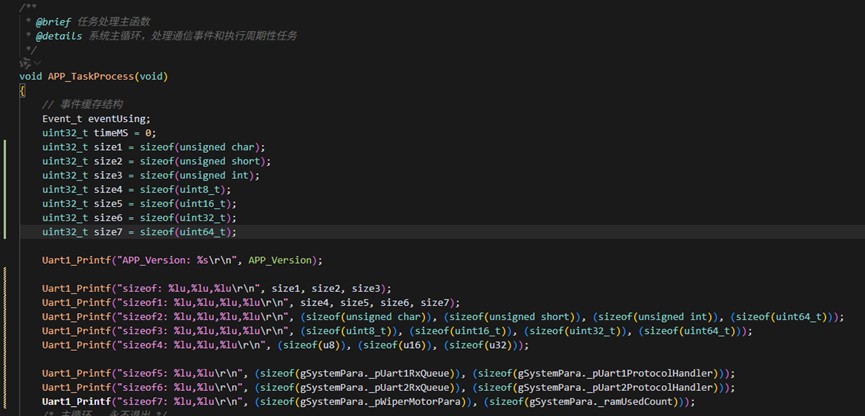

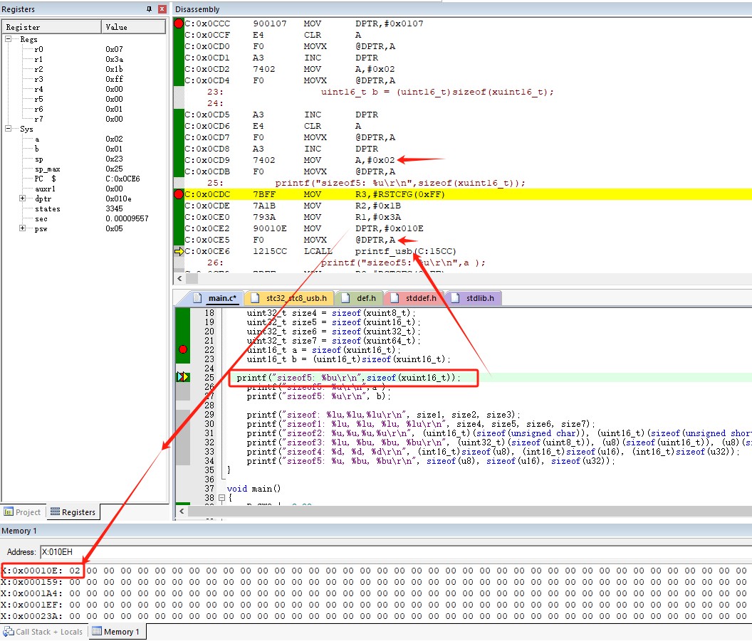

发表于 2025-4-17 15:53:13 | 显示全部楼层
通过你上一个帖子分析你用的是keilC51环境
%bu是C51打印u8的特殊格式
123
5133
11465
发表于 2025-4-17 16:03:23 | 显示全部楼层
如果直接打印sizeof,观察汇编发现,待打印数02直接放在了0x010E地址第一字节,所以也要用u8打印。
