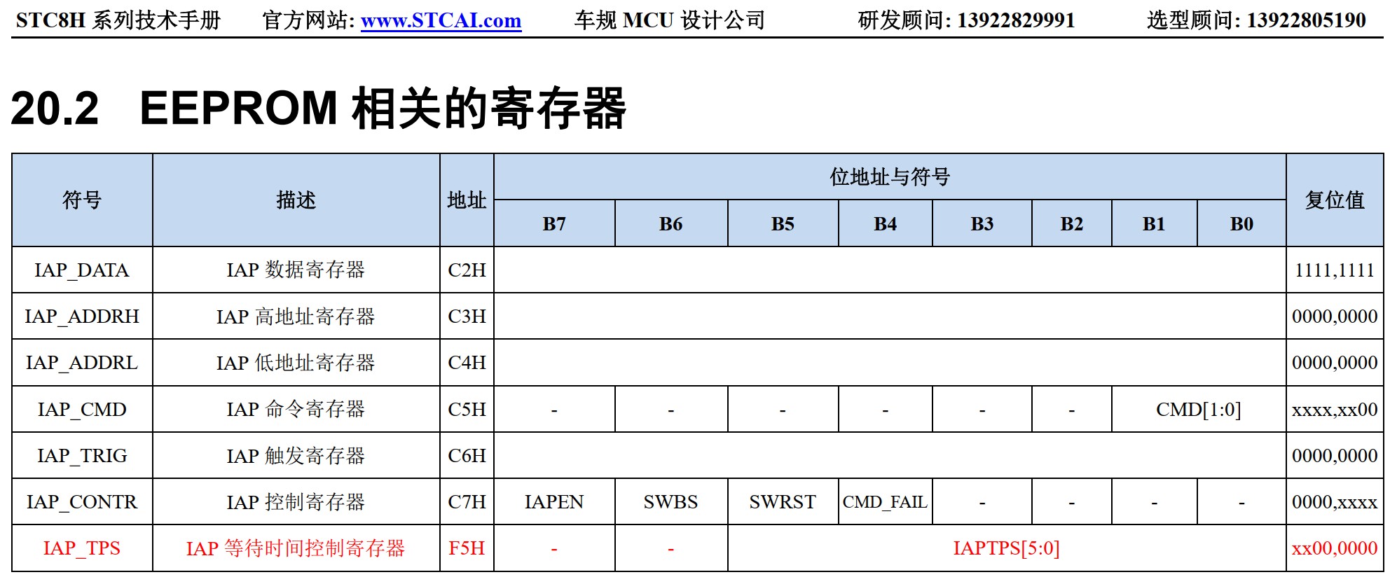

烧录时要设置 EEPROM 的大小,这样可以确定 EEPROM的 最大有效地址
跟据烧录时选择的频率,要设置等待参数
如图,IAP_TPS 要改成 24

目前我用的11.052Mhz的,所以我IAP_TPS选择的是12.
#define     EE_ADDRESS  0x0000
#define     EE_ADDRESS_C_1 0x0200
void EEPROM_SectorErase(u16 EE_address)
    EA = 0;
    IAP_CONTR = 0x80;
    IAP_TPS   = 12;               12MHz
    IAP_CMD   = 3;
    IAP_ADDRH = EE_address / 256;
    IAP_ADDRL = EE_address % 256;
    IAP_TRIG  = 0x5a;
    IAP_TRIG  = 0xa5;
    _nop_();
    DisableEEPROM();
    EA = 1;
void DisableEEPROM(void)
    IAP_CONTR = 0;    // 锟截憋拷 IAP 锟斤拷锟斤拷
    IAP_CMD   = 0;    // 锟斤拷锟斤拷锟斤拷锟侥达拷锟斤拷
    IAP_TRIG  = 0;    // 锟斤拷锟斤拷锟斤拷锟斤拷拇锟斤拷锟?1锟?71锟?1锟?77
    IAP_ADDRH = 0x80; // 锟斤拷锟斤拷址锟斤拷锟矫碉拷锟斤拷 IAP 锟斤拷锟斤拷
    IAP_ADDRL = 0;
我去执行
EEPROM_SectorErase(EE_ADDRESS_C_1);
EEPROM_write_n(EE_ADDRESS_C_1, pBuf, 10);        // Current Status
会将EE_ADDRESS  里的PID也擦除变成FF   FF
