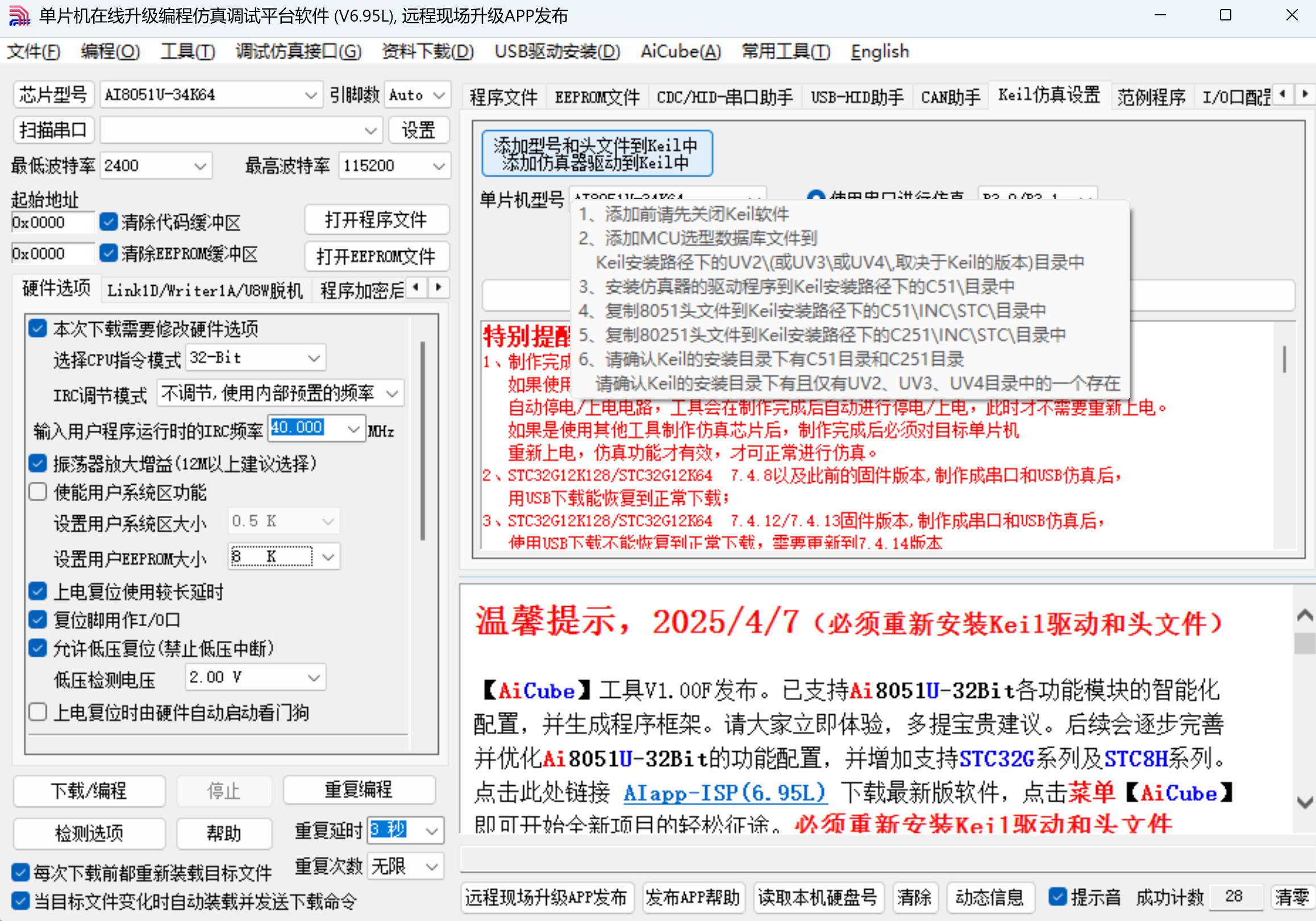

请问是编译器原因还是什么原因。
编译器也是对着设置了 头文件也用isp软件添加了,搞了好久。
编译器是新装C251。请大师们解答 谢谢!

 楼主| 发表于 2025-4-7 20:02:20 来自手机 | 显示全部楼层
jwd 发表于 2025-4-7 19:54
你需要看看是啥报警
正常生成的项目不应该是包含所有东西了吗,头文件也添加了,下面是错误:Rebuild target 'gaodu2'
compiling main.c...
Sources\main.c(18): warning C140: 'SYS_Init' undefined; assuming 'extern int SYS_Init()'
Sources\main.c(31): error C53: redefinition of 'SYS_Init': different return types
Sources\main.c(32): warning C140: 'EnableAccessXFR' undefined; assuming 'extern int EnableAccessXFR()'
Sources\main.c(33): warning C140: 'AccessCodeFastest' undefined; assuming 'extern int AccessCodeFastest()'
Sources\main.c(34): warning C140: 'AccessIXramFastest' undefined; assuming 'extern int AccessIXramFastest()'
Sources\main.c(35): warning C140: 'IAP_SetTimeBase' undefined; assuming 'extern int IAP_SetTimeBase()'
Sources\main.c(46): warning C140: 'CLK_Init' undefined; assuming 'extern int CLK_Init()'
Sources\main.c(47): warning C140: 'UART1_Init' undefined; assuming 'extern int UART1_Init()'
Sources\main.c(55): error C25: syntax error near 'ms'
Sources\main.c(56): warning C35: 'delay_ms': uses old-style declarator
Sources\main.c(57): error C25: syntax error near 'i'
Sources\main.c(57): warning C34: 'i': missing declaration specifiers
Sources\main.c(59): error C25: syntax error near 'do'
Sources\main.c(61): error C53: redefinition of 'i'
Sources\main.c(62): error C25: syntax error near 'while'
Sources\main.c(62): error C25: syntax error near '--'
Sources\main.c(62): error C25: syntax error near ')'
Sources\main.c(63): error C25: syntax error near '--'
Sources\main.c(63): error C25: syntax error near ')'
Target not created.
Build Time Elapsed:  00:00:00

发表于 2025-4-8 00:47:34 | 显示全部楼层
这个是头文件缺失问题,这个软件就发布当天就说了STC要手动重新添加到KEIL,
cube软件需要头文件是重构名的,有部分头文件是放在KEIL软件文件中
