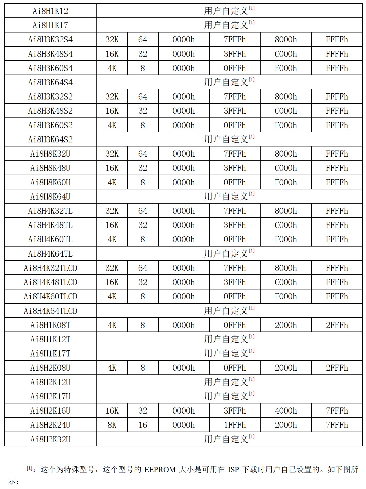

AI8H2K08U的 DATA-FLASH/EEPROM 的 IAP 擦除/写的地址是
从 0000H ~ 0FFFH
无 4000H地址

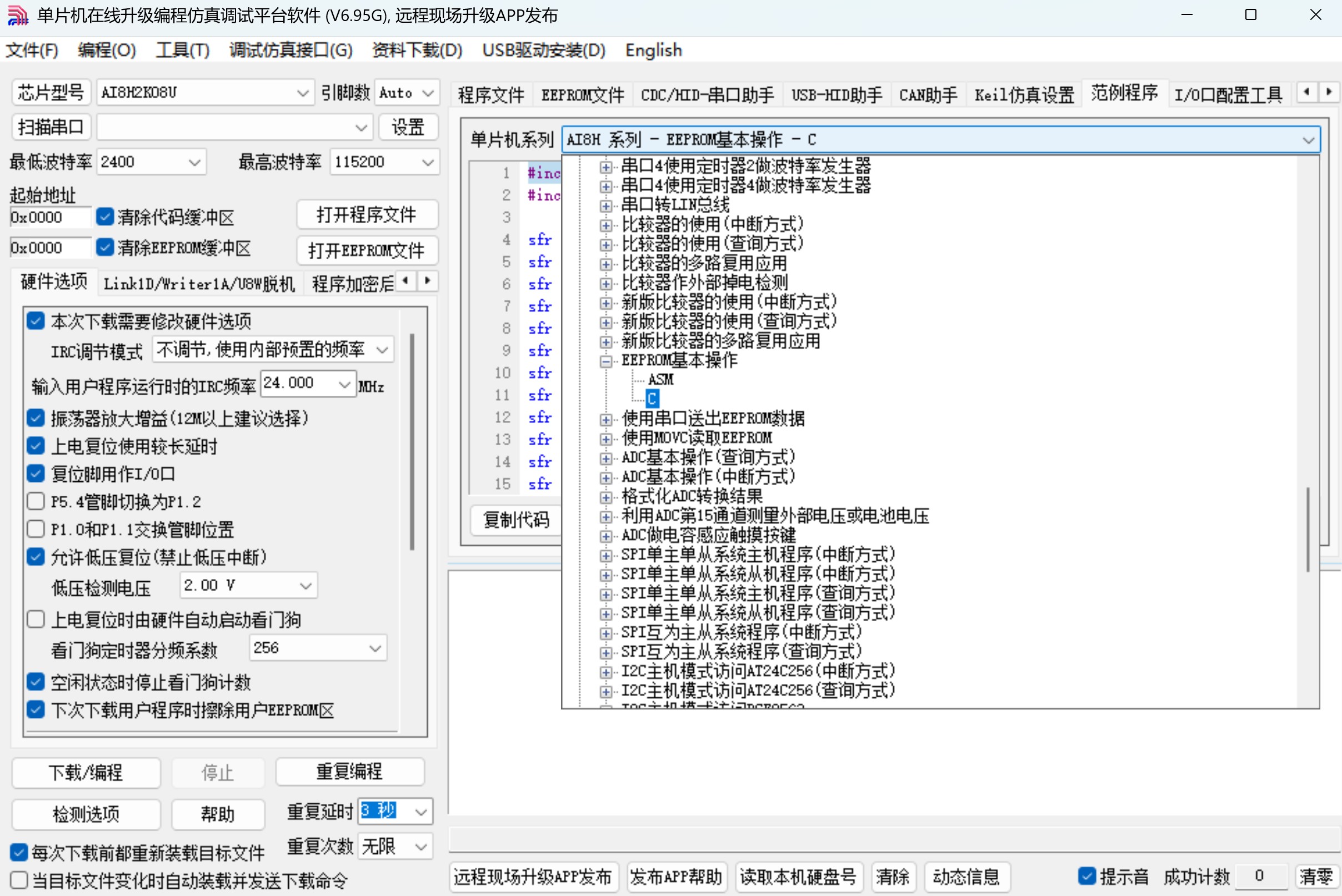

#include "reg51.h"
#include "intrins.h"
sfr     P0M1    =   0x93;
sfr     P0M0    =   0x94;
sfr     P1M1    =   0x91;
sfr     P1M0    =   0x92;
sfr     P2M1    =   0x95;
sfr     P2M0    =   0x96;
sfr     P3M1    =   0xb1;
sfr     P3M0    =   0xb2;
sfr     P4M1    =   0xb3;
sfr     P4M0    =   0xb4;
sfr     P5M1    =   0xc9;
sfr     P5M0    =   0xca;
sfr     IAP_DATA    =   0xC2;
sfr     IAP_ADDRH   =   0xC3;
sfr     IAP_ADDRL   =   0xC4;
sfr     IAP_CMD     =   0xC5;
sfr     IAP_TRIG    =   0xC6;
sfr     IAP_CONTR   =   0xC7;
sfr     IAP_TPS     =   0xF5;
void IapIdle()
    IAP_CONTR = 0;                              //关闭IAP功能
    IAP_CMD = 0;                                //清除命令寄存器
    IAP_TRIG = 0;                               //清除触发寄存器
    IAP_ADDRH = 0x80;                           //将地址设置到非IAP区域
    IAP_ADDRL = 0;
char IapRead(int addr)
    char dat;
    IAP_CONTR = 0x80;                           //使能IAP

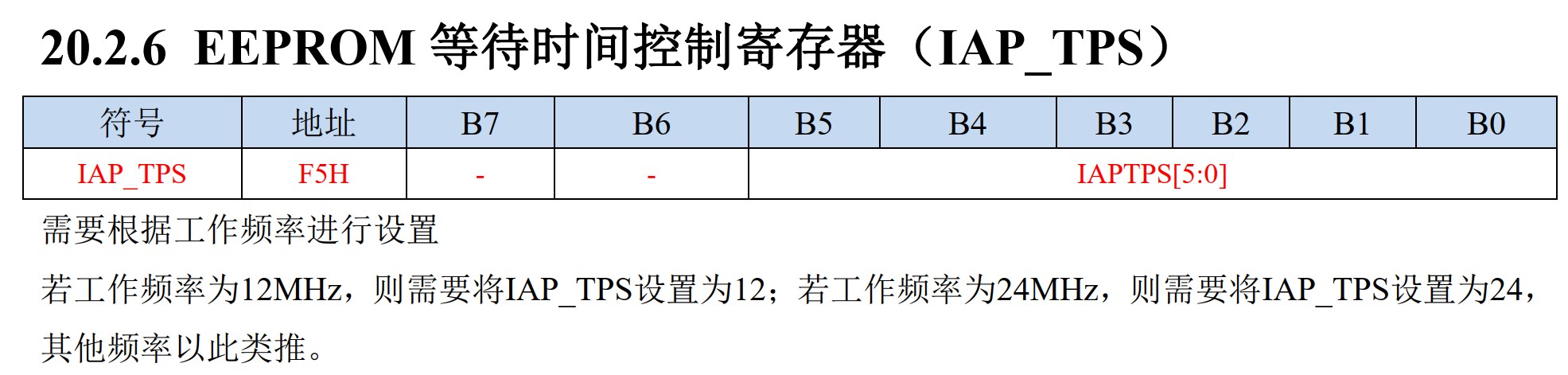

    IAP_TPS = 12;                               //设置等待参数12MHz
    IAP_CMD = 1;                                //设置IAP读命令
    IAP_ADDRL = addr;                           //设置IAP低地址
    IAP_ADDRH = addr >> 8;                      //设置IAP高地址
    IAP_TRIG = 0x5a;                            //写触发命令(0x5a)
    IAP_TRIG = 0xa5;                            //写触发命令(0xa5)
    _nop_();
    dat = IAP_DATA;                             //读IAP数据
    IapIdle();                                  //关闭IAP功能
    return dat;
void IapProgram(int addr, char dat)
    IAP_CMD = 2;                                //设置IAP写命令
    IAP_DATA = dat;                             //写IAP数据
    _nop_();
void IapErase(int addr)
    IAP_CMD = 3;                                //设置IAP擦除命令
    _nop_();                                    //
void main()
    P0M0 = 0x00;
    P0M1 = 0x00;
    P1M0 = 0x00;
    P1M1 = 0x00;
    P2M0 = 0x00;
    P2M1 = 0x00;
    P3M0 = 0x00;
    P3M1 = 0x00;
    P4M0 = 0x00;
    P4M1 = 0x00;
    P5M0 = 0x00;
    P5M1 = 0x00;
    IapErase(0x0400);
    P0 = IapRead(0x0400);                       //P0=0xff
    IapProgram(0x0400, 0x12);
    P1 = IapRead(0x0400);                       //P1=0x12
    while (1);
