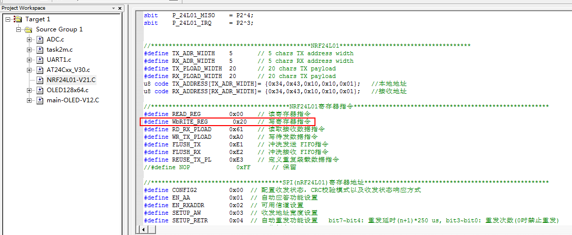

发表于 2023-3-30 15:12:37 | 显示全部楼层 |阅读模式
Build started: Project: remote
Build target 'Target 1'
compiling task2m.c...
config.h(23): warning C318: can't open file 'binary.h'
TASK2M.C(102): error C202: 'B1110_0000': undefined identifier
TASK2M.C(103): error C202: 'B0000_1110': undefined identifier
TASK2M.C(119): error C202: 'B1110_0000': undefined identifier
TASK2M.C(120): error C202: 'B0000_1110': undefined identifier
compiling NRF24L01-V21.C...
NRF24L01-V21.C(96): error C202: 'WRITE_REG': undefined identifier
NRF24L01-V21.C(97): error C202: 'WRITE_REG': undefined identifier
NRF24L01-V21.C(98): error C202: 'WRITE_REG': undefined identifier
NRF24L01-V21.C(99): error C202: 'WRITE_REG': undefined identifier
NRF24L01-V21.C(100): error C202: 'WRITE_REG': undefined identifier
NRF24L01-V21.C(101): error C202: 'WRITE_REG': undefined identifier
NRF24L01-V21.C(102): error C202: 'WRITE_REG': undefined identifier
NRF24L01-V21.C(103): error C202: 'WRITE_REG': undefined identifier
NRF24L01-V21.C(237): error C202: 'WRITE_REG': undefined identifier
compiling main-OLED-V12.C...
MAIN-OLED-V12.C(214): error C202: 'bit6': undefined identifier
MAIN-OLED-V12.C(259): error C187: not an lvalue
MAIN-OLED-V12.C(329): error C187: not an lvalue
MAIN-OLED-V12.C(422): error C202: 'bit6': undefined identifier
MAIN-OLED-V12.C(676): error C202: 'B0011_1011': undefined identifier
Target not created.
Build Time Elapsed:  00:00:00

整理文件时,手误,插入了一个b,去掉即可:
binary.h整理文件也删掉了,下载到目下即可。
我重新处理、编译后了,下载覆盖代替原来的压缩包,重新解压缩。
四轴飞控-STC32G12K128-LQFP48.rar (551.18 KB, 下载次数: 261)
